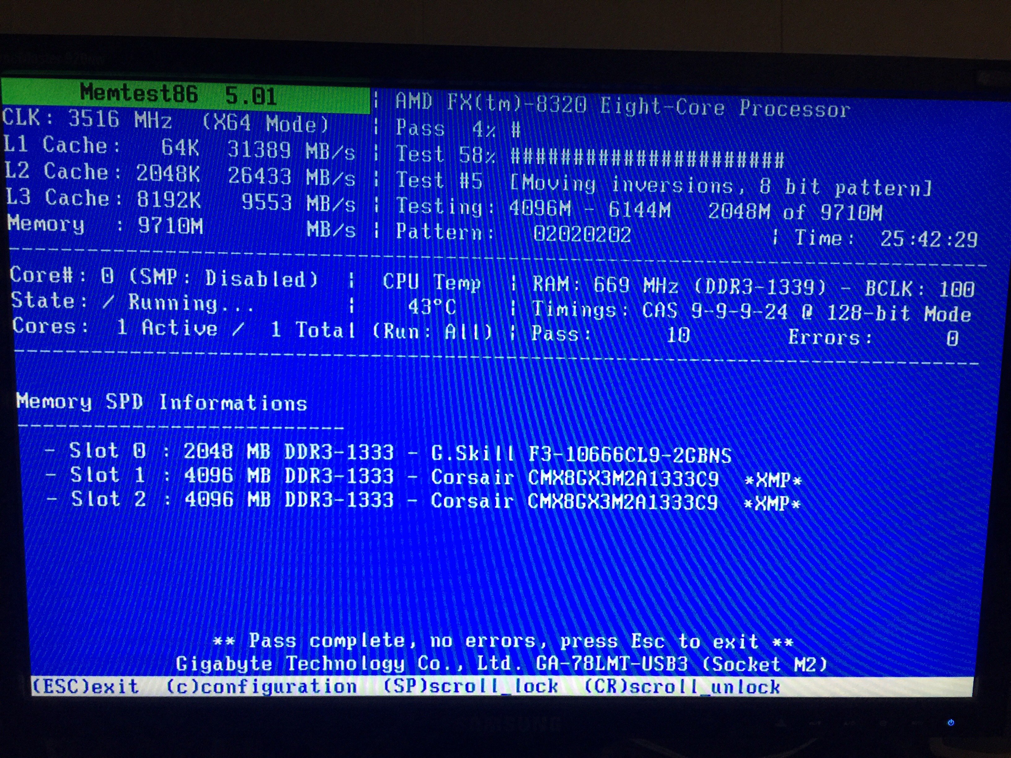

So I didn't have memtest in my boot menu, and had to add it back.  Not sure if I removed it, but whatever.  It is running now and has gone through one iteration and passed.  I am going to let it run at least through the night (7:57pm EDT here now) and see what we get in the morning.  If it still looks good I will keep letting it run until tomorrow evening to see what we get.  If all looks good, I will check SMART on the drives per the FAQ in the unRAID wiki, but I will continue to update this thread.

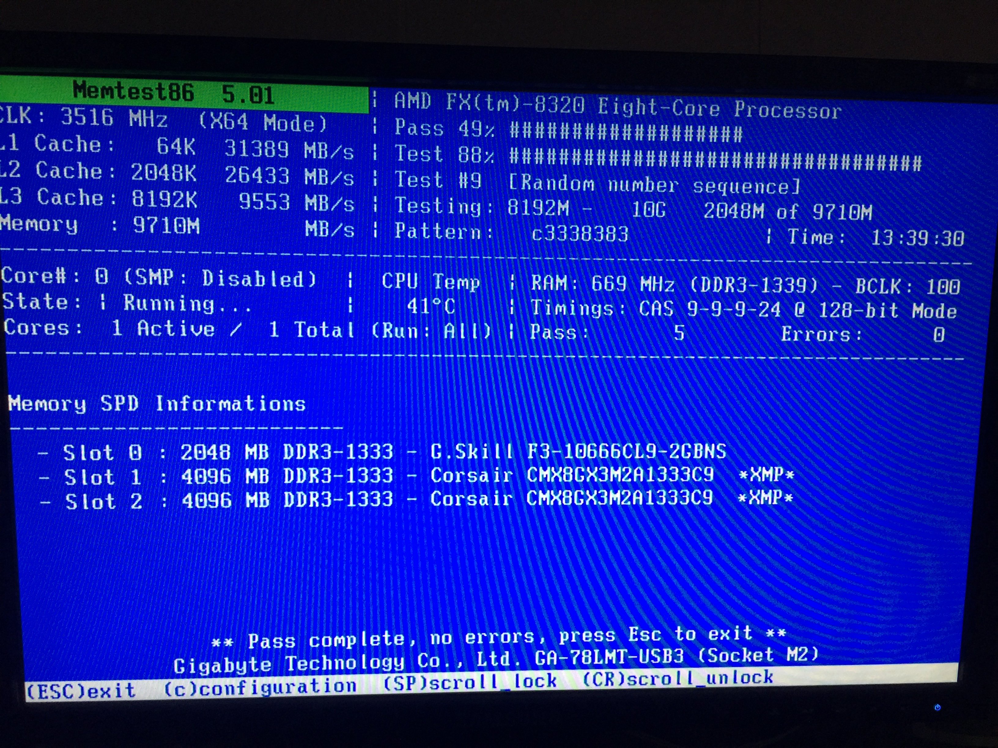

So this morning at 8:34am, the memtest was still running, which had been 13+ hours since I started it.  It had gone through 5 iterations of the test and there were no errors.  Attached is a screenshot of the memtest.  I am going to let it run until tonight so it will have gone for 24 hours.
So after 25+ hours, memtest has run 10 iterations and there are no errors.  It appears that the memory is okay, unless there are some other tests that need to be run with memtest.  Is it okay to stop the test or are there some other tests I could run through memtest?
