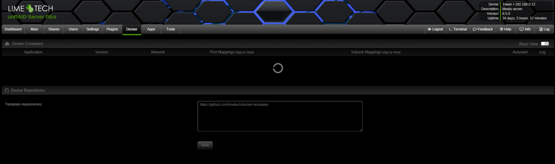

In need of some help, when I click on the docker tab it just sits in loading limbo forever which means I'm unable to update/edit my dockers. all dockers are working as normal.
only way of fixing is rebooting my server which is very annoying to have to do.
Below is a screenshot of what is sits on forever.

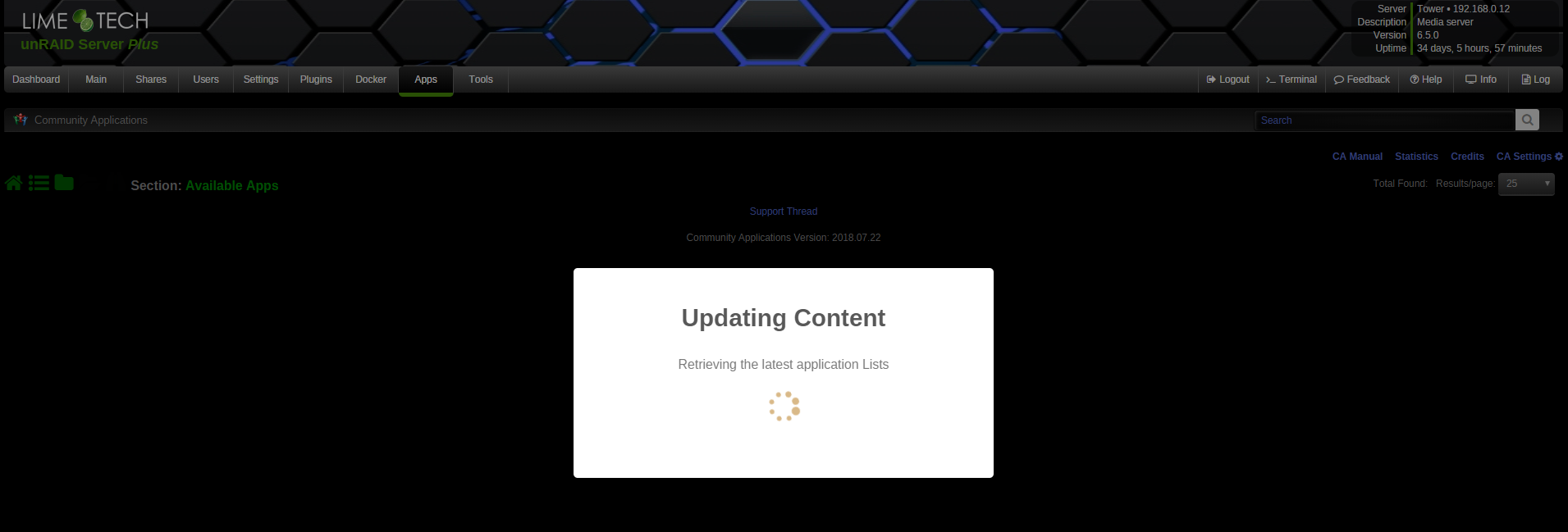

Also noticed the apps tab wont load either and sits on the screenshot below.
Both the loading icons still spin so it hasn't frozen from what i can tell.

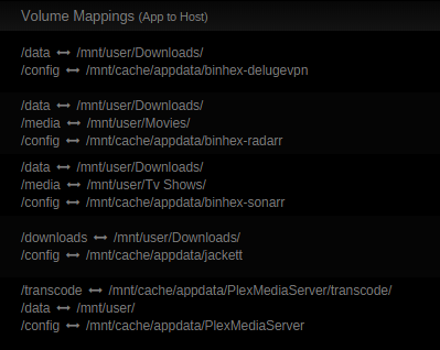

My mappings look to all be in order to me?
You have to check the APPLICATION settings to make sure they match what you mapped. If, for instance, deluge is writing to a path other than /data.

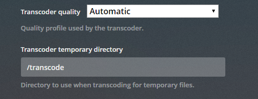

everything looks like it is in order the only thing i'm not certain about is this transcoding location. couldn't really find anything that would say if this is right or not given my particular set up.
Looks like you have a /transcode mapping for Plex so not sure why you would question it. Except for transcoding Plex doesn't write much except its appdata anyway. One of your downloading apps would be a more likely suspect.

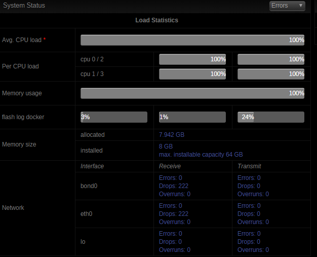

Deluge is all matching up, I did notice that on the dashboard tab this was displaying?
