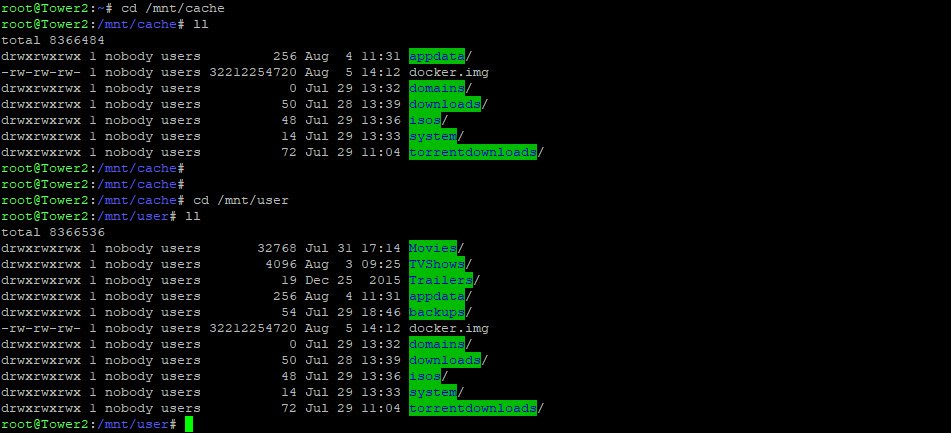

August 5, 20188 yr I have an appdata and downloads share that I had use cache set to Only I still noticed the appdata and downloads had their own shares on the actual array. I only wanted them to be on the cache and not get put on the array So I went in and changed the share to use cache: prefer I then turned off VMs and Docker in the settings and then ran the mover scripts thinking it would put the appdata and downloads contents on the array back to the cache drive and this would eliminate them off the array Well this is not the case, the mover script seems to do nothing Am I doing something wrong? Please help
August 5, 20188 yr 23 minutes ago, Blade said: I then turned off VMs and Docker in the settings and then ran the mover scripts thinking it would put the appdata and downloads contents on the array back to the cache drive and this would eliminate them off the array It will 23 minutes ago, Blade said: the mover script seems to do nothing Go To settings, Scheduler, Mover Settings, and enable Mover logging (temporarily) Run the mover script then post your diagnostics, along with a screen shot of what appears when you go to Shares, and click on "Compute" for the share(s) in question But, what makes you think that they are on the array? Edited August 5, 20188 yr by Squid
August 5, 20188 yr Author Here is the diagnostics I can see the appdata folder under the /mnt/cache and /mnt/user folders I thought it should only show under /mnt/cache Maybe I am wrong tower2-diagnostics-20180805-1408.zip
August 5, 20188 yr 2 minutes ago, Blade said: I can see the appdata folder under the /mnt/cache and /mnt/user folders I thought it should only show under /mnt/cache Nope it'll also show under /mnt/user (as it is a share) If you want to confirm at the command line, du /mnt/user0/appdata /mnt/user0 is the contents of the array without taking the cache drive into consideration
August 5, 20188 yr Author Ah yes I do not see it under user0 at all root@Tower2:/mnt/user0# ll total 52 drwxrwxrwx 1 nobody users 32768 Jul 31 17:14 Movies/ drwxrwxrwx 1 nobody users 4096 Aug 3 09:25 TVShows/ drwxrwxrwx 1 nobody users 19 Dec 25 2015 Trailers/ drwxrwxrwx 1 nobody users 54 Jul 29 18:46 backups/ Thanks for clearing that up for me
