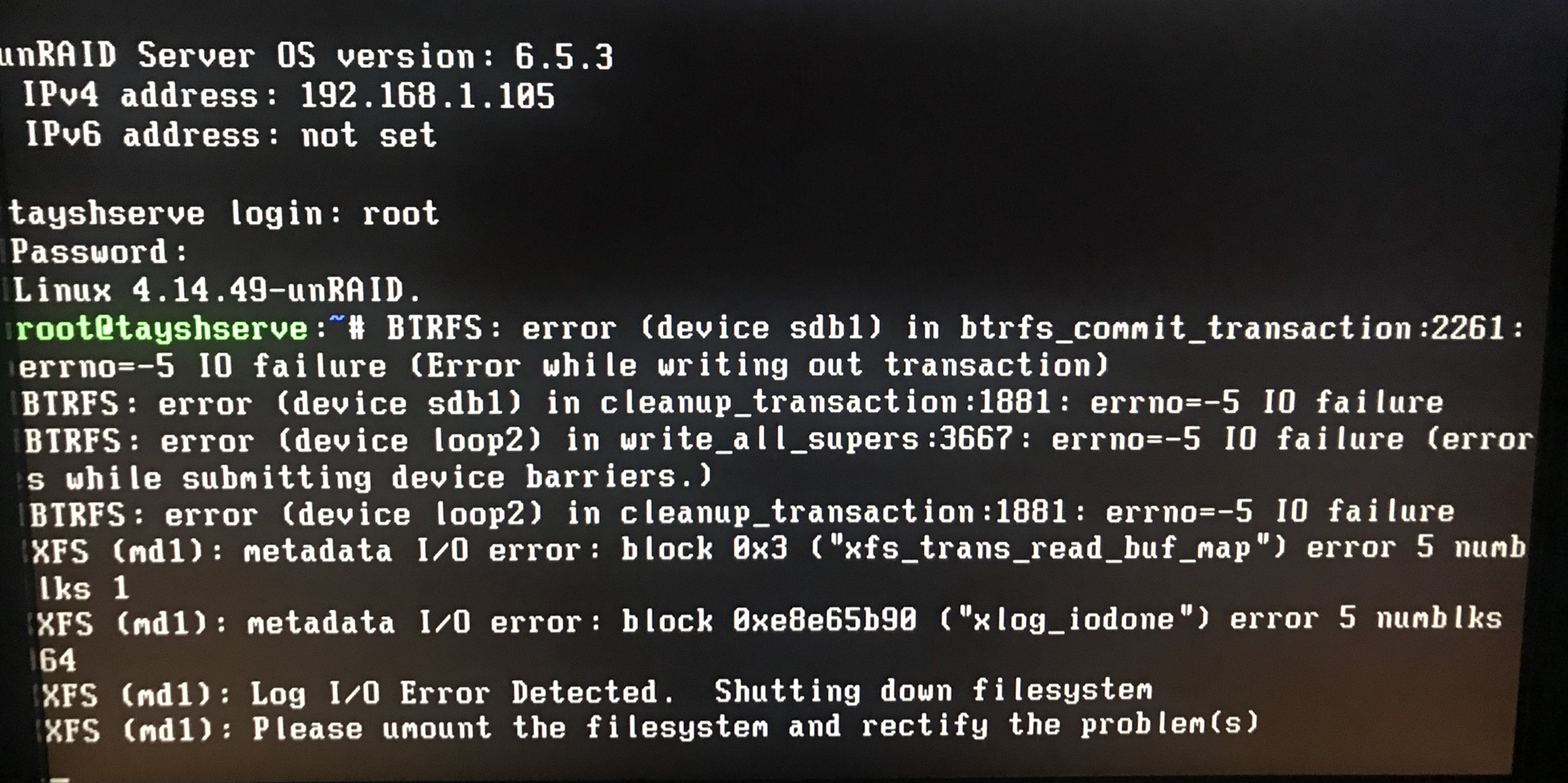

August 6, 20188 yr Seeing random crashes becoming more and more constant. When I first booted up I got about 2 days uptime before the first crash, the most recent one happened after only 11 minutes. Hardware listed below: Motherboard: ASRock ab350m Pro4 (BIOS v4.70 – there is one newer version) CPU: AMD Ryzen 3 2200g Memory: ADATA 8gb ddr4-3000 xpg z1 x 2 Storage: 240GB SSD, 4TB HDD Attaching the FCP log, as well as the diagnostics. Also grabbed this photo of the unRAID console when the crash happened. Sometimes the console is non-responsive. Also I have C-States disabled and the line of code (which of course now I can't find) that lime-tech recommended Ryzen users add. edit: Guess I should ask an actual question.. should I start by updating bios? Are there any other steps I can take here? I'm not finding anything specific about the errors I see in the console. New here so let me know if any info is missing tayshserve-diagnostics-20180805-1852.zip FCPsyslog_tail.txt Edited August 6, 20188 yr by tayshserve Add a couple of more specific questions

August 6, 20188 yr The screenshot shows file system corruption on the hard disk and worse on the SSD - "IO failure" looks like a hardware fault. Aug 5 18:38:46 tayshserve kernel: pcieport 0000:00:01.2: AER: Corrected error received: id=0008 Aug 5 18:38:46 tayshserve kernel: pcieport 0000:00:01.2: PCIe Bus Error: severity=Corrected, type=Data Link Layer, id=000a(Receiver ID) Aug 5 18:38:46 tayshserve kernel: pcieport 0000:00:01.2: device [1022:15d3] error status/mask=00000080/00006000 Aug 5 18:38:46 tayshserve kernel: pcieport 0000:00:01.2: [ 7] Bad DLLP See here: ASRock's support for Raven Ridge has been poor until very recently, with a number if broken BIOSes, so I would certainly upgrade it to the very latest as @johnnie.black suggests. If that doesn't help you might try adding the pci=noaer boot option. See the discussion here.
