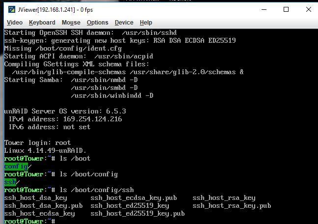

I made my flash drive, it boots up and I get to the Tower prompt however I have no webgui and the only IP is a 169.xxx.xxx.xxx assigned to br0.  I do not see eth0 in ifconfig but if I list PCI devices I do see my Intel NIC there.

Sorry for the delay, I'm running FreeNAS on the box so anytime I need to log a command I have to hop in, reboot, choose unraid and hop in the console over ipmi.  I can't copy/paste text but images are attached.
If the flash drive has been correctly mounted then the ‘ls /boot’ command would show the contents of the flash drive.    Since that is not showing then the flash drive is not mounted and the /boot location you are listing is just in RAM.  If the flash drive is not mounted as /boot then unRAID will not be able to read any configuration information and correctly finish the initial startup process.    This would explain why you cannot get the network running and the GUI showing up.

You're going to have to provide a lot more information about what you are doing.  As the first point, are you attempting to boot on bare metal?

 In yours, There is no EFI  folder/directory  and not syslinux folder/directory and both of those are necessary.  There should also be the bz* files
