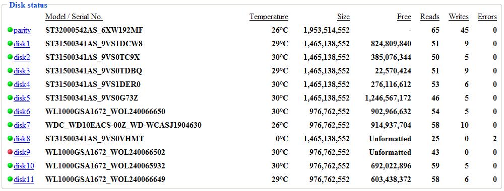

One comes up as unformatted with green light but no temp, the other comes up as unformatted too but red, see below.....any help would be great as I think #8 is empty but #9 is over 1/2 full.

Two of the drives have come up weird and yes I did do a couple of re-boots just to make sure it would not claer itself due to bad unmounting previously.
Only way to know what is happening is for you to attach a copy of your syslog.

The entire log is filled with these messages:

We need the prior log file (or reboot and grab a fresh one before it fills and is switched out to syslog.1)
the prior log file is likely in /var/log/syslog.1
Sorry about that Joe - I re-booted last night and did not pull the syslog until this morning.  This one will work.......

These are the errors that are causing the disk to not show up
Aug 31 02:19:46 Tower kernel: ata2: translated ATA stat/err 0x41/04 to SCSI SK/ASC/ASCQ 0xb/00/00
Aug 31 02:19:46 Tower kernel: ata2.00: device reported invalid CHS sector 0
Aug 31 02:19:46 Tower kernel: ata2: status=0x41 { DriveReady Error }
Aug 31 02:19:46 Tower kernel: ata2: error=0x04 { DriveStatusError }
Aug 31 02:19:46 Tower kernel: sd 0:0:1:0: [sdc] Result: hostbyte=0x00 driverbyte=0x08

Disk8 also seems to be affecting disk9

The file-systems on disk8 and disk9 are not being found, probably because the "read" is failing.  Might check if the cable to those two drives is good.
Joe,
I stopped and the re-started the array and there was no change in these two drives.  I then replaced the breakout cable going to these two drives with an new one and still no change.  Would you suggest I upgrade to the newest version now...?

Upgraded to 4.5.6 and no change at all.....what would you suggest.  Note that both of these drives were green and normal prior to the hardware upgrade.  I even moved the breakout cable supporting these two drive to another SAS port and that did nothing either.

I have done the single SAS card thing with no change.  You're right, it's time to start to move stuff around to see if the problem follows the drives or stays with the port. Thanks...
Update - For those who may care
I moved both of the drives that were causing issues around in the array and without question the issues followed the drives each time so it was clear that unRaid did not like them for some reason.  One of the two drives was totally empty so no issue with pulling that one out.  The second was a 1.5TB drive with 15 BluRay movies on it.  I installed in on an SATA channel on my Windows machine and using YAReG I was able to see the drive and pull all the movies off without a single error.  Makes me wonder why unRaid had such an issue with the drive.
Installed two replacement drives, re-set the unRaid to new, ran a parity and all is good.  Side not, my Parity checks now are lightning fast, woo hoo
