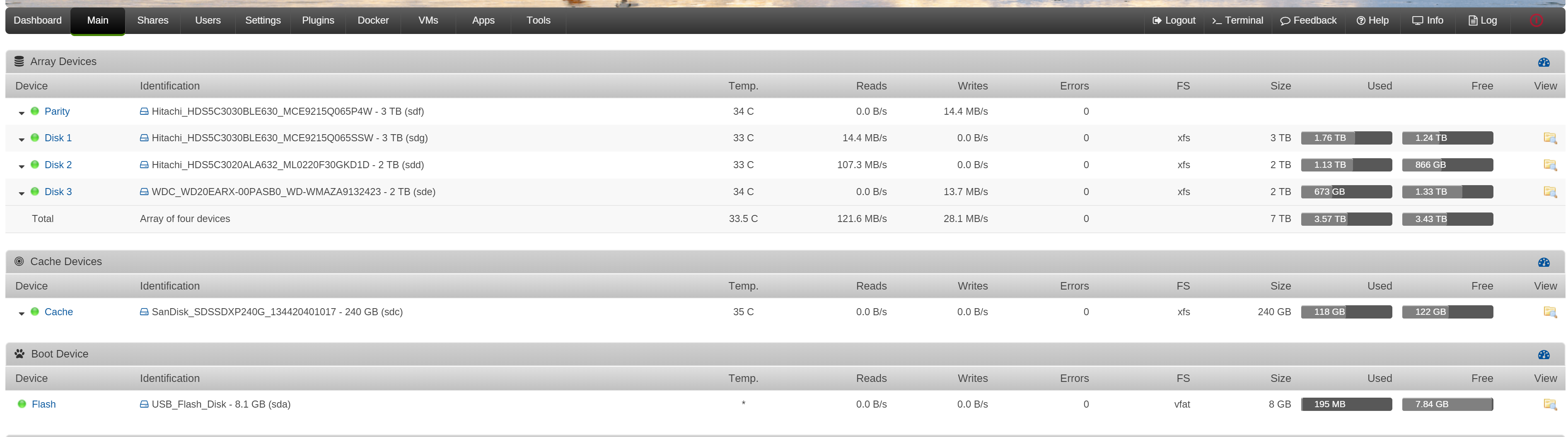

On my main setup (3tb parity + 3tb + 2x 2tb drives), I see that the turbo write speed is always limited by the read speed of the drive that isn't storing the data being moved. As seen in the screenshot below, the drive holding the data is usually reading at high speeds, but the other drive reading parity bits often drops to low speeds (10-40MB/s). Sometimes the drive not storing the data can read at much higher speeds during a turbo write xfer, but it is only for short durations. This is with large data file transfers. I have reconstruct write on, NCQ on, and turned off dockers/vms and other things that might affect it like folder caching, but that didn't fix the issue. Typically for large folder transfers, the avg transfer speed is ~40MB/s with turbo write. These drives are faster than the laptop hard drives that I tested on. When doing a parity check, they all read at 100+ MB/s consistently.

I did some more testing. When I write from cache to array, then the disks doing the reading get consistently high speeds. Its only when I move data from one disk to another disk in the array that there is much slower turbo write speeds.
