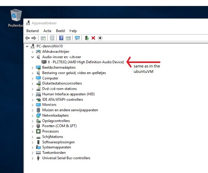

i found out that a cant edit the audio settings without a activated Win10 license???
i did dump the vbios and mount it to the vm's, no results...
I checked device manager: it is there....
