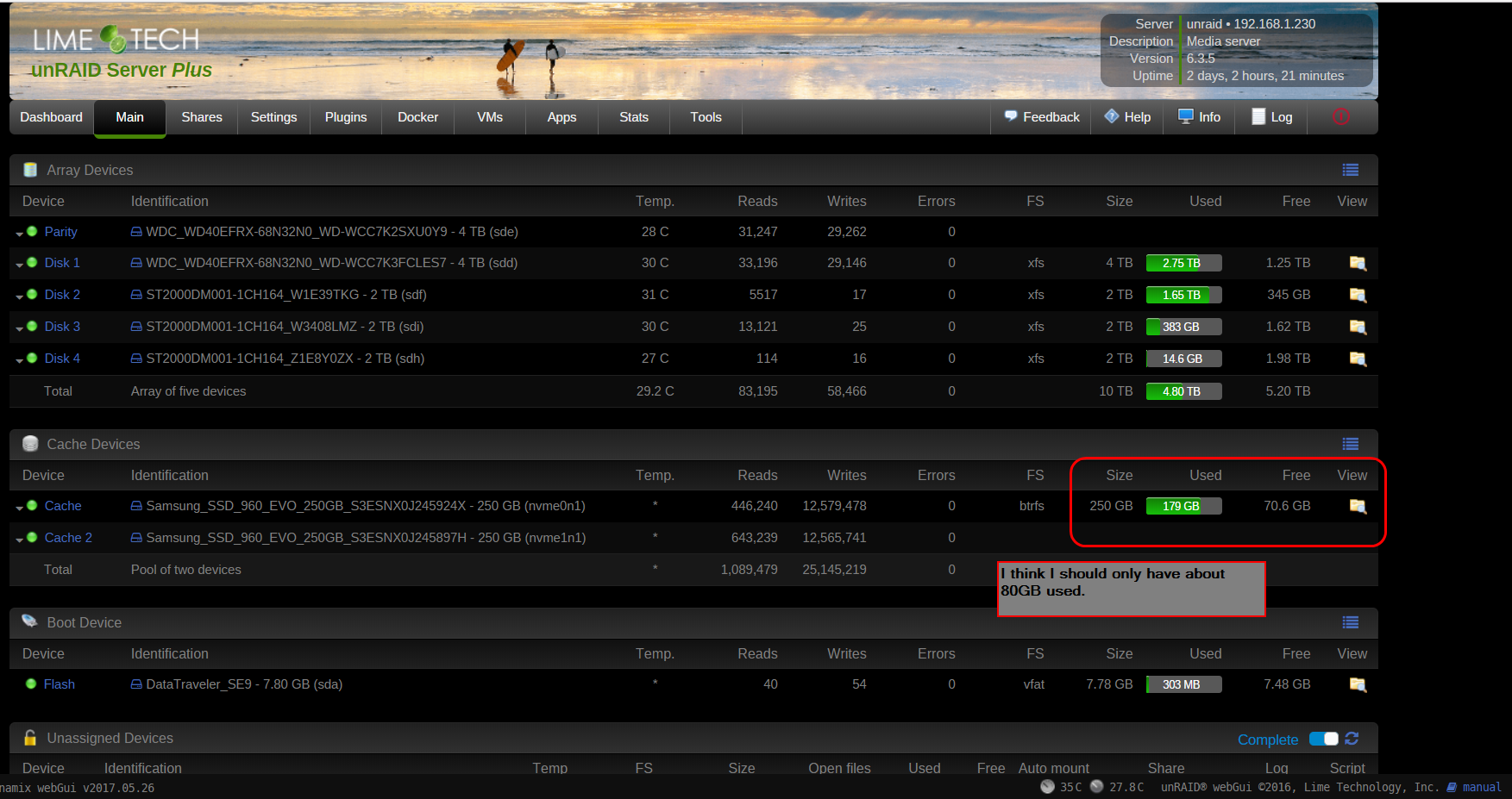

  1. I have 2 Samsung EVO 960 250G SSDs running in a fault tolerant raid0 setup (followed SpaceInvader youtube to setup this up).   My understanding is that with this setup if one SSD fails, the system stays online.  In any event, I'm hoping it's not a hardware issue as my hardware has been stable and untouched for a year.
  2. I noticed that my dockers have actually returned this morning!  I started the array last night and confirmed my docker tab was still empty.  Then I started this post to see if anyone has any ideas.   Up until now I did not want my crippled array left started, so I had the array stopped.  But last night, I left the array started overnight and noticed my dockers were up in the morning when I got up.  I'm not sure what could have happened other than maybe the mover ran and freed up some space?
  3. My windows 10VM is still missing from the VM tab, though I see my VM image here in this 42 GB file I have: /mnt/cache/domains/Windows 10/vdisk1.img.  I'm kind of hoping there is a way to restore my windows VM and get it working, but I'm not sure how to do that...
  4. I think I have some kind of device space issue.  The initial error in my log I noticed yesterday after rebooting and my docker tab was empty: Aug 9 21:17:01 unraid root: truncate: failed to truncate '/mnt/cache/system/docker/docker.img' at 21474836480 bytes: No space left on device
  5. Now, I'm looking at my system log while my dockers have returned and are running and I see "no space left on device" errors like those shown below.
  6. In other threads, I've seen that missing dockers may be related to a filled docker.img file?  I'm trying to figure out how to check for that as I'm not clear if that is my situation.
  7. I'm also not understanding why my cache disks seem to report so much disk space is used.  I have a 250GB cache (see main tab screenshot).  The main tab UI show ~180GB used, and 70GB free.  Yet if I eyeball the files I actually have on the cache drive, I have appdata (~10GB I think), domains (42GB Win10 VM), docker.img (20GB), libvrt.img (1GB), plus some transient media data that the mover moves to the array every 6 hours.  So I think I should only have about 70-80GB used on the cache.  How can I check where my 180GB is going?  Is there a way to check the cache disks and make sure nothing is wrong?
Thanks! -Glenner.
You are using raid1, raid0 has no redundancy, but if one SSD drops offline, and they are both dropping, though possibly not at the same time, you'll still get corruption in any NODATACOW shares, like unRAID uses for docker and VMs by default, also there's definitely a hardware problem, it's the only way to get those write errors.
You do, but the write errors are a much more serious issue, to fix the out of space error you would run this, but since your pool is corrupt don't known if there is much of a point, best yould be to redo the pool, or at least reset the stats to see if you're still having more write errors, you should also upgrade to latest unRAID, this out of space problem was fixed on newer kernels.
Man... this sounds potentially terrible.  But so my server is currently up, all my dockers seem to be running.  I've changed the mover to run every 4 hours instead of 8 as it should keep more space available on the cache.  I've shutdown Plex for now, just to see if that makes things more stable.  I'm just missing my VM, but I can live without it for now.
So I'm wondering how corrupted my system actually is.   I'm not that experienced with doing low level maintenance, but I'd like to and should be able to do anything advised to fix the issues.  This system has been really solid for year and the main load is the SageTV docker which results in 100GB+ of over-the-air TV mpg files being written/read to the cache on a daily basis.   SageTV docker wrote 10-20GB overnight to the cache and it seems to be fine...  Not sure how I got here as I thought hardware SSD issues are incredibly rare.  Issues seemed to me to start within the last few weeks/days maybe and came to a head when I ran Plex transcoding last week for a bit.
  1. The main tab shows "0 errors" for my cached drives.  How do I reset the stats and look for write errors over the next days to see if they are still happening?
  2. I would like to upgrade to the latest unRAID, but there seems to be be some compatibility issues with the SageTV docker so I was holding off until necessary.  Might be best to stabilize what I have before I take that on.
  3. Right... I have raid1.  Maybe I should just switch to raid0 then if I'm having cache issues?  Not sure how to do that...  Maybe I should try an xfs cache while I'm at it?
  4. Is there a good guide to "redo" my cache pool?    Not sure how to do that or what's involved.  I really want to preserve/save my system...
  5. I have not backed up anything on the cache at this point.  I don't have a real backup strategy unfortuantely, so I'm wondering if there is anything I should do on that front immediately.  I likely need to figure out how to save stuff on the cache in case things get worse.
  6. Maybe I should try the balance?  So to do that I just run this command now and report back?   btrfs balance start -dusage=75 /mnt/cache
Thanks!  Really appreciate any feedback and guidance.
On the console type:
btrfs dev stats -z /mnt/cache
This will show the current stats and reset them to 0, then once a day or so run the same command without -z to check current values, they should all be 0
You should also run a scrub on the pool, but note that NODATACOW shares can't be checked or fixed, e.g., the system share where the docker/VMs are is by default NODATACOW.

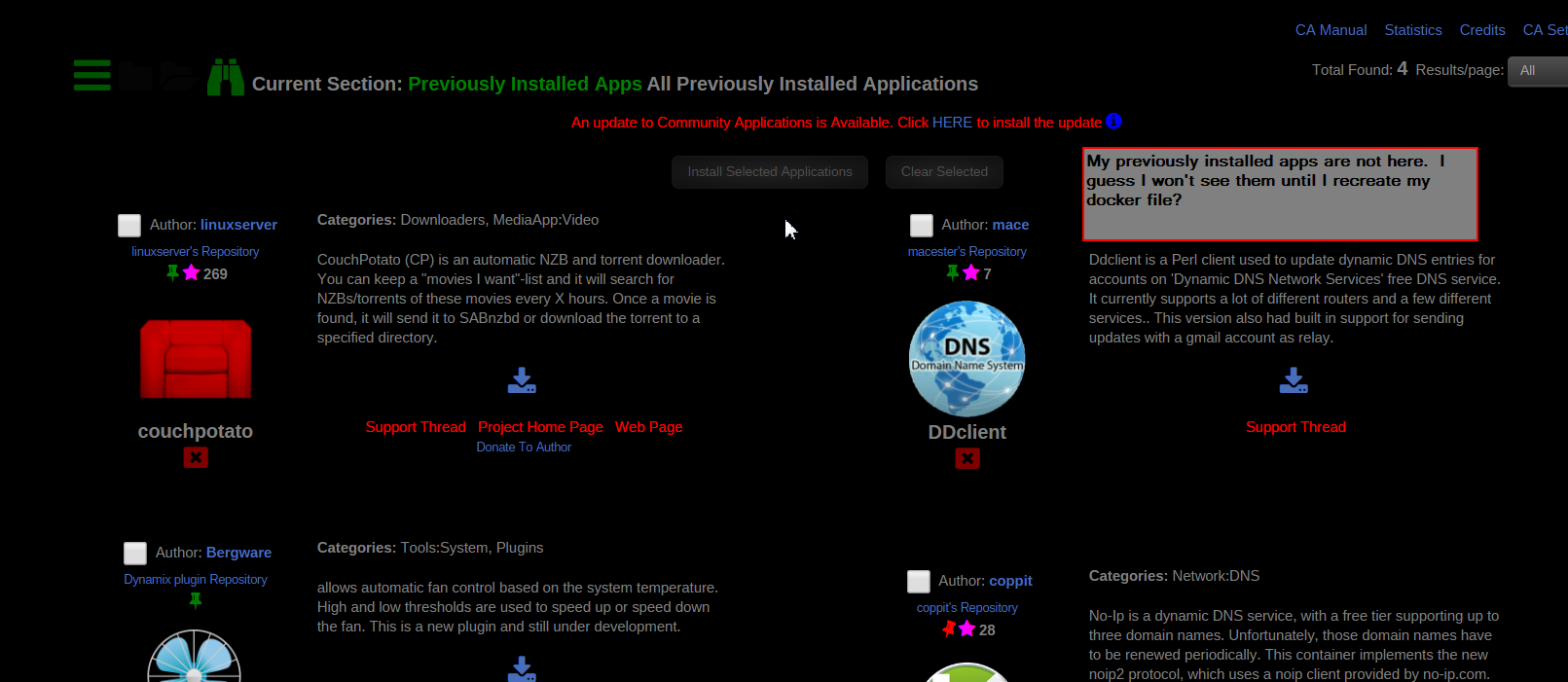

#2. I'd like to recreate the dockers from templates as I have custom config I'm sure.  Just to confirm I'm looking at the previous apps feature right now, and don't see my dockers (only see 4 dockers I don't use in screencap).  I guess I will only see my dockers in there once I recreate a blank docker image?  Just wanted to confirm.
I think it only shows you dockers that aren't currently installed so a new image should work. It just uses the "my-templates" that were created when you filled out the Add Container form when you created your dockers. You can look at any of these templates just by bringing up the Add Container form again and selecting one of them.

Thanks johnnie.black.  Ran it just now, here is the result.  It does seem like a lot of errors.  I'm not sure when these stats were last reset... On a working system you will only ever see 0's here?  Or can some kind of docker software issue also errors? ie. Plex transcoding issues, SageTV tuner hardware loses signal and results in corrupted TV mpg recording (this happens sometimes).  I'm just trying to make sure... Are you suggesting I need to pull these SSD cards and put in new ones?
I'll post updated status tomorrow...
Right now, I still I mostly only have SageTV up and running and hitting the cache at up to 10-18GB/hr or so at times... So lots of IO goes to this cache on a daily basis.
I think I need to shutdown my dockers to make a cache and appdata backup... I'm trying to figure out how to recover my system and rebuild my cache....
root@unraid:/mnt/cache# btrfs dev stats -z /mnt/cache
[/dev/nvme0n1p1].write_io_errs   14402
[/dev/nvme0n1p1].read_io_errs    1
[/dev/nvme0n1p1].flush_io_errs   0
[/dev/nvme0n1p1].corruption_errs 0
[/dev/nvme0n1p1].generation_errs 0
[/dev/nvme1n1p1].write_io_errs   200298
[/dev/nvme1n1p1].read_io_errs    0
[/dev/nvme1n1p1].flush_io_errs   0
[/dev/nvme1n1p1].corruption_errs 0
[/dev/nvme1n1p1].generation_errs 0

#1 - CA Backup plugin: https://lime-technology.com/forums/topic/61211-plugin-ca-appdata-backup-restore-v2/
#2 - Stop Docker service and it will allow you to delete and recreate docker img. Then you can reinstall your dockers with their previous settings from the Previous Apps feature of Apps (Community Applications)
For #1, I'm getting set to do that and create an appdata backup.  I'm just avoiding shutting down my dockers while my wife and kids are watching TV... WAF is an issue for me my server is mission critical. :-)

9. My system should have lots of free space on the cache and so it's not clear to me why it thinks it runs out of space unless the mover moves 10-20GB off the cache on an hourly basis.  Main tab reports 156/250 GB used, with 94GB free.   I should not be out of space?
10.  Even with all these "BTRFS error (device loop1)" in the log, the error stats are still 0.
