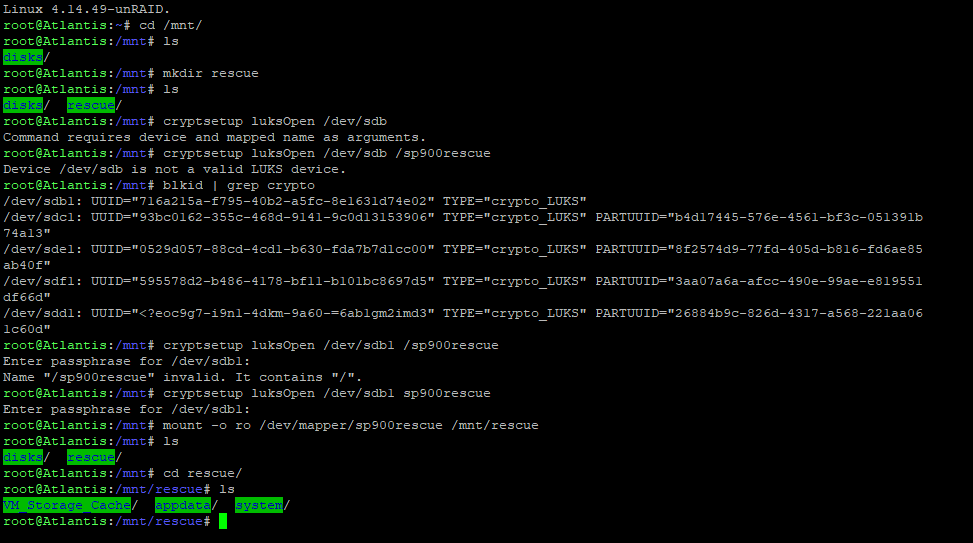

Earlier todya while I was watching something with the misses, the Plex streams stopped. Looking at the server, I found about 85% of my dockers where offline.
Looking at the log, I saw a whole lot of BTRFS errors. I had a file integrity scan happening on disk 3, nothing that should have impacted the cache.
I unmounted the array, then rebooted the server. When it came back up, the cache device was gone. This has happened once before, resetting the cable fixed it. I checked the cable, started it back up again, and the cache was still missing. It was then I noticed it sitting it the unassigned devices section.
It looks like the fs is visable, I'm going to see if I can mount it.
Can someone please tell me wtf happened? Diagnostics attached.
I need to get that cache mounted where it should be.
atlantis-diagnostics-20180812-1802_Anonymized.zip
Update, the cache is mountable, and it looks like the data is there:image.png.29d196a729bf23b13277e94bbcb7914f.png
Though it feels weird there's no PARTUUID like the other drives.
Just need to get it back in the array config somehow.

Maky. The backup finished and I assigned the drive. It wasn't wiped, so as @johnnie.black said, it "slotted" back in fine despite the warnings.
I got the dockers and vm systems back up, and everything seems to be working normally again now.

36 minutes ago, Ryonez said:
Is the posted diag of no use?
Yes, like suspected the cache device dropped offline:
Aug 12 17:23:08 Atlantis kernel: ata1.00: disabled
With SSDs this is usually the result of a cable problem, so start by replacing/swapping both cables.
Thank you. I'll swap the cable out, and will create a new post referencing this one should it recur at a later date. The last time the cache disappeared was quite some time ago.
