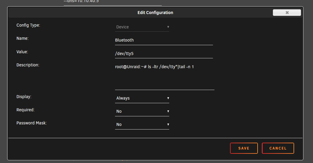

You can run this to see the status of the device "dmesg | grep -i blue"
You can run this to see the tty and do the passthrough in the container "ls -ltr /dev/tty*|tail -n 1"
Both in the unraid command line console
Then you create the passthrough in HA container like this.
I tried to make it work but I couldn't for some reason the integrations in Home Assistant that uses the bluetooth gave me errors.
If you manage to make it work, please, please, post the solution here. Thanks :)

@L0rdRaidenI've updated the firmware files, and the boot config - so the firmware and config files load.
Added the Nerd-pack to get BlueZ and i'm able to run
`hciconfig` on the host AND the docker.
I'm passing the DBus & the device through /dev/bus/usb/XXX/XXX
the error I get now is:
Failed to start Bluetooth: [org.freedesktop.DBus.Error.ServiceUnknown] The name org.bluez was not provided by any .service files
