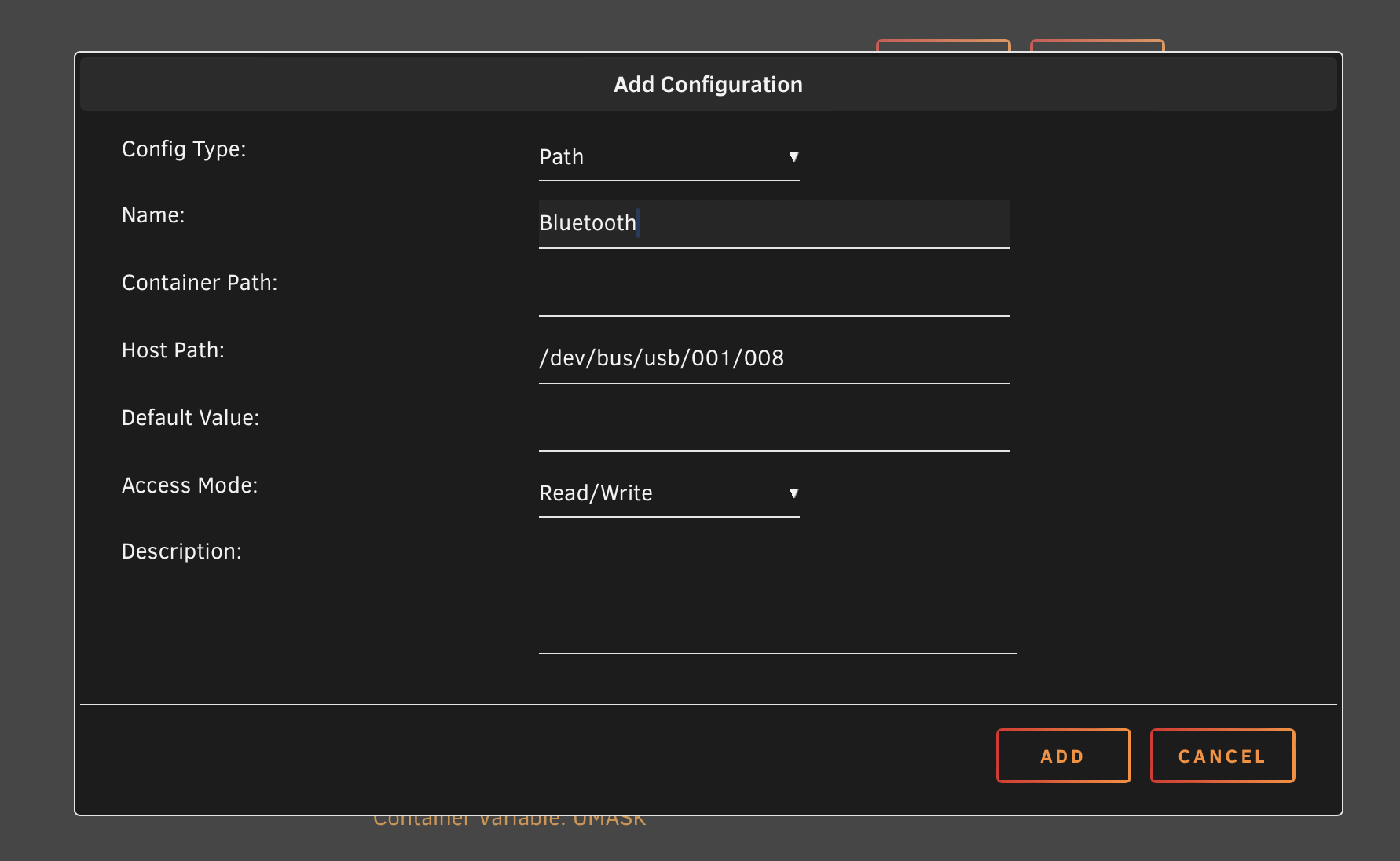

When you say 'passthrough' what does that mean?
Options are extra parameters with --device='/dev/bus/usb/007/005'
or can add a 'path' or 'device'?
Thanks
1614223355_Screenshot2023-11-08at17_50_48.thumb.png.7f7caba9932ef09f93f51f0f3de99e44.png
