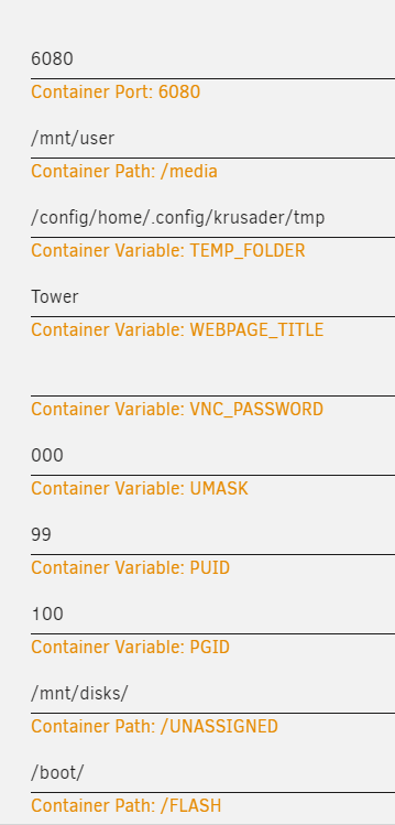

I was interested in the same thing.  I don't know how to "setup host paths of Unraid to see them in krusader".
In krusader my user shares show up in "media" and do not show in "mnt".  I guess cause I did this container setup for Krusader:
I tried to follow spaceinvader video.  I don't know if I did it right.  Probably the wrong place to post this.
I was trying to see the folder "mnt/cache/appdata/binhex-sonarr"  like the way I see folders in Windows.  And same for "mnt/user/Downloads".
Edited by xrqp
to add screenshot.
You have no path mapping that points to /mnt at the Unraid level which is why you cannot see that level from Krusader.
@xrqp,  Edit this this variable:
Change the 'Host Path' from   /mnt/user    to    /mnt
That will point the    /media    directory for Krusader file structure to   /mnt    directory in the Unraid file structure.    (Sounds complex but remember that Krusader is essentially running in a separate Linux VM inside of Docker.)

Why do they use the word "media"?  I though it was referring to media like movies and music and tv shows.  Does it mean media, like disk media, and ssd ( physical data storage devices)?

10 minutes ago, xrqp said:
Thanks!
It's an arbitrary word. You could mount the host folders to a folder inside krusader called "rabbits" and when you looked in krusader your mapped content would be in the /rabbits folder.

It was interesting that in Krusader,
  • Root/media shows all my physical disks, and logical user shares, and cache drive.
  • Root/mnt there is nothing (which puzzles me).
Krusader help told me to use "Edit - Calculate occupied space" to see the amount of bytes in folders, so I was able to solve a problem with an unexpected full cache, and I could see what caused it and so now I know how to fix it.  Excellent.  I assume this is one of the best ways to browse the cache drive.
It is also interesting that Krusader shows all kinds of folders that are strange to me, and I never see otherwise .  Brings up many questions in my mind, but I assume it is not urgent for me to understand.  I fairly understand all the folders in Root/media.
You need to realize (in simple terms) that Krusader is running in a VM and that when you looked at the directory  /mnt in the root of Krusader, you are looking at the folder that is actually a directory of that VM.  (Of course, there are no physical disks assigned to that VM!)   If you look carefully at that 'Root', you will find another directory named 'media'.   The contents of that directory is actually pointed back to the /mnt (or /mnt/media in the original Krusader configuration) directory of the Host machine which is the OS that is running Unraid.  Thus, that 'media' directory is showing you all of the physical disk, cache drive and logical shares.
I know this seems complex but let's look at the edit page for that 'Host path 2'.
Notice is says, 'Host Path:' for that variable.  That is a path on the host machine (which of course, is Unraid) for the Krusader Docker.  If you look at the 'Container Path:', that is a path to a directory on the Docker.  It is assigned a variable name of 'media' but as @jonathanm said, it could just as easily been called 'rabbits' by changing the name in the Container Path!   🤣  Then all of your physical disks, cache drive and logical shares would be inside of the rabbits folder.

Great explanation. I had not thought to treat Krusader like a VM or container.   I understand it now, and i can see how to figure out things on my own better now.
I was interested to see yours shows the "default value" is "/mnt/user".  Mine did not show it.  But then i toggled the basic view to advanced view, and then it showed it.  Thanks!
