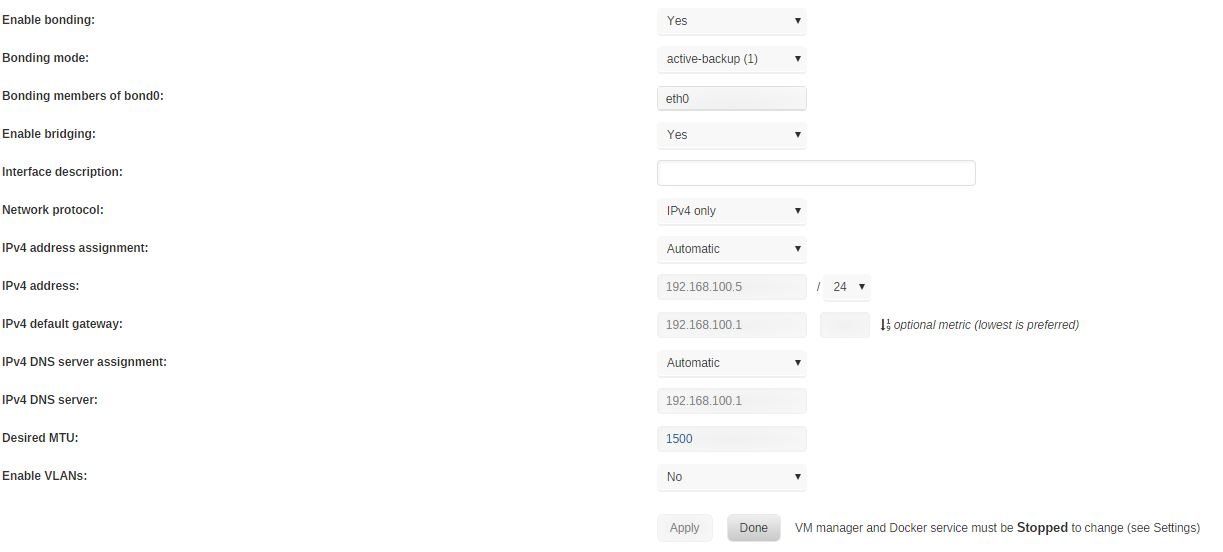

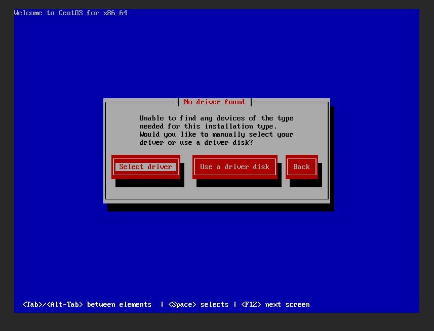

August 14, 20188 yr To begin with apologies I'm a software dev/apps guy, a lot of this sort of thing is dark magic to me! I've been trying to create a CentOS 6 VM on my UnRAID box to match my production CentOS environment, however it hasn't been playing ball with networking. The first environment I created (minimal iso), I could see eth-0 on ifconfig -a, however there was no config file. I manually created a config file, but no luck, after running reboot, network service restart, ifconfig still just returned 'lo' I have a public bridge (no idea if that's working), screen print of settings attached. I have now tried with a netinstall ISO and am presented with this screen for me to select a device driver. I had a look but the QEMU one mentioned n other posts to do with drivers, but it's not present. Is this a common problem with CentOS? Is it a hardware problem? Any help greatly appreciated

June 2, 20197 yr Problem solved. Had to manually pass a nic to the vm by editing the xml of the CentOS vm. It all sounds very confusing, fortunately someone created a video. Once I passed through the nic, the install was simple.
June 2, 20197 yr I am sure that there is a way to emulate a different NIC type (other than 'vfio') that may not need passing through, but for the life of me I cannot find out any documentation on how to do this. I seem to remember that 'e1000' and 'pcnet' are ones that I have seen used in the past. EDITED: Just found that you can run: qemu -net nic,model=? >/dev/null qemu: Supported NIC models: e1000,e1000-82544gc,e1000-82545em,e1000e,i82550,i82551,i82557a,i82557b,i82557c,i82558a,i82558b,i82559a,i82559b,i82559c,i82559er,i82562,i82801,ne2k_pci,pcnet,rocker,rtl8139,virtio-net-pci,vmxnet3 which gives a wide variety of options for the network card to be emulated. Good chance that the VM already has drivers for at least one of these so you can then avoid passing through the network card. You would have to make the change at the XML level to change the type of the network card type from 'vfio' to one of these as the GUI does not support entering them. Edited June 2, 20197 yr by itimpi

February 22, 20206 yr Hi @eds I have just had a look at this issue. The XML for my test Centos 8 VM I just fired up (on Unraid 6.8.1)... <interface type='bridge'> <mac address='52:54:00:e0:a3:3c'/> <source bridge='br0'/> <target dev='vnet1'/> <model type='virtio'/> <alias name='net0'/> <address type='pci' domain='0x0000' bus='0x01' slot='0x00' function='0x0'/> </interface> That is the default, generated by Unraid on my behalf (I selected br0 is my NIC to pass to the VM, as per usual). As itimpi said, there are a variety of NIC models you can use in kvm/qemu.. I have tested the following as working: - e1000, virtio, vmxnet3 You just edit the model type='X' parameter above. In my experience, e1000 has the best compatibility, vmxnet3 has the best performance (ony matters 10G and above, again, in my experience). Are you able to try making that change and see how it goes? Edit - note, it's worth mentioning my server is a Dell R730, using 1G broadcom based NICs. I am using the tg3 driver (as seen under settings>network settings> interface rules). It might be worth checking which driver you have. I know a chap with bnx2 drivers and he has trouble with Centos VMs too... Upgrading the variant of driver your NIC uses might be a solution in itself. Edited February 22, 20206 yr by jmbrnt Clarity

August 12, 20215 yr Was just having this issue on an old centos 6 image that I needed to spin up for some dev work. The answer was to select the oldest "machine" I had available:
August 12, 20215 yr Thanks for updating the thread with new info. I actually solved my problem (fairly recently). I did what it looks like I said I did a year ago and it worked. It may have been an update to CentOS that did it, I don't know. But editing the xml bridge type to e1000-82545em, my NIC showed up and I was able to get an ip address and log in via ssh.
