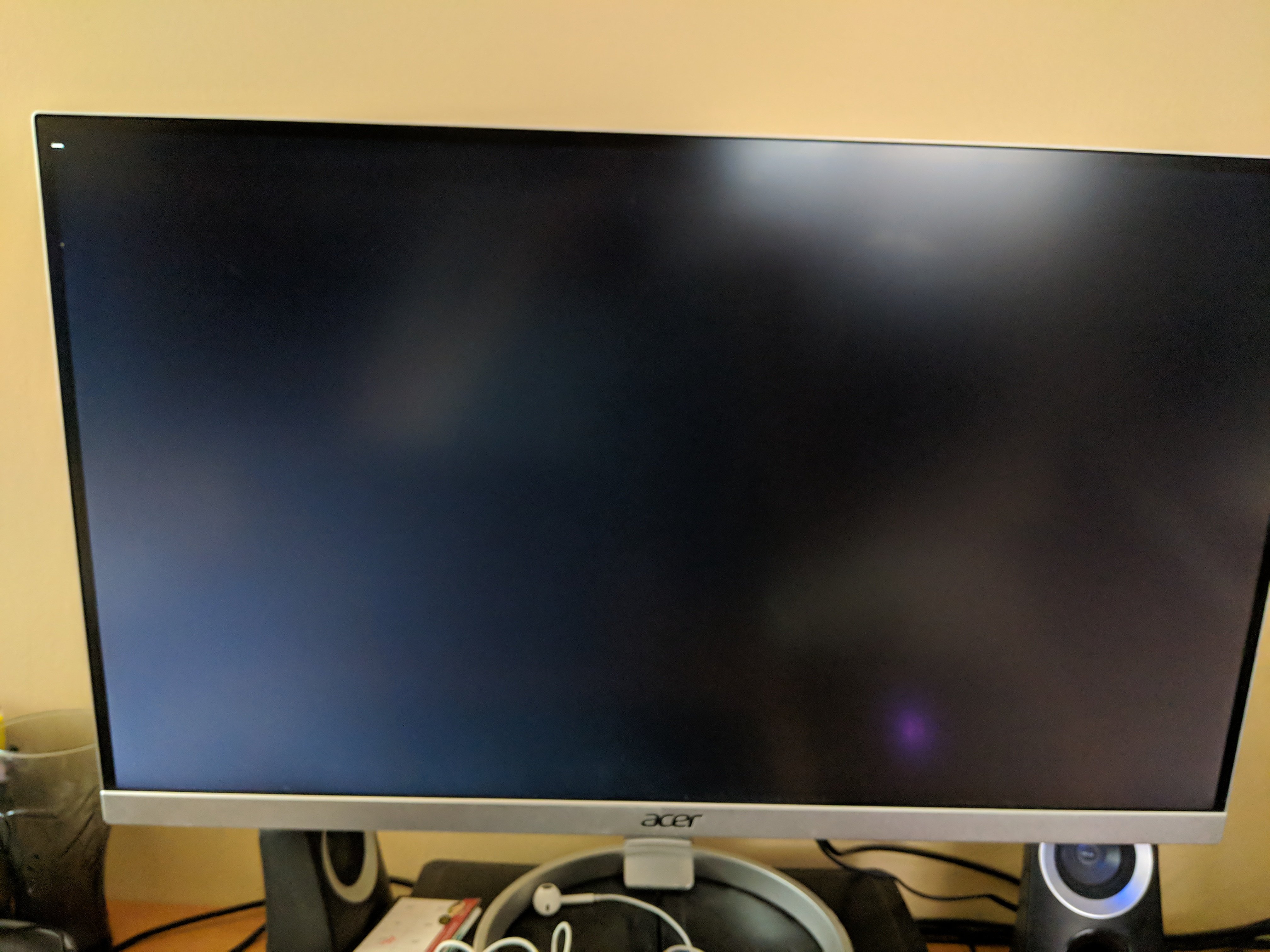

To start off I'm unable to boot into GUI mode with the monitor connected to the server, it just shows a flashing underscore on the top left of the screen. I am however able to access the webUI via another computer on the network and the server runs just fine.
I do wish to use Windows VM with a monitor on the unRAID server with the monitor connected to it, and I know it's possible to boot into GUI mode to do that. Is there a config I'm missing? What diagnostic should I provide. Appreciate the help, thanks!

Thanks for the response! My problem is that I simply could not access boot into the console GUI mode using the server machine. Let's say I don't have another computer to access the GUI via network, and I just want to access the server and make changes via the server machine itself, is that supposed to be possible? What do I do with that "flashing underscore" on my monitor? (attached photo)
OK, What do you see when the server is booting up?  You should be seeing the 'Splash' screen of the MB BIOS followed by the unRAID Boot Menu which stays for about ten-to-twenty seconds, followed by a couple of hundred lines of text as Linux is being installed.  IF you are NOT seeing this, there is something with the Video setup.  Double check that you are connected to the proper connectors on your MB.  (Double check that your MB/CPU combination will actually provide a Video output as unRAID does not actually require a video connection to run!  I almost hesitate to mention this but more than one person has been bitten --- including me--- by this.  I have seen MB's that contain video ports that are not usable unless you pick a CPU with a GPU designed into them.)

I see the boot menu and everything, including the hundreds of lines of codes of the server booting up. The server boots successfully and server is up and running no problem, I just don't have a GUI output from the baremetal machine after it boots. The "Flashing Underscore" happens and stays like that after the server boots. My MB and CPU combo (MSI H110i Pro & i7 6700K) contains an iGPU and I'm using an HDMI output from the MB, so the problem is not there (or else I wouldn't be able to see the boot menu at all)

OK, It is not anything really simple.  I would now suggest that you get a get a diagnostics file from the server.  You can do this two ways.
First way, from the GUI.  go to    TOOLS   >>>>    Diagnostics    That will generate and save the diagnostic zip file to the download folder/directory for your browser on your PC.
Second Way.  Use an SSH session and log onto the server to the Command line interface.  Now type    diagnostics  at the prompt. This will write the file to the   logs  directory on the flash/boot drive.  Put the flash drive into your PC and copy it off.
Which ever way you get the file upload it in your next post.
From your description is looks as though the text-based part of the boot sequence is displaying normally but the problem happens when the output switches to graphical mode. Try the nomodeset tweak here:

Does boot in UEFI ? Anyway pls try enable CSM(Compatibility support Module) in mainboard BIOS even boot in UEFI mode.
Thank you, Benson directing me to UEFI. My boot was UEFI. Couldn't find anything like CSM in UEFI options. Instead, there is "UEFI Optimized Boot" which was enabled by default. I disabled it and bingo! It is now booting to GUI.
Also, deleted "nomodeset" from unRAID menu entries as there is no need in my case.

Yes! OMG it was my boot setting the whole time! a "Windows 8.1/10 WHQL Support" was the culprit, I turned it off and it works! I think disabling that setting turned on Legacy boot, prob was only UEFI boot before. The MB bios wasnt very clear so was somewhat confusing.

@EricM Had the same thing setting up a ASRock B450M Pro 4 - chage the boot settings to USB:<your memorystick> from UEFI:<yourmemorystick>
That worked for me. Hopefully you'd got it sorted by now anyway!
