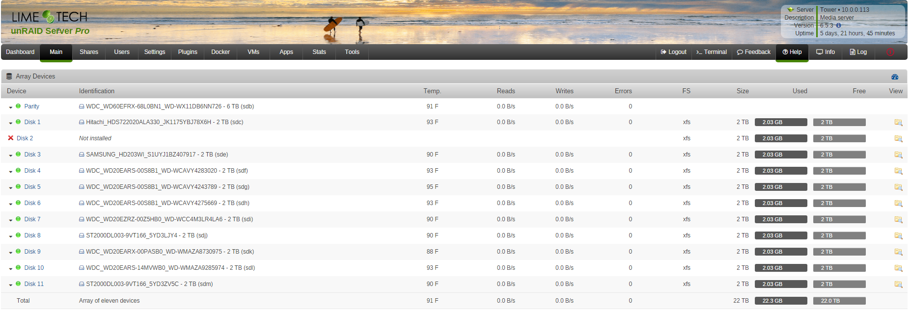

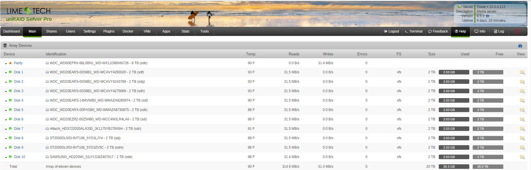

I have been trying to give myself a crash course in unraid over the past week and thought I was making progress.  The Tower only has capacity for 12 drives. Below is what my rebuild now looks like.
I assume I am going to have to wait another 2 days for this to complete and then I will need to try and put in  6 tb. drive I precleared again
Very dejected at this point.

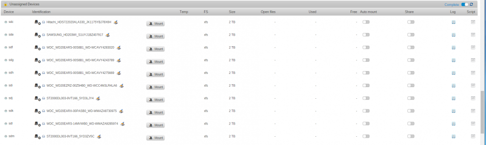

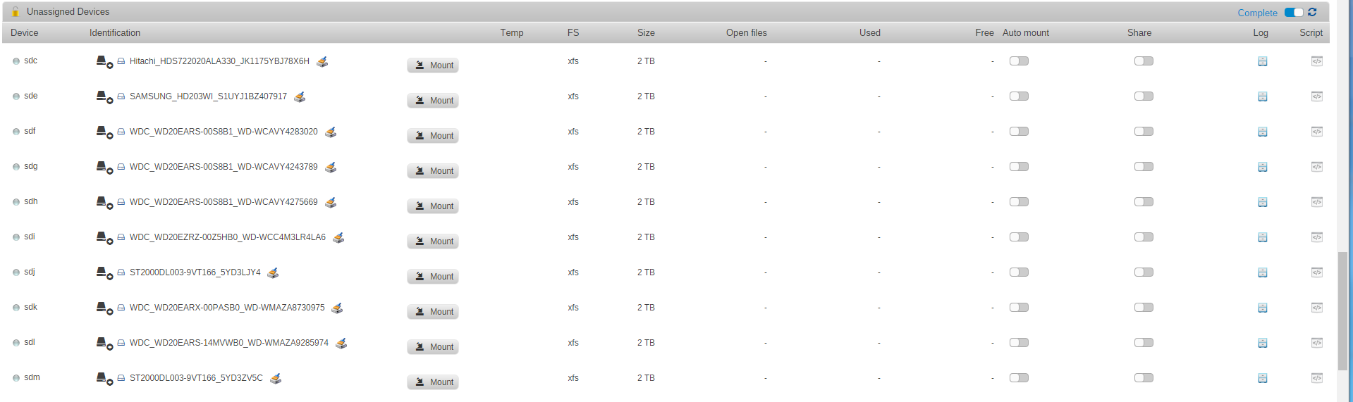

My newly precleared 6 tb data drive is not available as a drive to select?  Nor is the original 2 tb that I replaced?
That screenshot is for the Unassigned Devices. You need to be looking at the Array Devices. It should give you a dropdown (assuming array is stopped) at each slot to allow you to select any drive (that hasn't already been selected at another slot).
Yes, I can not screen capture the drop down.  The only drives available in the dropdown for array assignment are the ones I am showing in the list.
