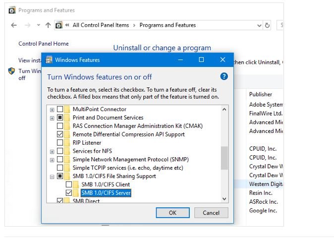

One thing that I might suggest is that your revisit this screen:
and check the box        SMB 1.0/CFIS Client        and see if that effects anything.
One quick thing.  Is this Win10 a virtual computer running on your server or do you have a free-standing computer that you are using?
@Frank1940 thank you thank you thank you ....... it works... if i could buy you a beer ... it would be a pub. turned on client and it all appeared ... i am not worthy... and yes its going to be a vm
