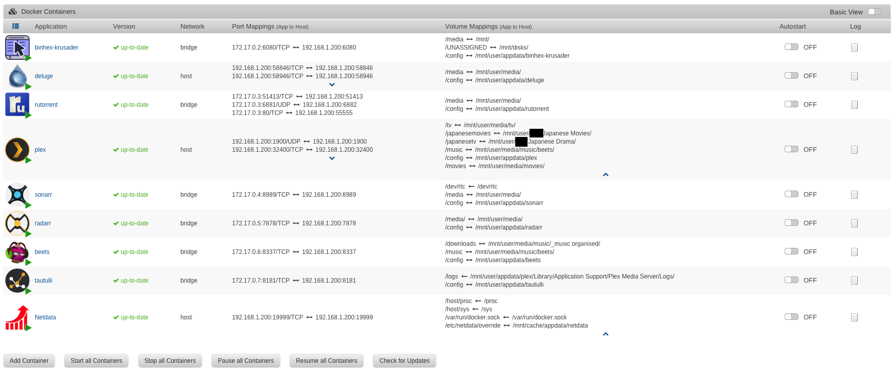

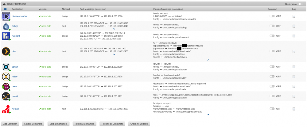

I've attached a screenshot of all dockers and their mappings, all settings are pretty standard as far as I can tell.

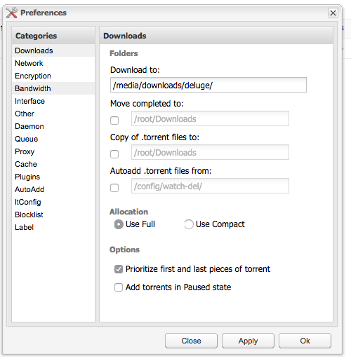

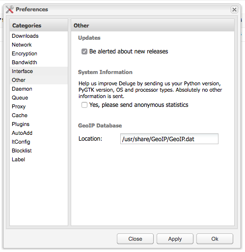

Is there a simple way to go about this? I assume what you mean is to make sure no settings inside the container refer to any path not mapped by docker? eg. looking in deluge settings I can see that the "download to:" path is fine (/media/ is mapped), however the "GeoIP Database" setting is mapped to /usr/share/GeoIP/GeoIP.dat; /usr/ is not mapped.
Is this an example which trurl mentioned which would fill up ram?

I believe your download path in the last screen shot should be      /mnt/user0/media/downloads/deluge   The location where you are putting these downloads is on a RAM disk that unRAID creates to store the OS and all of its support files.

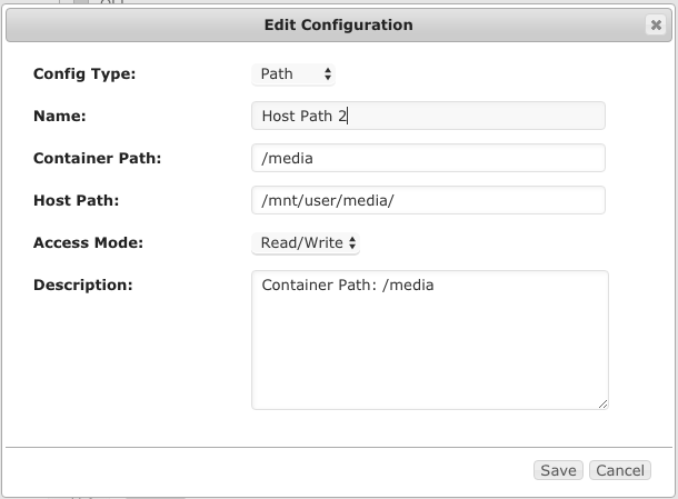

Deluge container mappings for the media share are (screenshot below):
/media/
/mnt/user/media/
Cache is set to "no" for the media share. I'm not sure why I'd need the user0 path if cache is set to "no"
My understanding is that /media/downloads/deluge is a correct path inside the deluge container.

Your Plex docker doesnt show a /transcode mapping but the process list shows pkex transcoding. But its odd that docker doesnt show as being full.

Good spotting, although I think that's standard practice for the plex container. I found this post which relates to your observation; Apparently writing to RAM is the desired function, although no the default. If I read that link correctly the (unmapped) standard setup transcodes into the docker.img file, which resides on my cache drive.
Any location inside the application that is not mapped would be a location inside docker image which is on unRAID storage. I don't use deluge but transmission has something similar. It shouldn't take much space.
