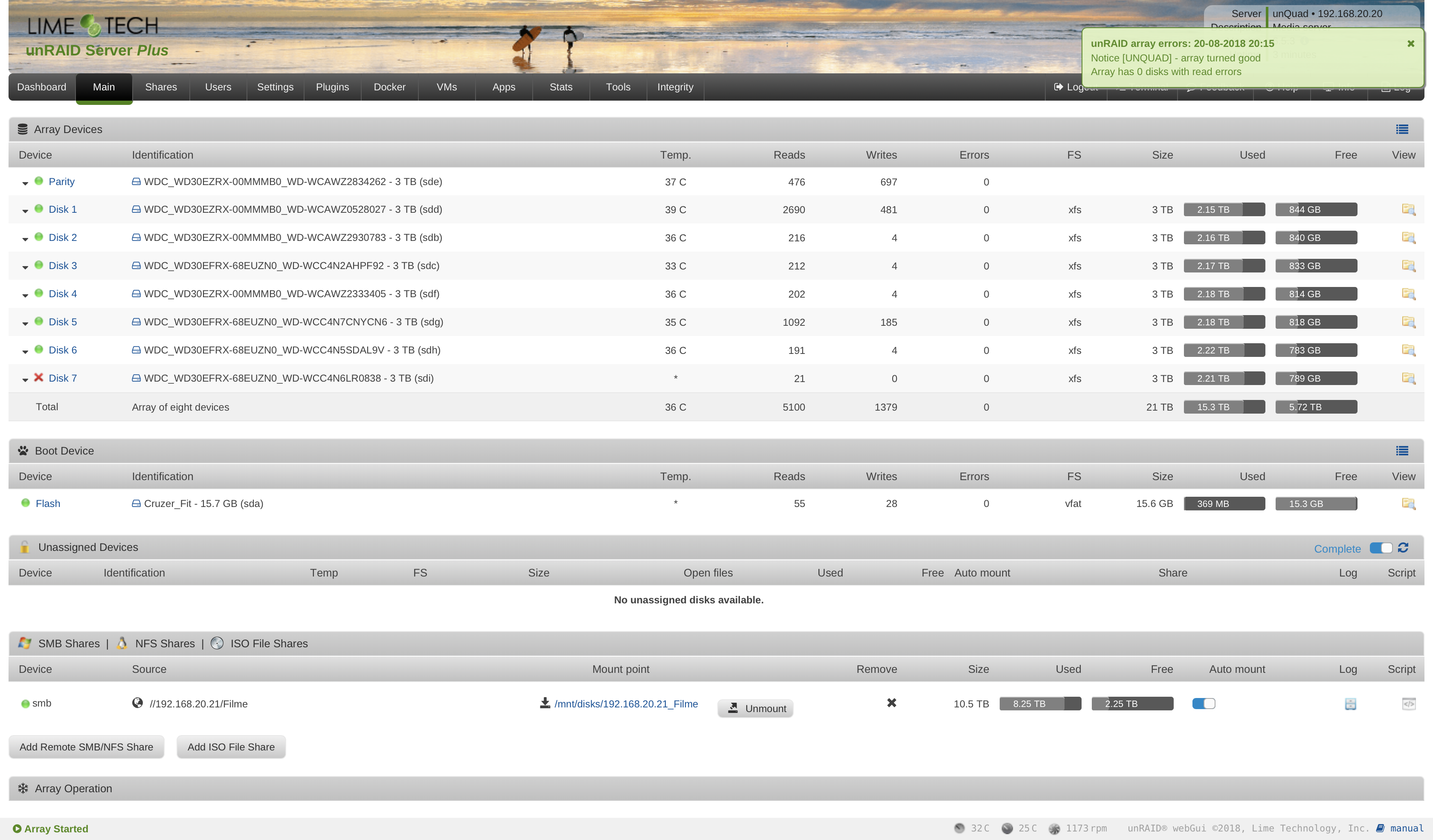

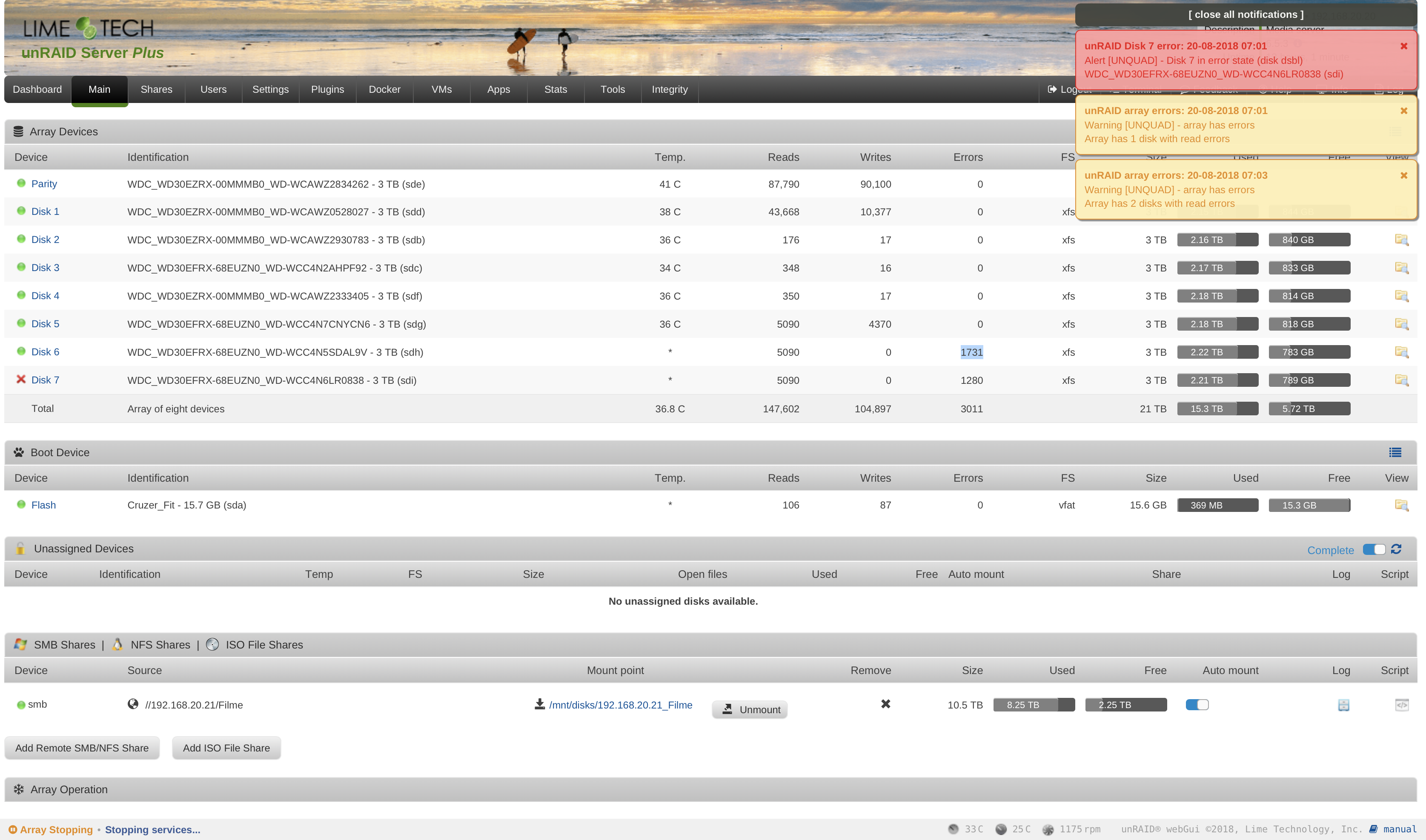

One disk (disk6) has read errors (1731) and another disk (disk7) is in error state.
My first impression was to stop the array. This is now almost 12 hours ago, but stucks at "stopping service" and I don't want to do a cold restart.
I attached the diagnostics and an actual picture.
Please can anyone give me a tip what to do next?!? Wait for stopping services? Just do a cold restart, because there is nothing to do? Any chance to stop this the right way and deal with the errors (how)?

Neither disk6 or disk7 are reporting SMART. However, according to the screenshot and the diagnostics, you only have one disabled disk, disk7. So you should be able to rebuild it fine with single parity.
Shut down, even if you have to resort to a hard powerdown, and check connections on those disks. Are they on the same controller?
After checking connections, reboot and get us a new diagnostic.
Both Disk 6 and Disk 7 have dropped off-line so there is no SMART report for either in your diagnostics. Very often this is caused by a bad cable and the disk itself is good. Your syslog shows that the controller was having problems communicating with the two disks and it repeatedly reset the SATA links. If the controller can't communicate with the disk then reads and writes will naturally fail.
What you need to do is shut down the server. After failing to shut down for such a long time you have no option but to force a shutdown by pressing and holding the power button. Then replace the SATA cables to Disks 6 and 7 and check the power cables to those disks too. Turn on the power. The array won't be able to start because of the two dropped disks. Grab diagnostics and post the zip file.

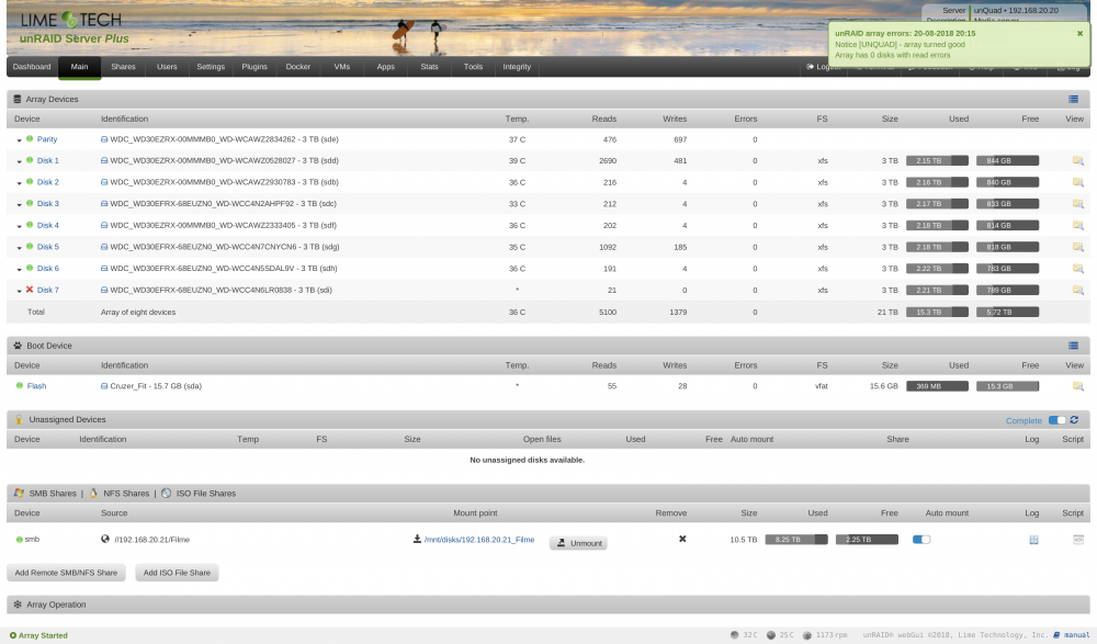

Only disk7 is disabled. If it can see disk6 after rebooting it should be able to start the array.
I am a little confused, because the array was automatically started without disk7, but with disk6 which suddenly turned to okay?!?
Should I unassign disk6 and 7 in this situation? Stopping array?
Yes, you're quite right. In that case, Marino might simply be able to rebuild Disk 7, depending on the SMART reports.
No. Just post your new diagnostics. We need to see the SMART reports for Disks 6 and 7.

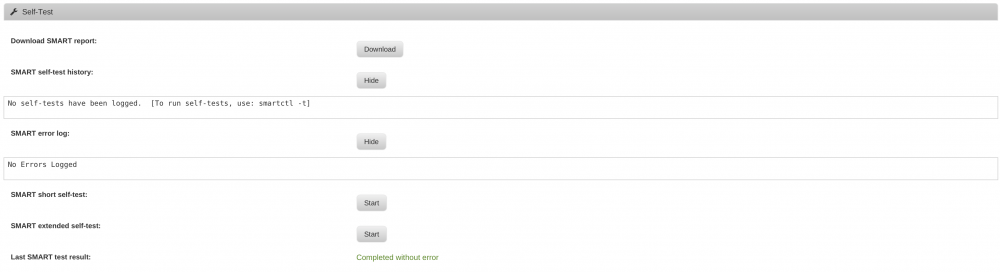

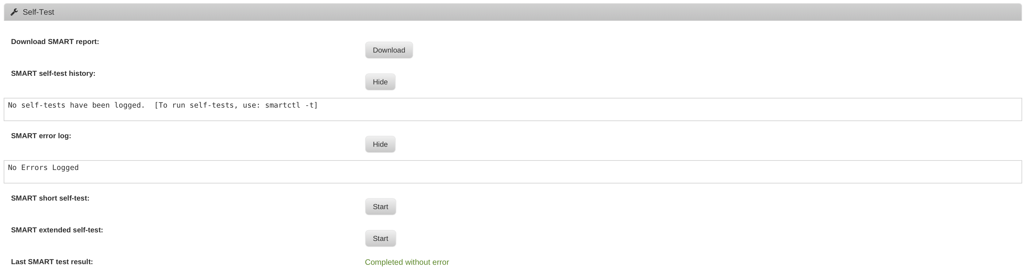

Short SMART-Test on disk6 has passed without errors.
Should I run an extended Test an is it good, that the array is running?
I definitely changing the cables. Maybe disk7 has only a bad cable?

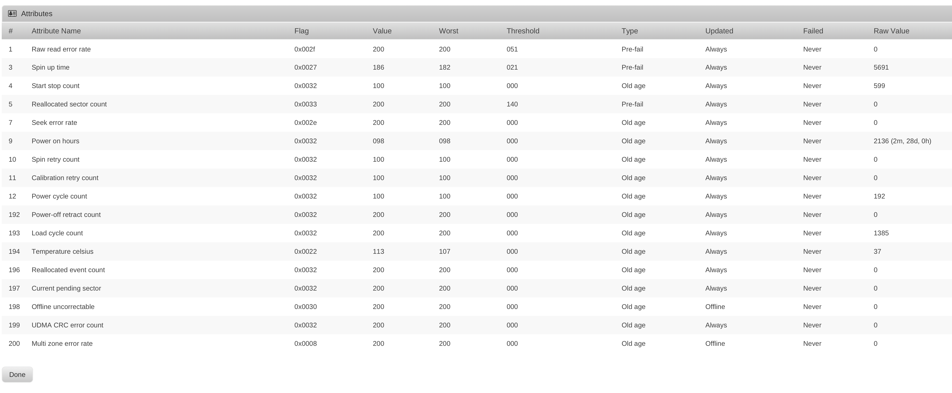

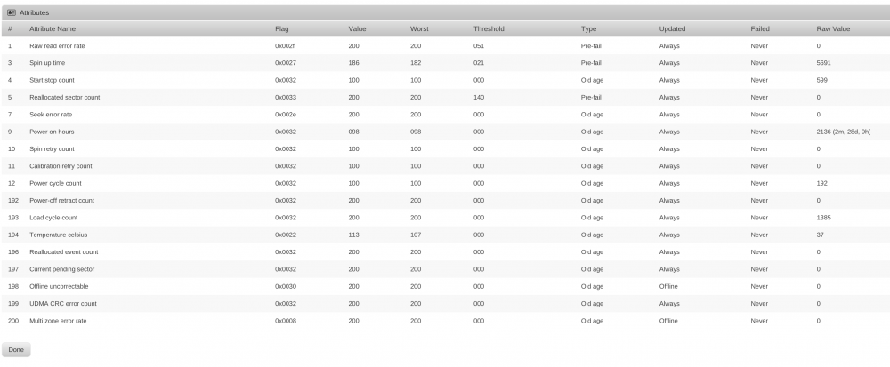

The SMART reports for both Disk 6 and Disk 7 are fine.
Your problem might have been caused by crosstalk between the neatly parallel cables. I don't tie SATA cables together. If you don't replace them, at least cut the ties holding them together.
Once you are happy with the cables you can rebuild Disk 7 onto the same physical disk. Stop the array. Unassign Disk 7. Start the array. Stop the array. Reassign Disk 7. Start the array and let Disk 7 rebuild.
Before doing a rebuild, it's generally a good idea to run extended SMART tests.
But the good thing here is that no reallocated/pending counters are non-zero. So the issue is most probably a question of unRAID losing connection to the drives with no hardware issues with the drives.

If there were reallocated/pending counters non-zero the drive had bad sectors already and reallocated this as an automatic repair? Then a zero is a really good sign.
Edited by Marino
All error counters zero is definitely a very good sign that there was no disk problem that resulted in unRAID dropping the drive.

All unique sector numbers above represents 4 kB of invalid content on disk 7 compared to what the emulated drive has.
7 minutes ago, Marino said:
Are the data on this drive corrupt or is it a good idea (and possible) before rebuilding to the same drive to backup the data from this drive in case of failing rebuild?
Do you have good backups of any important and irreplaceable files?
The disabled disk is being emulated by the rest of the array, so all its files should be accessible without doing anything. If you really want to, you can copy them, but I don't recommend copying them to any other disks in the array, since the array is currently unprotected and you should avoid writing to it. Copy to another computer would be simplest if it is just a small amount you want to copy.
A better approach would be to do the rebuild to a new disk and keep the old disk as a backup in case there is a problem.
It really is a good idea to always own one spare disk that can be used in case of issues. It can work as a panic backup, or to quickly start a rebuild after a failure. The goal should always be to reduce the time a RAID is unprotected. And there is always a danger rebuilding to the same disk that dropped - if another disk fails during the rebuild, then the almost correct data on the problem disk has been lost.

But I can not see a difference between a damaged drive or a bad cable, right?
trurl
Sure. I have a Backup of important data. But there could be also data which cost me hours of work to be done again. When I have the chance to avoid that to have more time with my little daughter, i would prefer that :)
Means emulating that copying single files is a partly rebuild of this files instead of all?
In my ideals I thought I could unassign the disk 7 from the array, copy the data to an other computer (my 2nd unraid) and then do a rebuild.
I wanted to upgrade my other unraid-server. But the Problem is, in this case I am getting an 4tb hdd and the biggest hdd has to be the parity disk.
And because I have space on the 2nd unraid-server, I thought I copy the data from disk7 to this and the disk7 could be swiped out or rebuild.
I does not understand what it means that the data is emulated by the other drives.
The System is only unprotected while I am testing. I shut down the whole system when I don't need it and when there is a problem. The next point I am starting the server is after changing cables.
I've another "great idea" :)
When I have to rebuild to the same disk, could I install the disk7 as unassigned disk in the other unraid-system, copy the data and then reinstall it and do a rebuild? The system could stay of during this time. This could be a preferable method to safe the array while copying...
Is this possible or should this not be done? This would be copy without emulating. Copying while emulation and after that rebuild would be a double rebuild and stress for the array or not?
The rebuild itself will take hours of activity of all drives. Long enough for the array not be secured.
Note for me: Maybe it is best to buy a controller-card to extend the system and buy an other drive. Preclear the new drive, replace and rebuild. After that preclear and test the origin disk7 and when everything is fine use this drive as parity2...?  But on the other hand, I don't feel safe to use this drive...
Edited by Marino
The disabled disk is emulated by calculating its data from all the other disks in the array. Reading all files should be possible from an emulated disk. An emulated disk can even be written to by calculating the data from all the other disks then updating parity as if the disk were written.
So, even if the disk were dead or not present, all of it can be read from the parity calculation. And you can use that emulated read to copy its data over the network to your other server, for example.
That should be OK. Even if mounting it unassigned on the other server did write something to it when you rebuild it later in its original system it would be back like it should be. I think I would probably shut down the server with the disabled disk so nothing else happens to it until you are ready to rebuild though.
I would prefer to shut down the server, install the disk in the 2nd unraid-server and do a backup. The data on the drive should be okay even when they dont match the parity which is why it is disabled. After that I could to a rebuild or unassign it and compute new parity. What would be the better solution?
I would like to store some data on an other computer and searching the best way to do it with the smallest time amount of having the array unsafe.
Just for Interest: Could I use a 4TB drive for replacing when all drives including the parity are 3tb? The paritiy has to be >= the largest disk, but can I use the 4tb disk and only be able to use 3tb on this?
Read this wiki and come back with any questions:
https://lime-technology.com/wiki/The_parity_swap_procedure
