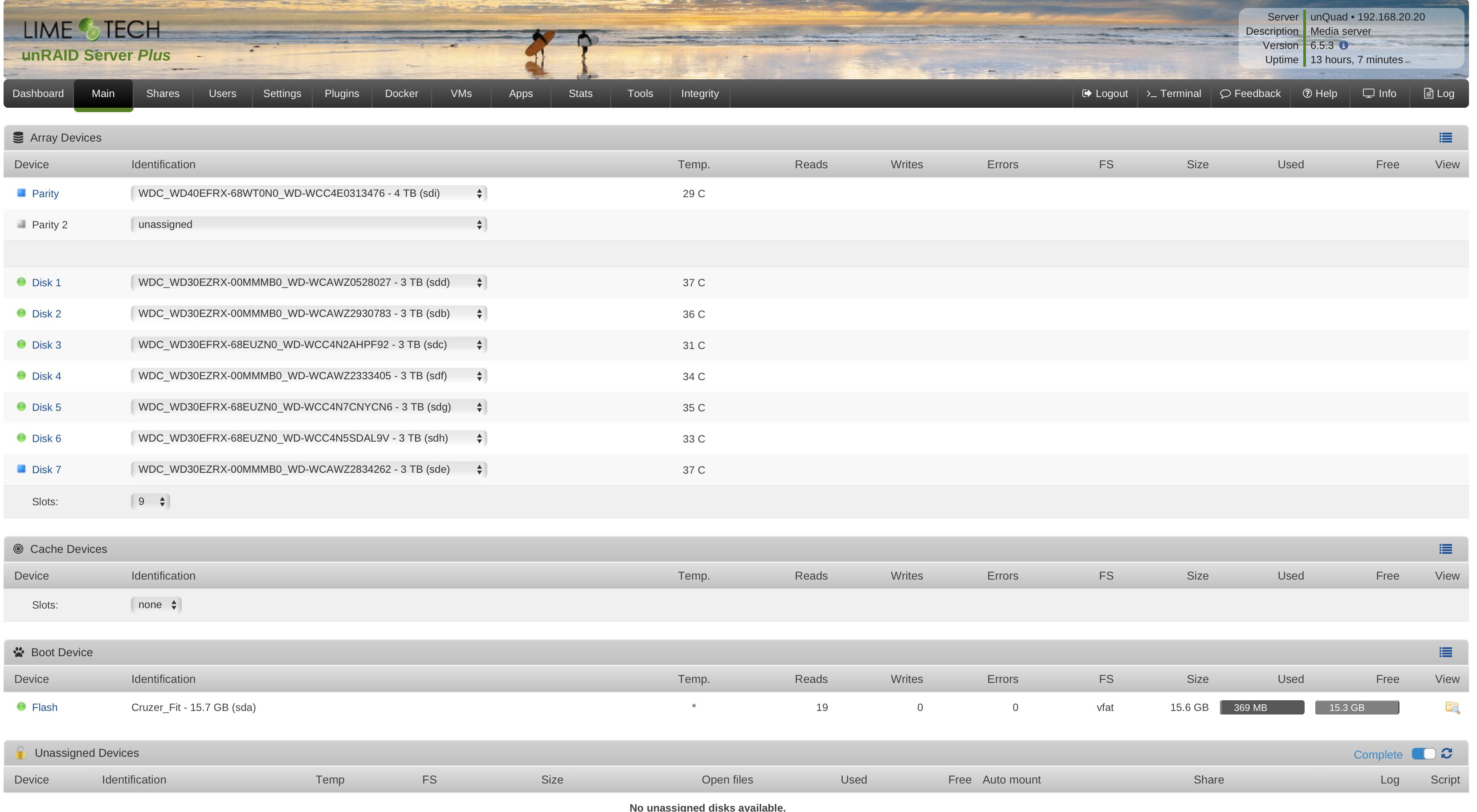

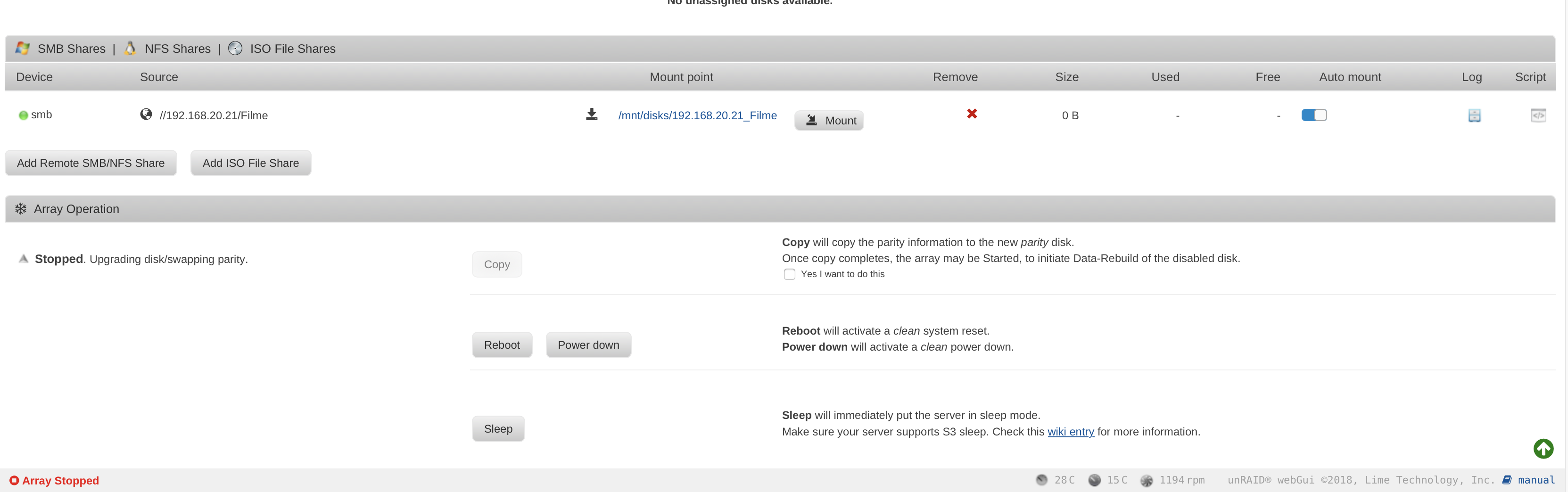

Yesterday I finally installed the 4TB drive to swap.
I am willing to do a parity swap, but this will not work, because of some errors in log (attached).
The first Error is shortly after "Sep  5 17:53:46"
Here a few of them:
...Sep  5 23:09:30 unQuad kernel: ata6.00: error: { UNC }
...Sep  5 23:09:31 unQuad kernel: print_req_error: I/O error, dev sde, sector 4171739048
...Sep  5 23:09:33 unQuad kernel: ata6.00: exception Emask 0x0 SAct 0x0 SErr 0x0 action 0x0
...Sep  5 23:09:33 unQuad kernel: print_req_error: I/O error, dev sde, sector 4171739048
...Sep  5 23:09:33 unQuad kernel: Buffer I/O error on dev sde1, logical block 4171738984, async page read
...Sep  5 23:09:36 unQuad kernel: ata6.00: exception Emask 0x0 SAct 0x0 SErr 0x0 action 0x0
...Sep  5 23:09:38 unQuad kernel: Buffer I/O error on dev sde1, logical block 4171738986, async page read
I checked the box "yes I want to do this" and was copying. In the middle of the night it seems to be done and I checked the box again, but I can not say if there was standing copy or start, I think copy.
The 4TB drive is from the other server and disk7 (sde) is the old parity drive, which replaces disk7 which was there before and was offline. This disk is next to me on the table.
I changed the SATA-Cables from 5 of the 8 disks to new good ones and they are not tied together anymore. The other 3 were changed recently.
I am just not good in reading errors. I saw there are some, and they seems to be not good, but many of them are cryptical to me :(
UNC = Uncorrectable?
I don't know if I can use preclear for "checking" the drive? I am afraid of installing preclear, as I don't know on which patch it will be installed and the it could be possible to get the parity unvalid, when there is something written on a data disk.
I run a short SMART-Test on both the drives:
disk7 gives me "Errors occurred - Check SMART report" (attached)
parity (4TB) is without any error.
What is the log exactly telling? Uncorrectable error on the old parity drive, so that I have to put that disk away and deal with the lost of parity?
I think these are the interesting parts in the SMART-Log:
  40 -- 51 00 06 00 00 f8 a7 af aa e0 00  Error: UNC 6 sectors at LBA = 0xf8a7afaa = 4171739050
  40 -- 51 00 01 00 00 f8 a7 af a9 e0 00  Error: UNC 1 sectors at LBA = 0xf8a7afa9 = 4171739049
  40 -- 51 00 01 00 00 f8 a7 af a8 e0 00  Error: UNC 1 sectors at LBA = 0xf8a7afa8 = 4171739048
  40 -- 51 04 00 00 00 f8 a7 af a8 e0 00  Error: UNC 1024 sectors at LBA = 0xf8a7afa8 = 4171739048
Doesn't look good, but what is that exactly telling me?
Am I correct, that SMART is running on the disk itself and when I get SMART-Errors it could not be a bad connection?
unquad-diagnostics-20180906-0649.zip
WDC_WD30EZRX-00MMMB0_WD-WCAWZ2834262-20180906-0705.txt
Edited by Marino
That disk is failing and needs to be replaced
But on it is my parity which should be copied to the 4TB. So, there is no chance to recover the parity and the recovery of disk7 which was offline is only possible while computing new parity to the 4TB disk and then copy the data from the offline disk, where maybe some data is corrupt, because it went offline for some reason?
Wouldn't I replace that parity drive I would never noticed that my parity drive is damaged? How to prevent this? Doing long SMART tests every ? weeks or ?? months?
In my case the data is on the "old" disk7 but some data are not okay and I don't know exactly which. When the drive was failing to me and not only going offline, the data would be gone because of single parity right? Dual parity would have helped in this case?
EDIT:
In other words, failed disk while reconstruct. In this case the parity drive itself.
Edited by Marino

I tryed the parity swap two times. I stops while copying the parity data to the 4TB drive. "Stopped. Upgrading disk/swapping parity".
So even when the the copy would be complete and there are some error I don't know which data is involved. With the offline disk chances are high, that only one file is affected, because it went offline while I copied a 50GB file on it over smb.
My system notification is enabled with twice a day and detailed. I've got no information from this.
If the parity copy aborts on error you can't do it with a failed disk, you could clone the parity disk to a new one (skipping the errors) and then do a new config and use the new one as parity and do the swap, there will still be some corruption, but if disk7 is more damaged it might be worth a try.
I wish I'd Checksums of the files. The most of them are over 20 gigs. Then I could have checked if they are ok.
I think, copy the data of the offline drive would be the better way to do, because I know which data was written while it was going offline. Cloning to another drive give me the defect sectors and there could be any data involved, which is on this disk.
Boah, this is why I wanted to add a second parity :(
