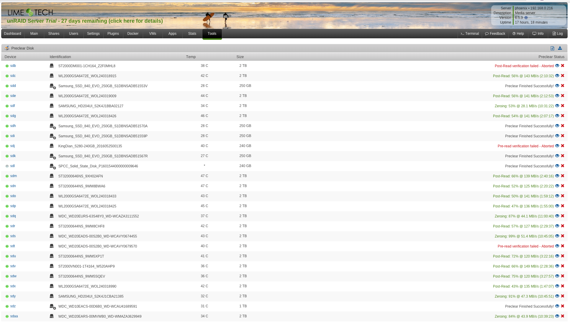

I have a collection of 20 various 2TB disks I have slowly been adding to over the last few years and expanding different storage server projects.  None of these have been heavily used by me, many were referb drives when I purchased them.
They've been in storage for about a year and a half while I built a new system and moved.
Finally building my new Unraid server (6.5.3)  I started to run the PreClear Script provided with the PreClear plugin from Community Applications
I was expecting a few of the disks to possibly have some bad sectors or even some with SMART errors warning of impending doom, but so far 9 out of the 20 2TB drives have failed to complete the precheck script.
3 failed during the Pre-read verification
and 6 failed so far Zeroing the disk.
11 of the tests still running
All the 2TB drives are connected via an IBM M1015 + HP SAS expander.
I've read through several posts about this preclear script and what its doing thinking I had missed something to explain at least some of these failures other than failing drives, but I'm coming up empty handed.
Before I toss hundreds of dollars in the bin and spend hundreds more to replace them does it appear from the logs all these drives have really gone bad?
I've attached the preclear log below.  I'll also attached the full diagnostic log once it finishes collecting the info (seems to be taking a while...)

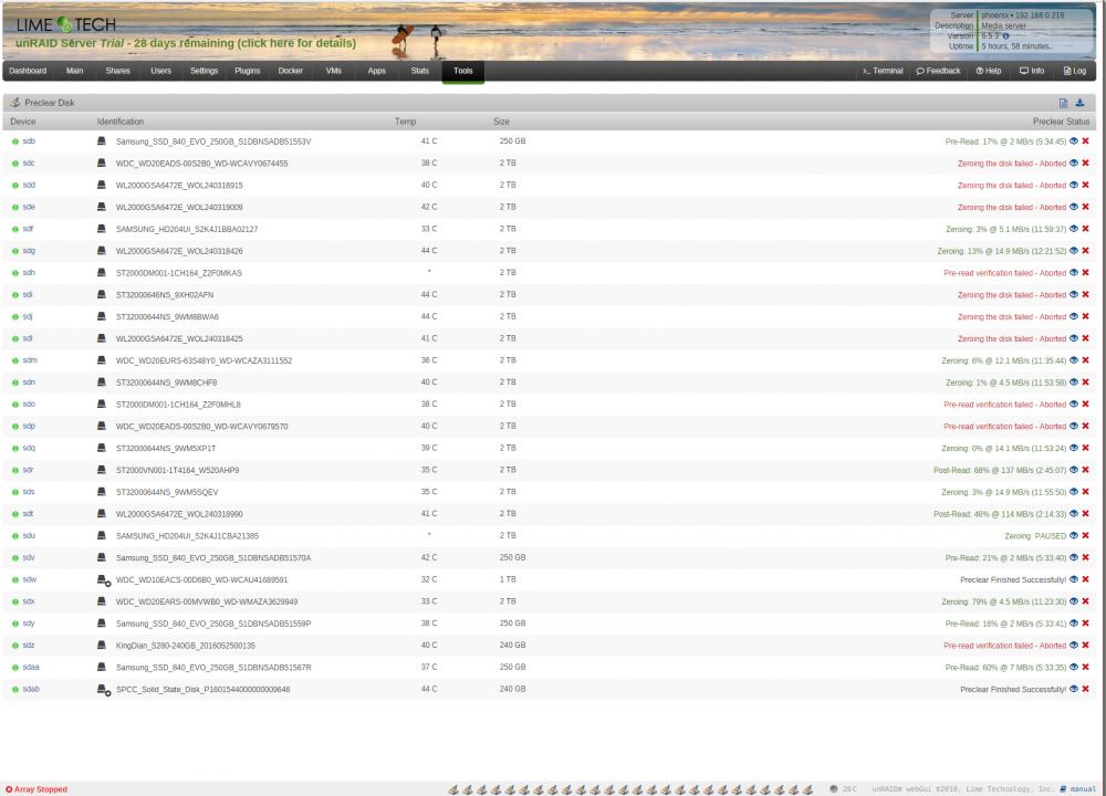

Starting Preclear on all the disks again now I'll post the logs when they complete or fail again.
I've noticed that the tests appears to be progressing much faster.
On the  2TB HDD's i'm seeing Pre-Read rates ~100 MB/s I'm fairly sure it was significantly less before this update.
Tests still running of course but I'll be sure to report back tomorrow evening when some finish.

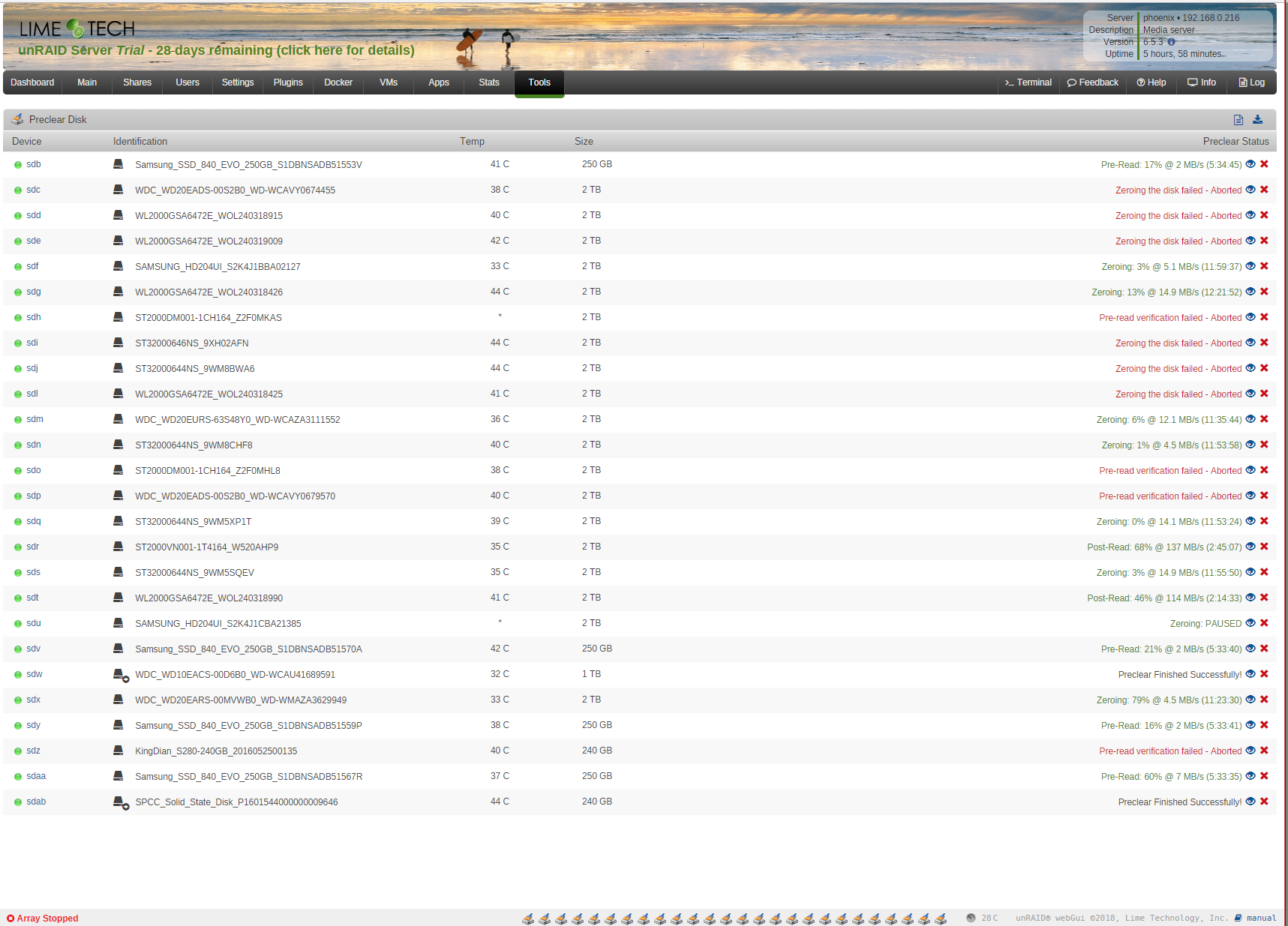

Tests are still rolling, they all seem to have gotten much farther, and in less time so far.  Posting a current screen shot and current logs
PHOENIX-preclear.disk-20180821-0957.zip
Hmm that is strange it looks like the device assignments changed though I'm sure I have made no hardware changes.
sdb was previously one of the Samsung EVO SSDs
and now its one of the 2TB HDDs (ST2000DM001-1CH164_Z2F0MHL8)
You should never make any assumptions about which sdX type device is assigned to which drive.   They are assigned dynamically by Linux during the boot process as they come online.   Therefore although they tend to stay the same this is not guaranteed.

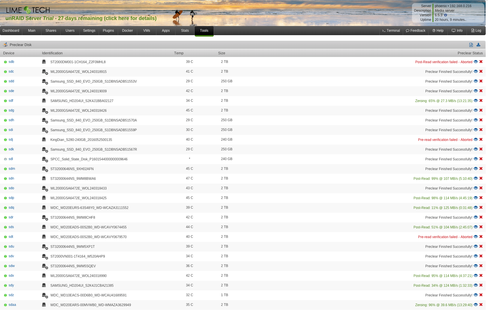

Thanks that makes sense.  I'll keep an eye on this today and post back as soon as the tests finish which looks like it will likely be sometime this evening.
You have probably 3 drives with read errors: WD-XXXXXXX79570, ST2000DM001-1CH164_XXXXXHL8 and KingDian_S280-240GB_XXXXXXXXX0135. Send me your diagnostics file to be sure.
ST2000DM001-1CH164_XXXXXHL8 have medium errors, please look at the disk S.M.A.R.T. to see if it's dying.
Aug 21 06:59:00 phoenix kernel: sd 17:0:0:0: [sdb] tag#30 UNKNOWN(0x2003) Result: hostbyte=0x00 driverbyte=0x08
Aug 21 06:59:00 phoenix kernel: sd 17:0:0:0: [sdb] tag#30 Sense Key : 0x3 [current]
Aug 21 06:59:00 phoenix kernel: sd 17:0:0:0: [sdb] tag#30 ASC=0x11 ASCQ=0x0
Aug 21 06:59:00 phoenix kernel: sd 17:0:0:0: [sdb] tag#30 CDB: opcode=0x28 28 00 22 dc 1b 38 00 00 08 00
Aug 21 06:59:00 phoenix kernel: print_req_error: critical medium error, dev sdb, sector 584850232
Aug 21 06:59:00 phoenix kernel: Buffer I/O error on dev sdb, logical block 73106279, async page read
KingDian S280-24 4B too have problems:
Aug 20 16:46:28 phoenix kernel: ata6.00: exception Emask 0x0 SAct 0x8000000 SErr 0x0 action 0x0
Aug 20 16:46:28 phoenix kernel: ata6.00: irq_stat 0x40000008
Aug 20 16:46:28 phoenix kernel: ata6.00: failed command: READ FPDMA QUEUED
Aug 20 16:46:28 phoenix kernel: ata6.00: cmd 60/40:d8:00:c4:79/05:00:01:00:00/40 tag 27 ncq dma 688128 in
Aug 20 16:46:28 phoenix kernel:         res 41/40:40:00:c4:79/00:05:01:00:00/40 Emask 0x409 (media error) <F>
Aug 20 16:46:28 phoenix kernel: ata6.00: status: { DRDY ERR }
Aug 20 16:46:28 phoenix kernel: ata6.00: error: { UNC }
Aug 20 16:46:28 phoenix kernel: ata6.00: configured for UDMA/133
Aug 20 16:46:28 phoenix kernel: sd 6:0:0:0: [sdj] tag#27 UNKNOWN(0x2003) Result: hostbyte=0x00 driverbyte=0x08
Aug 20 16:46:28 phoenix kernel: sd 6:0:0:0: [sdj] tag#27 Sense Key : 0x3 [current]
Aug 20 16:46:28 phoenix kernel: sd 6:0:0:0: [sdj] tag#27 ASC=0x11 ASCQ=0x4
Aug 20 16:46:28 phoenix kernel: sd 6:0:0:0: [sdj] tag#27 CDB: opcode=0x28 28 00 01 79 c4 00 00 05 40 00
Aug 20 16:46:28 phoenix kernel: print_req_error: I/O error, dev sdj, sector 24757248
Aug 20 16:46:28 phoenix kernel: ata6: EH complete
Same for  WDC WD20EADS-00S:
Aug 20 20:31:24 phoenix kernel: mpt2sas_cm0: log_info(0x31080000): originator(PL), code(0x08), sub_code(0x0000)
Aug 20 20:31:24 phoenix kernel: sd 17:0:13:0: [sdt] tag#2 UNKNOWN(0x2003) Result: hostbyte=0x00 driverbyte=0x08
Aug 20 20:31:24 phoenix kernel: sd 17:0:13:0: [sdt] tag#2 Sense Key : 0x3 [current]
Aug 20 20:31:24 phoenix kernel: sd 17:0:13:0: [sdt] tag#2 ASC=0x11 ASCQ=0x0
Aug 20 20:31:24 phoenix kernel: sd 17:0:13:0: [sdt] tag#2 CDB: opcode=0x28 28 00 92 d3 de 18 00 00 08 00
Aug 20 20:31:24 phoenix kernel: print_req_error: critical medium error, dev sdt, sector 2463358488
Aug 20 20:31:24 phoenix kernel: Buffer I/O error on dev sdt, logical block 307919811, async page read
Thank you thank you thank you!
Seeing those examples will give me a much better idea what to look for myself.
So far all but 8 of the 26 drives have finished.
And so far all the rest look good.
