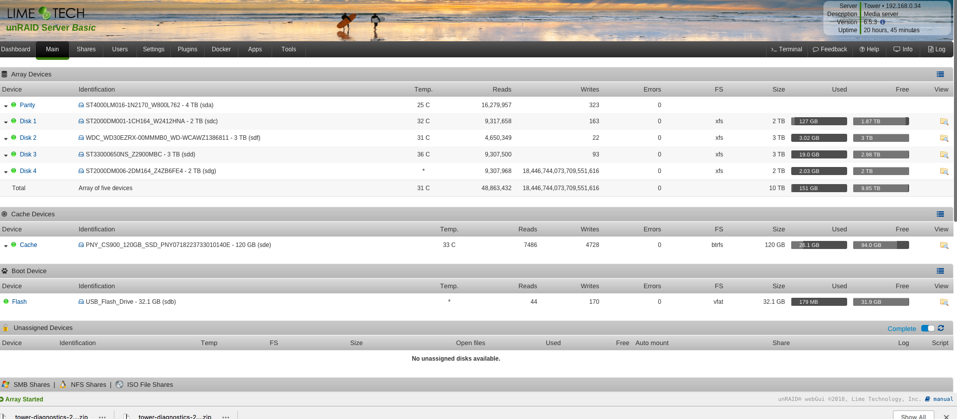

I checked in a little later and I see this !! [Screenshot attached] What the holy hell? I have not done a thing. I have not stopped the array, rebooted nothing. I just snapped the screenshot and pulled a diag. The disk that is showing these reads is a brand new Barracuda drive 2TB that went from wrapper to box. [No, I did not pre-clear it.]
I have not rebooted since my last update either.
Sorry to be a pest but I am truly stumped

In order to rebuild disk4 of course it had to rewrite the entire disk.
You are getting some of these on that port though:
Aug 23 08:09:22 Tower kernel: ata4: exception Emask 0x10 SAct 0x0 SErr 0x40c0000 action 0xe frozen
Aug 23 08:09:22 Tower kernel: ata4: irq_stat 0x00000040, connection status changed
Aug 23 08:09:22 Tower kernel: ata4: SError: { CommWake 10B8B DevExch }
Aug 23 08:09:22 Tower kernel: ata4: limiting SATA link speed to 1.5 Gbps
Aug 23 08:09:22 Tower kernel: ata4: hard resetting link
Aug 23 08:09:24 Tower kernel: ata4: SATA link down (SStatus 0 SControl 310)
Aug 23 08:09:24 Tower kernel: ata4: EH complete
