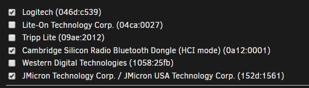

Thank you for the reply @SpaceInvaderOne , and before I started just wanted to let you know that your videos have helped tremendously till this point. So, as you requested I disabled VFIO allow unsafe interrupts and PCIe ACS override and rebooted the server. Here are the IOMMU Groups. For ease of view and to save time for you I went ahead and highlighted the GPU and the USB hub I'm working with.
IOMMU group 0:[8086:0e00] 00:00.0 Host bridge: Intel Corporation Xeon E7 v2/Xeon E5 v2/Core i7 DMI2 (rev 04)
IOMMU group 1:[8086:0e02] 00:01.0 PCI bridge: Intel Corporation Xeon E7 v2/Xeon E5 v2/Core i7 PCI Express Root Port 1a (rev 04)
IOMMU group 2:[8086:0e03] 00:01.1 PCI bridge: Intel Corporation Xeon E7 v2/Xeon E5 v2/Core i7 PCI Express Root Port 1b (rev 04)
IOMMU group 3:[8086:0e04] 00:02.0 PCI bridge: Intel Corporation Xeon E7 v2/Xeon E5 v2/Core i7 PCI Express Root Port 2a (rev 04)
IOMMU group 4:[8086:0e06] 00:02.2 PCI bridge: Intel Corporation Xeon E7 v2/Xeon E5 v2/Core i7 PCI Express Root Port 2c (rev 04)
IOMMU group 5:[8086:0e08] 00:03.0 PCI bridge: Intel Corporation Xeon E7 v2/Xeon E5 v2/Core i7 PCI Express Root Port 3a (rev 04)
IOMMU group 6:[8086:0e20] 00:04.0 System peripheral: Intel Corporation Xeon E7 v2/Xeon E5 v2/Core i7 Crystal Beach DMA Channel 0 (rev 04)
[8086:0e21] 00:04.1 System peripheral: Intel Corporation Xeon E7 v2/Xeon E5 v2/Core i7 Crystal Beach DMA Channel 1 (rev 04)
[8086:0e22] 00:04.2 System peripheral: Intel Corporation Xeon E7 v2/Xeon E5 v2/Core i7 Crystal Beach DMA Channel 2 (rev 04)
[8086:0e23] 00:04.3 System peripheral: Intel Corporation Xeon E7 v2/Xeon E5 v2/Core i7 Crystal Beach DMA Channel 3 (rev 04)
[8086:0e24] 00:04.4 System peripheral: Intel Corporation Xeon E7 v2/Xeon E5 v2/Core i7 Crystal Beach DMA Channel 4 (rev 04)
[8086:0e25] 00:04.5 System peripheral: Intel Corporation Xeon E7 v2/Xeon E5 v2/Core i7 Crystal Beach DMA Channel 5 (rev 04)
[8086:0e26] 00:04.6 System peripheral: Intel Corporation Xeon E7 v2/Xeon E5 v2/Core i7 Crystal Beach DMA Channel 6 (rev 04)
[8086:0e27] 00:04.7 System peripheral: Intel Corporation Xeon E7 v2/Xeon E5 v2/Core i7 Crystal Beach DMA Channel 7 (rev 04)
IOMMU group 7:[8086:0e28] 00:05.0 System peripheral: Intel Corporation Xeon E7 v2/Xeon E5 v2/Core i7 VTd/Memory Map/Misc (rev 04)
[8086:0e2a] 00:05.2 System peripheral: Intel Corporation Xeon E7 v2/Xeon E5 v2/Core i7 IIO RAS (rev 04)
[8086:0e2c] 00:05.4 PIC: Intel Corporation Xeon E7 v2/Xeon E5 v2/Core i7 IOAPIC (rev 04)
IOMMU group 8:[8086:1d3e] 00:11.0 PCI bridge: Intel Corporation C600/X79 series chipset PCI Express Virtual Root Port (rev 06)
IOMMU group 9:[8086:1d3a] 00:16.0 Communication controller: Intel Corporation C600/X79 series chipset MEI Controller #1 (rev 05)
[8086:1d3b] 00:16.1 Communication controller: Intel Corporation C600/X79 series chipset MEI Controller #2 (rev 05)
IOMMU group 10:[8086:1d2d] 00:1a.0 USB controller: Intel Corporation C600/X79 series chipset USB2 Enhanced Host Controller #2 (rev 06)
IOMMU group 11:[8086:1d10] 00:1c.0 PCI bridge: Intel Corporation C600/X79 series chipset PCI Express Root Port 1 (rev b6)
IOMMU group 12:[8086:1d1a] 00:1c.5 PCI bridge: Intel Corporation C600/X79 series chipset PCI Express Root Port 6 (rev b6)
IOMMU group 13:[8086:1d1e] 00:1c.7 PCI bridge: Intel Corporation C600/X79 series chipset PCI Express Root Port 8 (rev b6)
IOMMU group 14:[8086:1d26] 00:1d.0 USB controller: Intel Corporation C600/X79 series chipset USB2 Enhanced Host Controller #1 (rev 06)
IOMMU group 15:[8086:244e] 00:1e.0 PCI bridge: Intel Corporation 82801 PCI Bridge (rev a6)
IOMMU group 16:[8086:1d41] 00:1f.0 ISA bridge: Intel Corporation C600/X79 series chipset LPC Controller (rev 06)
[8086:1d02] 00:1f.2 SATA controller: Intel Corporation C600/X79 series chipset 6-Port SATA AHCI Controller (rev 06)
[8086:1d22] 00:1f.3 SMBus: Intel Corporation C600/X79 series chipset SMBus Host Controller (rev 06)
[8086:1d24] 00:1f.6 Signal processing controller: Intel Corporation C600/X79 series chipset Thermal Management Controller (rev 06)
IOMMU group 17:[1000:0072] 02:00.0 Serial Attached SCSI controller: LSI Logic / Symbios Logic SAS2008 PCI-Express Fusion-MPT SAS-2 [Falcon] (rev 03)
IOMMU group 18:[126f:2262] 03:00.0 Non-Volatile memory controller: Silicon Motion, Inc. Device 2262 (rev 03)
IOMMU group 19:[10de:1b80] 05:00.0 VGA compatible controller: NVIDIA Corporation GP104 [GeForce GTX 1080] (rev a1)
[10de:10f0] 05:00.1 Audio device: NVIDIA Corporation GP104 High Definition Audio Controller (rev a1)
IOMMU group 20:[8086:1528] 07:00.0 Ethernet controller: Intel Corporation Ethernet Controller 10-Gigabit X540-AT2 (rev 01)

@SpaceInvaderOne Alright so here's what I've done, instead of passing through the entire PCI USB controller it allowed me to pass through single devices that I had on the controller.
First I rebooted the server, then before starting the VM I plugged in said single devices. I then went to the VM and selected the devices and saved and started.
 In 6.5.3 I wasn't able to do that, so since then there must have been updates allowing the devices to be passed through like that. I have since rebooted with no crashing of the server BUT I did get this error during the reboot.
libusb: error [udev_hotplug_event] ignoring udev action bind
Although this error happened and it took a bit longer to reboot it seems to be working without any other ill effects.
I'm thinking it might be that bluetooth dongle?
Edited by slimshizn
Well although I was able to pass the external SSD through and it works, the USB Dongle and the Bluetooth Dongle both are not working in this configuration so that is a shame.

So far I've done a few restarts without the entire hub being passed through, and haven't had the problem. I'm still testing out what to do with the usb devices I want to pass through.

Had a call trace today after trying to reboot the VM. The WebGUI is not accessible and I can not SSH in.
So I force rebooted and started the parity sync. I changed some things around. I kept the usb 3.0 external SSD on the usb hub, moved the bluetooth dongle and wireless mouse dongle to usb 2.0 ports and moved a few things around to make it work. Started it up and haven't seen an error or usb disconnect since. I'll see how this works for a while and in the meantime look for a different USB hub.
  • 9 months later...
Did you ever find a solution for the problem?
I've removed the hub and don't use anything extra on the VM other than the gtx 1080. When I shut it down it still causes a crash so I"m not really sure what to do. I just live with it pretty much which is shitty.
