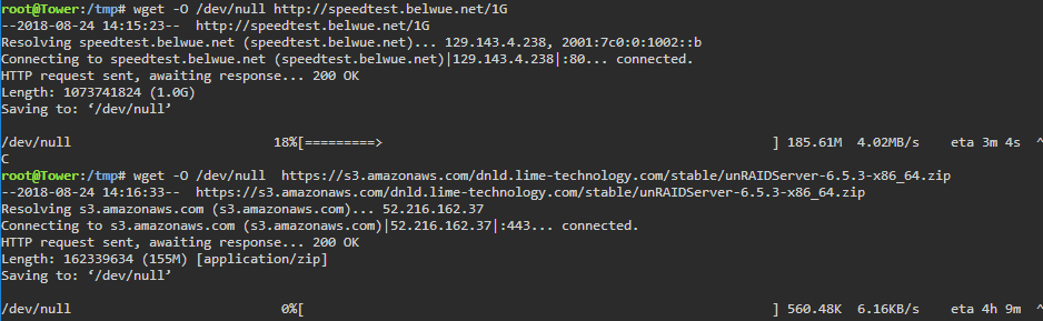

I have the problem that I cannot install updates from unraid at the moment (6.5.3-rc1 to stable 6.5.3). If I go to "Update OS", the update loads several hours until the download is timed out. I have already done this several times (over several weeks), each with the same result. I have a 52Mbit/s Internet line. The download should only take a few seconds / minutes. What could be the reason for this?
If I download a sample file from another server via the terminal (wget), the download speed is significantly higher than if I download the unraid update.

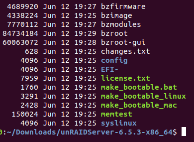

Which files do I have to copy? I can't see .bz files.
bzfirmware
bzimage
bzmodules
bzroot
bzroot-gui
At least that's what I see looking at your screenshot.
Those are the files to be copied.  You should be notified and (most likely) asked for permission to overwrite them.  You will have to agree to do the update.
