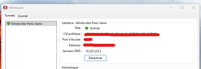

Don't see anything wrong with the docker run command.
Perhaps it is the Wireguard file itself.
Please download a wireguard client for your PC and see if connecting works properly that way.
https://www.wireguard.com/install/
Yes, it works without a hitch.
Edited by Alex.b

I'm also unable to get it to work.
After enabling wireguard, the log file is not updated anything, the log and console windows disappear immediately.
I have tried the wg0.conf file on another machine, works flawlessly. I can't even tell you anything more as there is nothing in the logs...

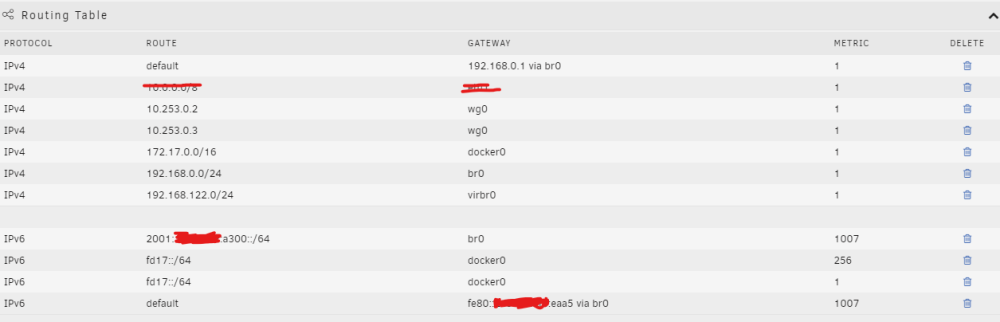

ok, I ran docker update --restart=no jackettvpn and I was able to pull this
[#] ip link add wg0 type wireguard
[#] wg setconf wg0 /dev/fd/63
[#] ip -4 address add 10.6.0.14/24 dev wg0
[#] ip link set mtu 1420 up dev wg0
[#] resolvconf -a wg0 -m 0 -x
[#] wg set wg0 fwmark 51820
[#] ip -6 route add ::/0 dev wg0 table 51820
Error: IPv6 is disabled on nexthop device.
[#] resolvconf -d wg0 -f
[#] ip link delete dev wg0
dos2unix: converting file /config/wireguard/wg0.conf to Unix format...
Warning: `/config/wireguard/wg0.conf' is world accessible
