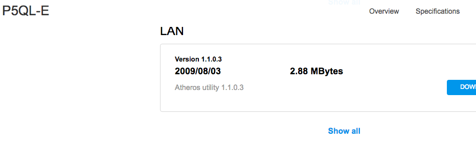

The support page for that motherboard doesn't specify the NIC chip used but if you go to the downloads page there is this:
So if it looks like a duck and quacks like a duck...

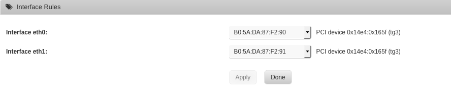

Unraid didn't want to use eth1 as eth0, it was a real struggle.
It's actually very easy. eth0 and eth1 and just labels. The thing that properly identifies a NIC is its MAC address. On the Settings -> Network Settings page there's a section called Interface Rules near the bottom. There you can choose which MAC address is associated with which eth label. But disabling your onboard NIC in the BIOS served the purpose.
