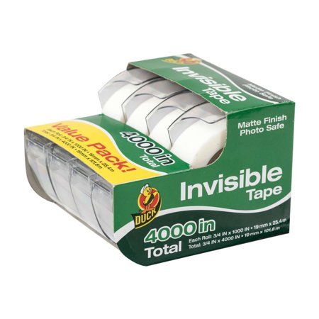

However, if you're impatient like myself, you wonder if Scotch Tape works.
I am here to tell you it worked flawlessly for me.
I used Duck Brand Invisible Tape (from Walmart) and followed the above guide.
I had zero issues with temperature.
In fact, I rebuilt my entire parity using this method, and ran my sever for several days with NO problems.
Removal of the tape was a cakewalk. No residue or anything; make sure to use the under side so you don't scratch the pins up.
