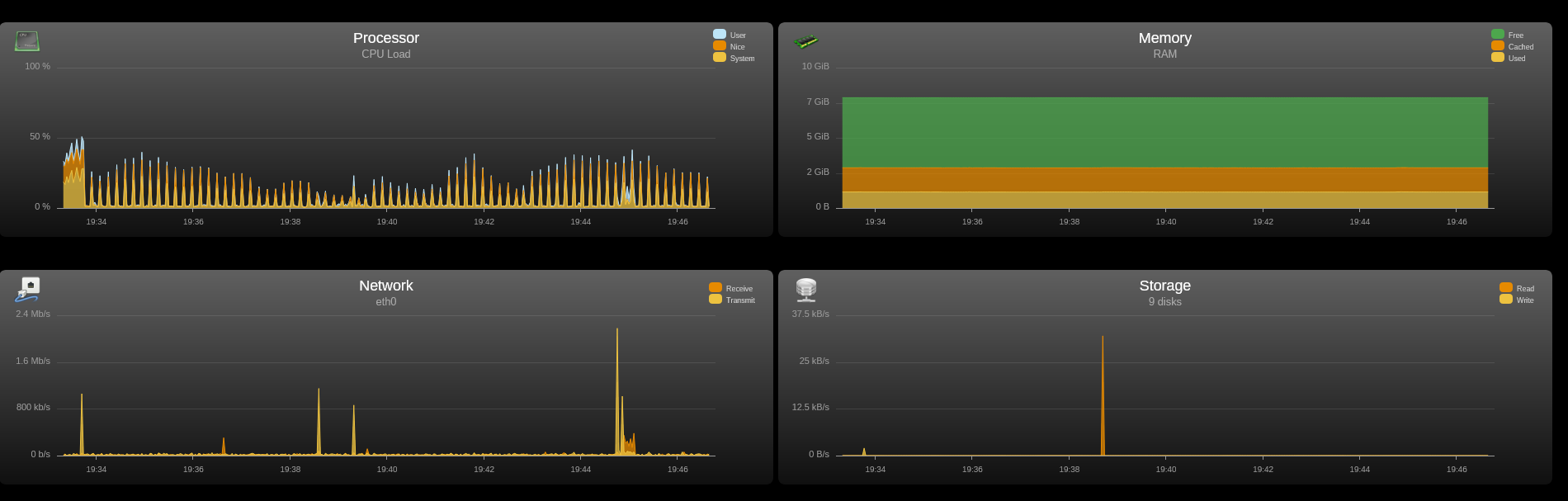

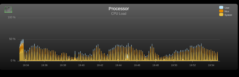

Today I woke up to oddly CPU spikes inside the Stats. Every 10 Seconds there is a Spike of 30-50%.  After a lot of fiddeling I found out that the Dynamix Folder Caching was to blame. I couldn't remeber that something like that appeared before but in my opinion I changed nothing that should affect the CPU in this ways. I didn't even change the settings for Folder Caching itself.

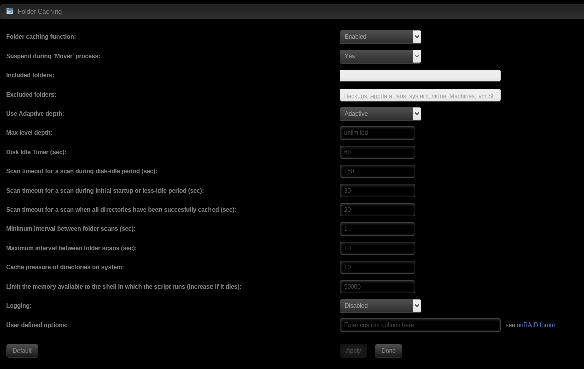

Now I'm quite desperate. A Screen on how my CPU Usage looks the second I turn on the Folder Caching is attached. In the beginning you can see the initial scan.  On the Second Screen you can see my Settings inside the Folder Caching App. Today I excluded some of my Shares but this helped little. only when I include just 1 or 2 the spikes apear smaller. The Update which arrived  today added quite a lot of additional Settings but the Problem persists. I found another Post with the same Problem here in the Forum with the Tag Solved

Yes the new Version 2018.08.27a  was released today but sadly this changed nothing on the cpu spike side.
All the Screens you can see are with Version 2018.08.27a  and with the Settings from the 3rd Screenshot

The new version allows to set a level depth, in case a folder structure is deeply nested, in this case it might help to limit the scan depth.
Do you have any folders with lots of files and/or levels which are included? Try to exclude them, and see if that makes a difference.
Yes its possible that such directorys exist (Project Folders of Java or Android apps come here to mind for me) but nothing deeper than a NTFS Partition could handle. This Files and Directorys also existed before. Every Backup/Docker Folder or VM folder is already excluded.

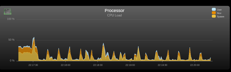

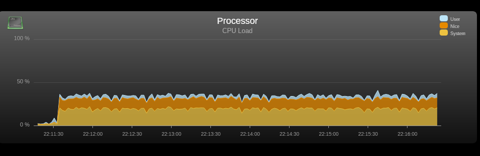

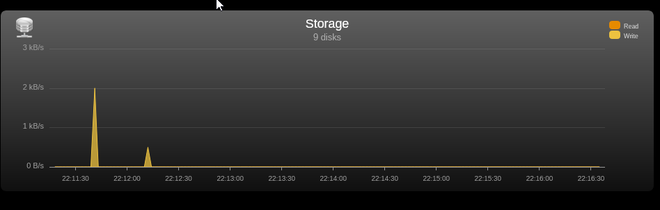

If I try to set the "Use Adaptive depth" to "Fixed" and set a relativly low level like "7" (everything else is empty so default) then I see a constant Load of 30-60% on my CPU for minutes after minutes. Not even the Timeouts seem to work for me. If I read the settings right the longest would be " Scan timeout for a scan during disk-idle period (sec): " but the default says it is only maximal 150 sec.  At the Screenshot it ran for 5 Minutes straight.
If I just add my Video share which has a max depth of ~8-10 with all settings back to default then the spikes are still there...
I don't think that such a depth should be a problem in any way...  On the end of this CPU activity the Disks spun down so no activity on these for the whole time right after Caching activation.
