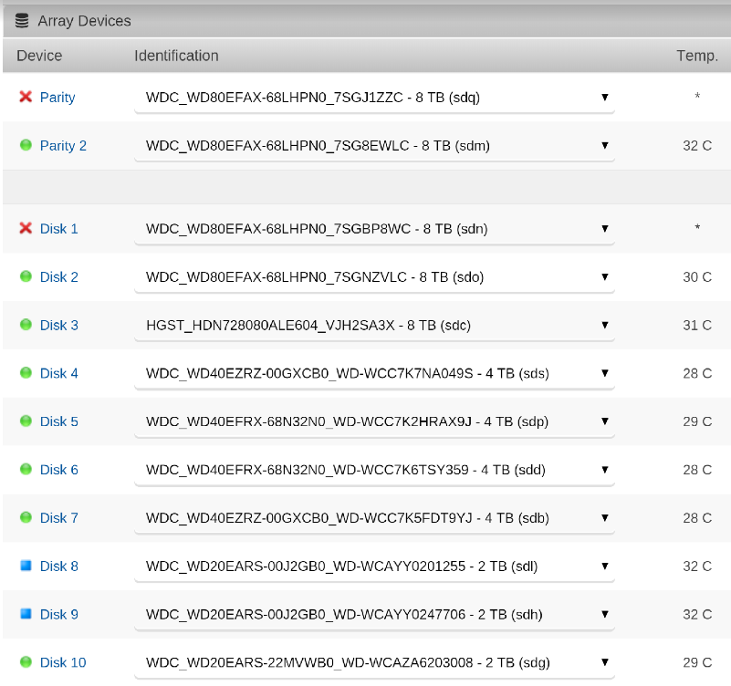

To save us some time digging through the diagnostics with so many disks, and save yourself the time typing in even more details. just post a screenshot of Main - Array Devices.

Here's a shot of the main page with the problem drives...
Disk 8 and 9 were the two I tried to replace before I had an issue with the other two.

There are several more disks that don't appear in the screenshot but I assume those are indicating green.
Disks 8,9 don't even appear in the diagnostics. Parity and disk1 SMART look OK.
