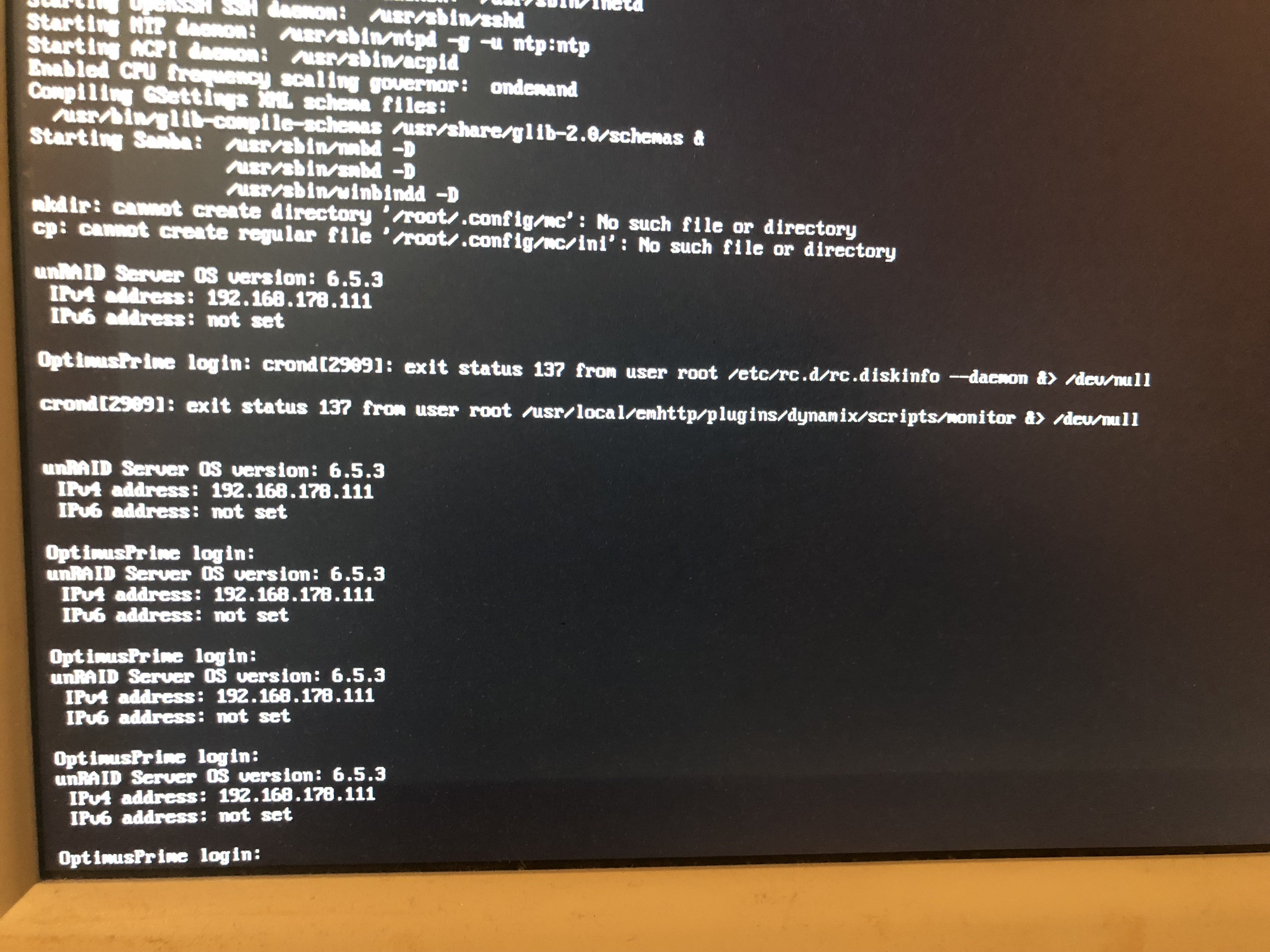

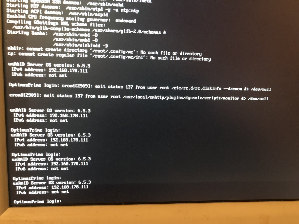

On the local screen this time there was the following Lines (also see picture attached).
crond[2909]: exit status 137 from user root /etc/rc.d/rc.diskinfo --daemon &> /dev/null
crond[2909]: exit status 137 from user root /usr/local/emhttp/plugins/dynamixs/scripts/monitor &> /dev/null
Can anyone tell me what that means and what the logfiles say this time?!
When I search for that error I find another thread here, that has the same issue but never was solved. The only similarity I see is that I also have the UnifiController-Docker running.
