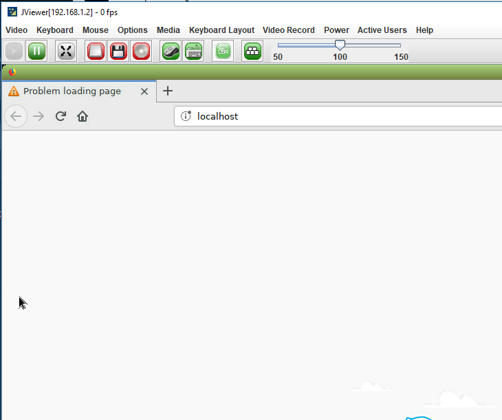

When accessing the GUI I can't connect to localhost, even, so I can't get in to tools and pull any logs. There doesn't seem to be anything available of that nature from the "start" menu either. (see unraid1 attached)

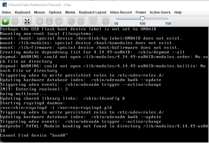

On booting the terminal complains about the device not having device label "UNRAID", which it does. But more crucially, it seems like it's missing network drivers or something. Almost missed it because it went by so fast during boot-up. See unraid2.png attached.
I'll try and remake a flash drive and see if that changes anything in the interim, unless anyone comes up with a bright idea. It really looks like it's having network connectivity issues. I tried rebooting using only one connected NIC and it didn't change anything.

Your USB device isn't properly prepared and loading of the critical files failed.
The "hint" that the label UNRAID isn't found, is already an indication that the USB device is somehow wrong.

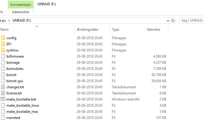

Stick prepared with https://unraid.net/download windows creation tool. Re-creating (again) and trying a different port now. Picture of USB as it's created in attached image.

It's been freshly wiped using Low Level Format Tool. 4GB Verbatim stick, so not much room for multiple partitions, so no. I edited my post to include an image of how it looks now, if it helps.
First time, yes. This time, no. Will try again with running it and see if it does anything. If not, I'll try the manual route. Forgot to mention, it failed with the same issue.
edit #2: Failed again after running make bootable - but it booted from it just fine using the windows creation tool. I am going to create one manually now using the .zip and make bootable.
Edit #3: Issue persists on manual creation attempt.

An alternative is that the USB drive gets disconnected a short while during the boot process (making the machine fail to see any volume UNRAID) and then gets connected after the startup code have already failed to mount the USB.
Lots of the required files are on the USB drive. Some of that content is picked up by the BIOS + boot loader on initial boot. But after Linux has started, the volume UNRAID must be found so the startup script can mount the USB drive and so get access to the rest of the files. So it isn't too far off to describe what you get as a system without drivers.
Do you see any UNRAID volume after the system has booted? In that case, it's likely to be an issue with disconnecting USB drive and you should try with a different port. If you don't see any volume named UNRAID in the directory /dev/disk/by-label, then it's likely that you for some reason hasn't managed to make the thumb drive correctly.
