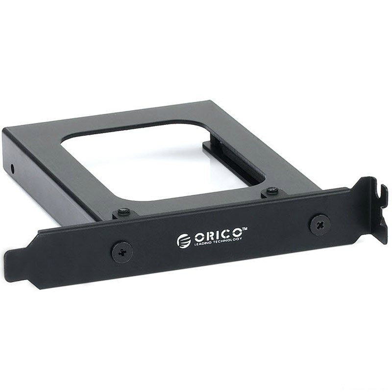

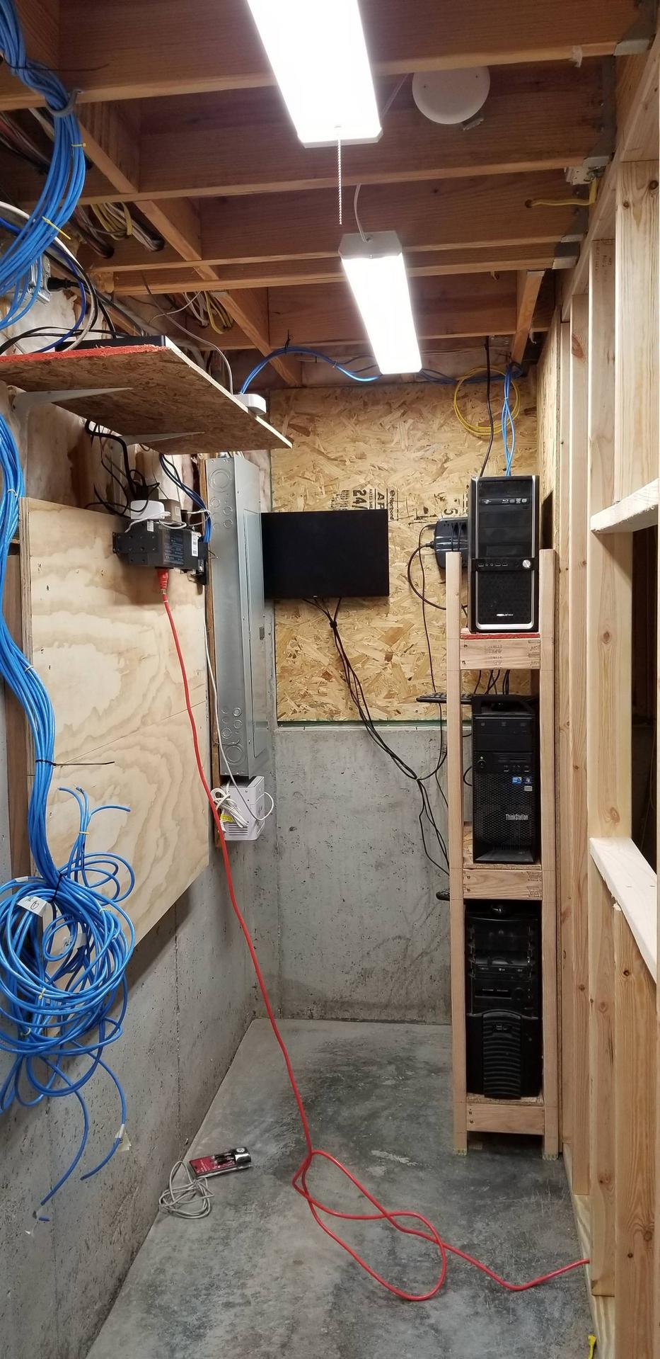

My UnRaid uses a used Antec 1200 V3 case, found local. I also sourced a beat up Antec 900 case on the cheap, via Ebay for additional bays + fans. I am now keeping an eye  out for a second Antec 1200 V3, and plan to stack them vertically, as such, for 24 bays.  A ssd will reside in an Origen pci ssd bracket,  to avoid taking up any drive bay storage.  I am starting out with 6 WD 8 TB EasyStore shucked drives plus a 2 TB and 3 TB pair of Seagate drives, that resided in my previous desktop.
