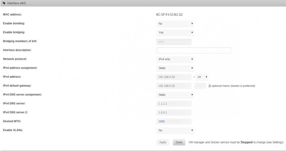

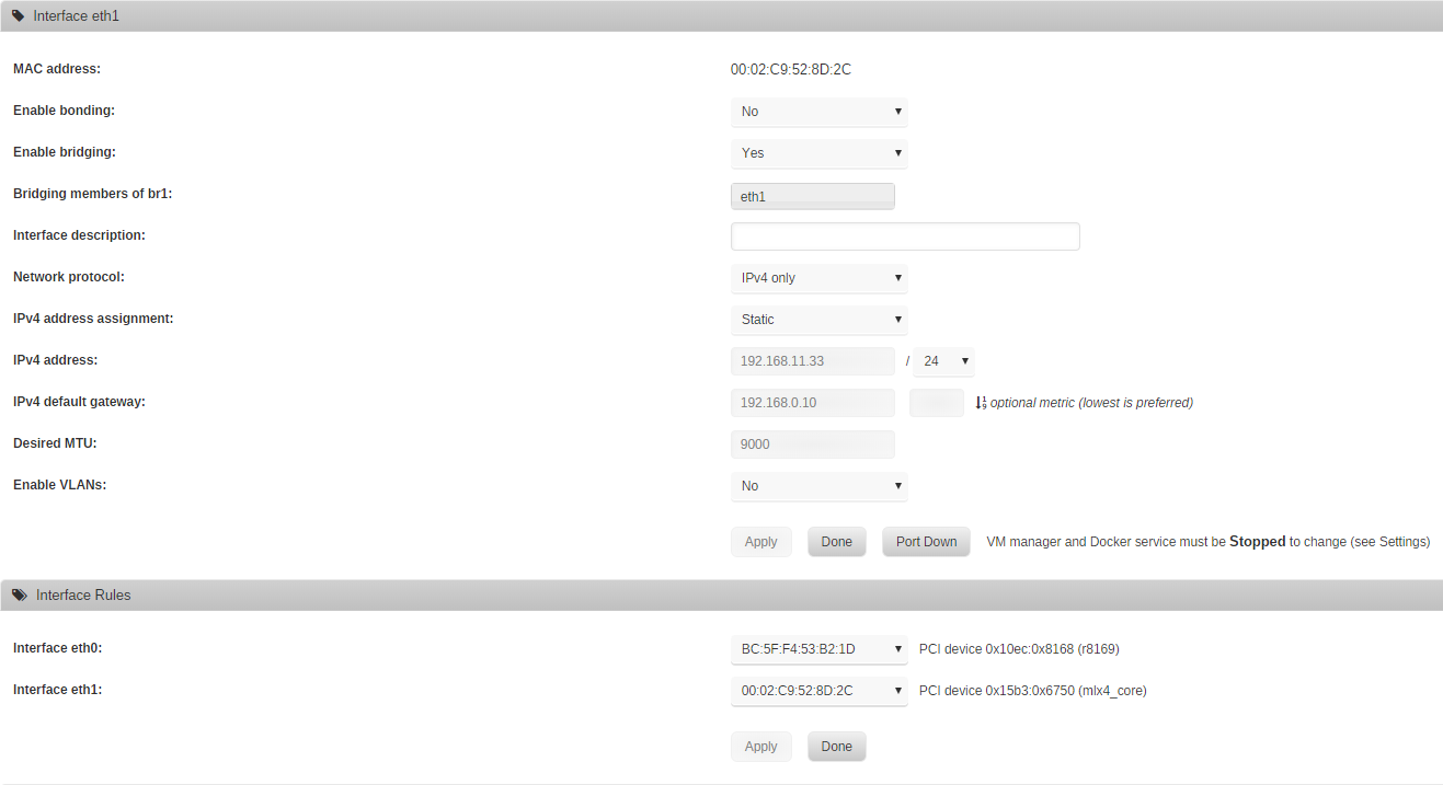

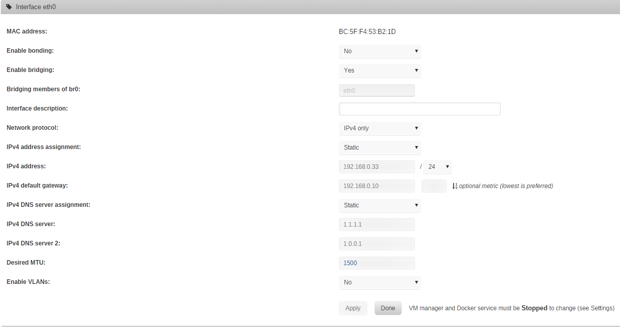

below are screenshots of my network config in unRAID, can anyone see anything that could be causing this please?
Your default gateway on interface eth1 must be in the same subnet as the interface, e.g. default gateway = 192.168.11.10
Your router must be configured with this additional IP address, and is the device which routes(!) traffic between the two subnets 192.168.0.x and 192.168.11.x
If eth1 is a direct 10GB link with your desktop, then there is no gateway on that interface.
so keep the gateway entry blank.

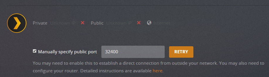

Still having a nightmare with this.. made the changes as mention and still getting all these timeout errors.  Plex keeps oming online, going offline, server settings are sometimes available in Plex most of the time I get "Server Settings Are Unavailable"  so frustrating!
I don't know why Plex is looking at 192.168.11.33?  My Server is in host mode running on 192.168.0.33

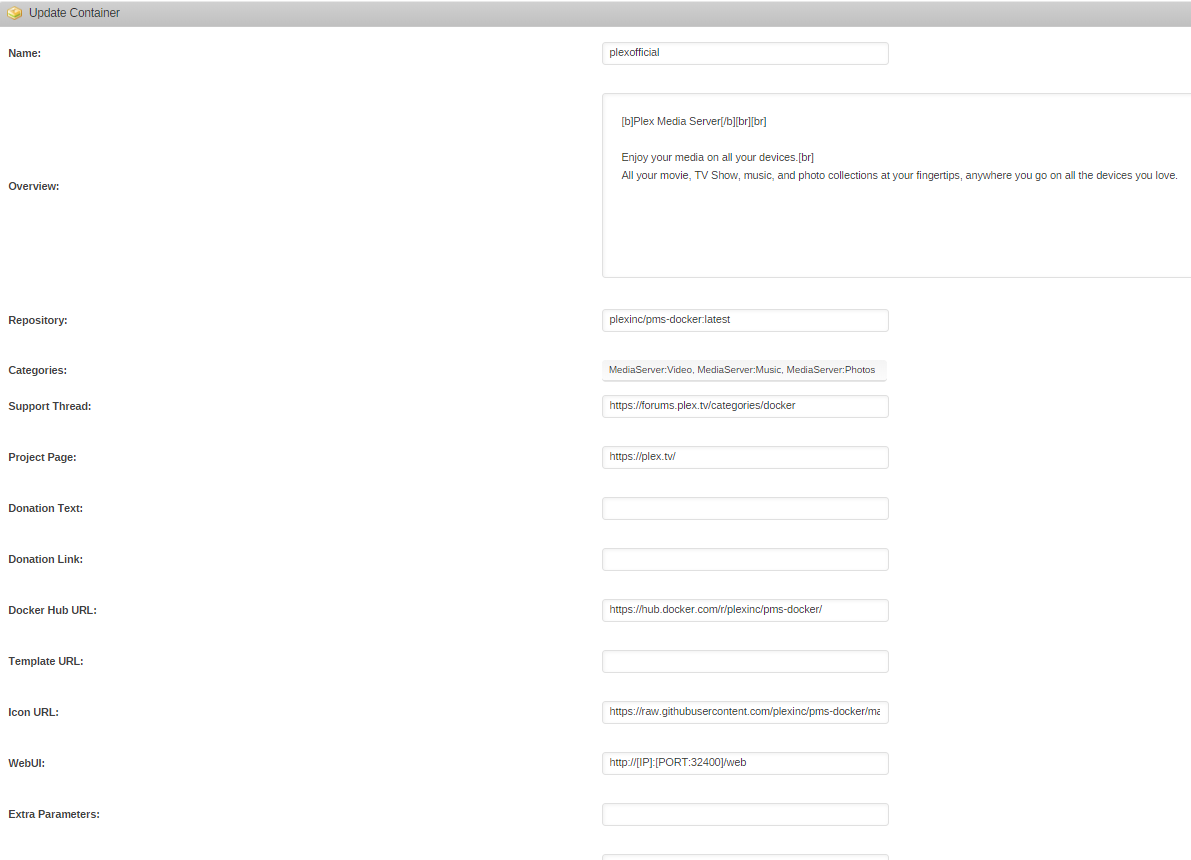

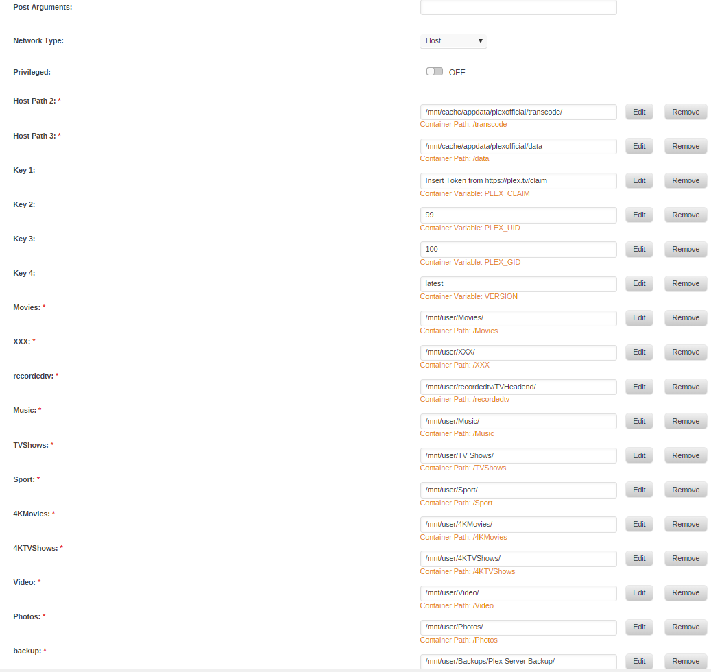

how is plex installed via docker or plug-in, post that config.
Edited by ijuarez
engrish

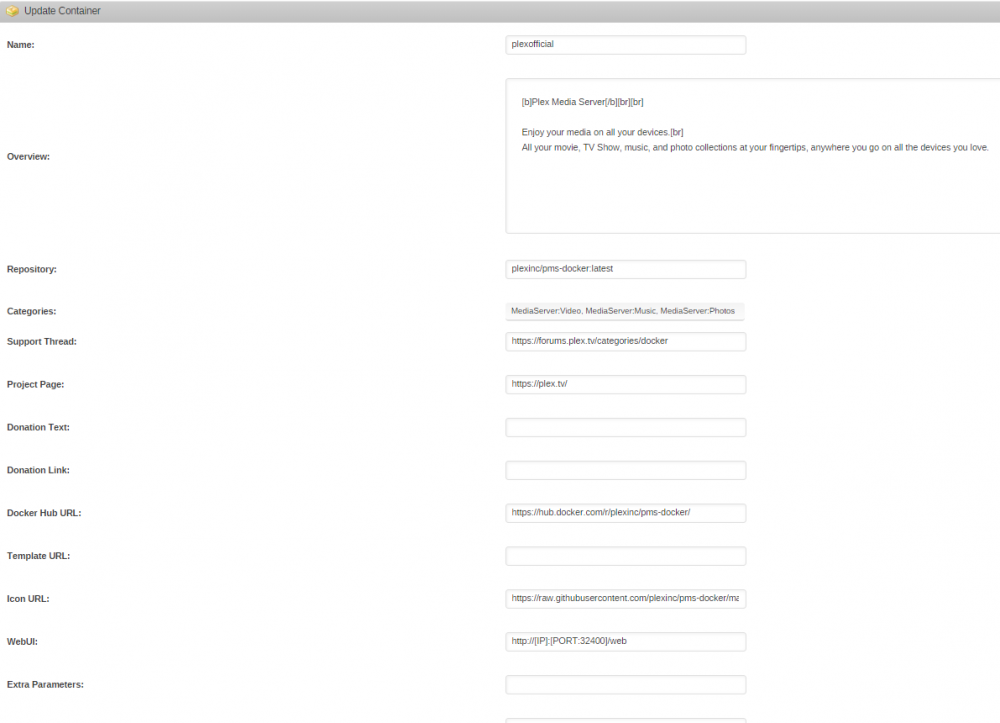

Hi I have tried BinHex, LinuxServerio & Now Plex (Official) Dockers (Which I am running now.
These configs are with the 10Gbe Card removed and everything running as it used to!
Have restarted & updated the Plex Docker 4 times now and every time Plex is instantly back up and running! (this was taking over an hour each time and even then would be intermittant) so removing the card has 100% fixed the issue BUT as I said previously this card has been installed for a while now without issue, something must have changed (probably me!) that caused Plex to start seeing the other network?

Make sure your new card is NOT set as eth0. See settings -> Network Settings -> Interface Rules
Hi, no it is not? cannot find interface rules but if you check my first post you can see screenshots of my network settings

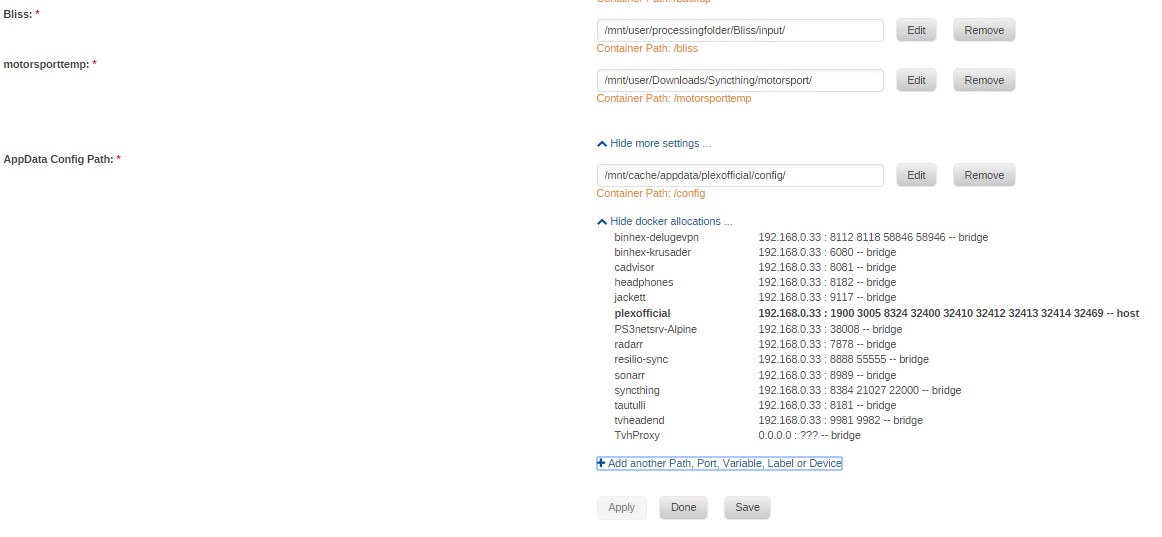

If you are setting the Plex container to host mode, it will be able to see both interfaces. and since I don't use Plex, I don't know if it can properly work with both interfaces.
Personally, I would set the Plex container in either bridge mode (and port map) which implies eth0 usage or a custom docker network on eth0, which however prevents unRAID and other bridge/host mode containers from talking to it. Then, Plex would be available on the unRAID IP, which you should be using on your PC to access (rather than the 10Gbe one)
This is based on your comment that the direct 10GBe connection is purely for uploading/management of the unRAID shares
I tried bridge mode a few days ago but could find no way of mapping the ports?
I am wondering if I setup the Plex Docker to Custom br1 (10Gbe Card) is there any way I can get internet to that connection?
Currently the 10Gbe Card is a single connection between my Desktop and unRAID server with no internet access.
I cannot find a way to make it work in Bridge mode as I cannot find a way to port map?
