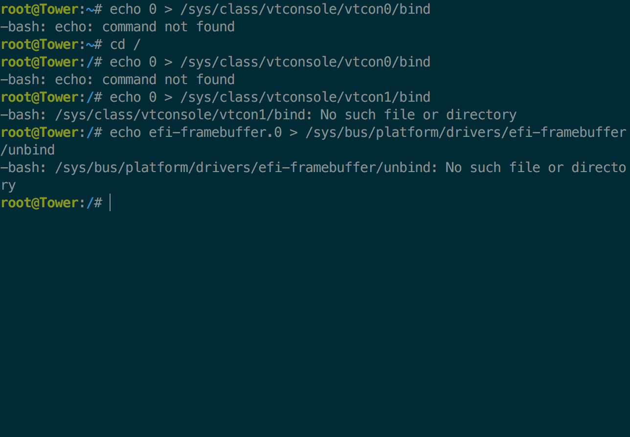

I am a newbie to unraid,
can anybody help?
Is your 1050Ti the primary GPU? If so turn off VM. Try these commands from ssh and then start VM and see how it goes.
echo 0 > /sys/class/vtconsole/vtcon0/bind
echo 0 > /sys/class/vtconsole/vtcon1/bind
echo efi-framebuffer.0 > /sys/bus/platform/drivers/efi-framebuffer/unbind
Also:
  • Post screenshot of your VM set up
  • How did u do your vbios file?
Also:
Ok so now I have the infamous code 43. The nvidia driver installer says it was able to  install the drivers. but I still get the error and my resolution is still maxed at 800X600. Any ideas.
I think you turned off Hyper V. I have had better luck with it on for 10 series Nvidia.
Nevermind it magically works now.
