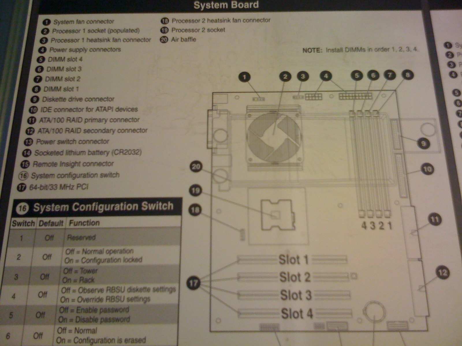

Connect the CF-IDE adapter to the "10" on the first picture, select the jumper as master and try to change the setting to boot from this.

I tried. The problem is, that I have only three entries on screen 3. PCI embedded seems to be the number 11/12 on the first screen. PCI Slot 1 and 2 are the Promise SATA300 TX4.
I can choose C: and CD-ROM in the boot chain, but the system wouldn't boot from the card. Nevertheless I connected a CD-ROM to the IDE port "10" and installed FreeNAS to the hard disc which was connected to the SATA300 TX4.
I don't get it. How can I tell this stupid box, that it should boot from the CF card??

After 3 hours of testing it finally works. I changed the cable and connected the CF adapter to the first RAID port.

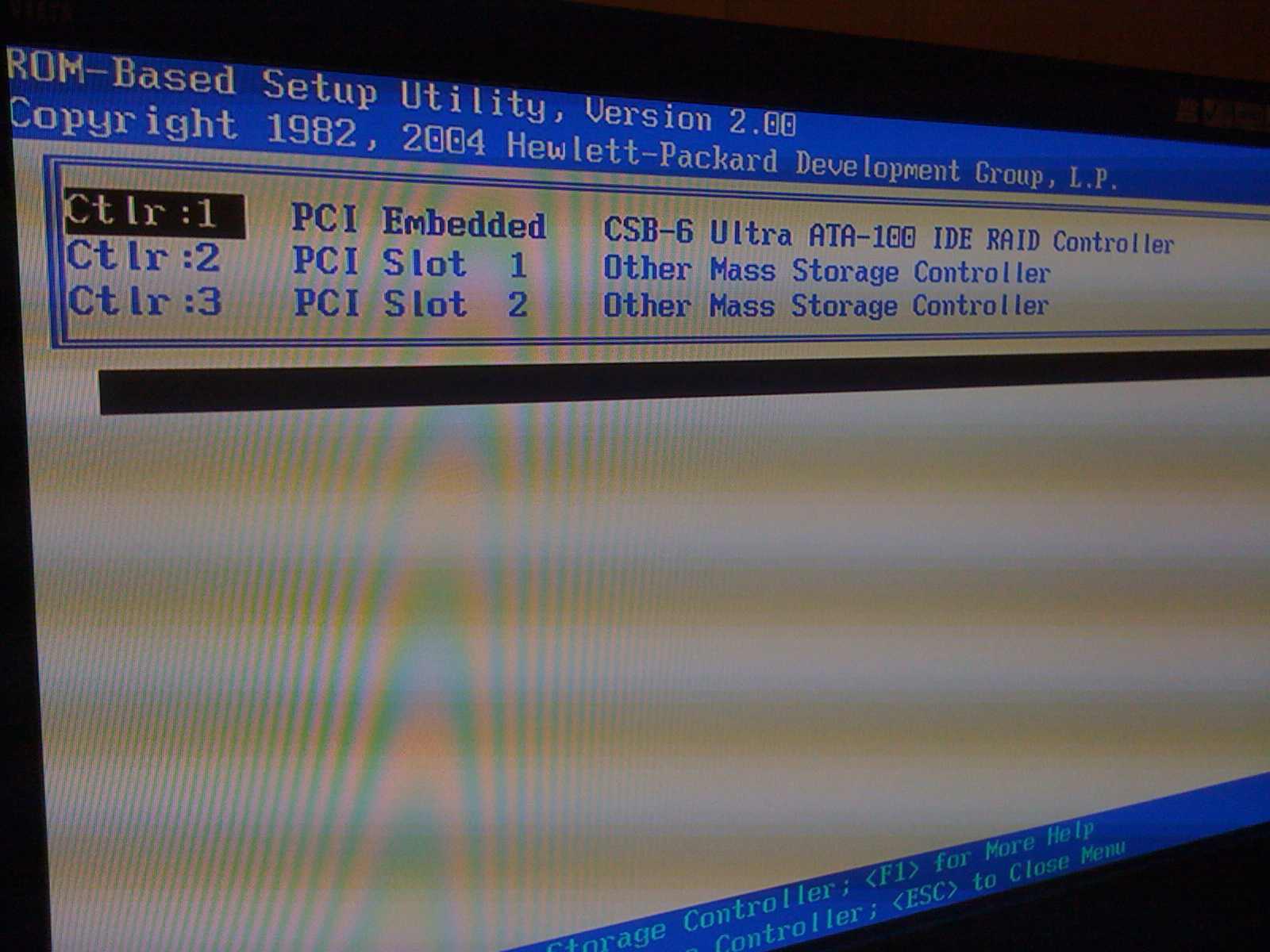

The boot controller order is:
1. CSB-6 Ultra ATA-100 IDE RAID controller (which is the on board IDE controller)
2. Other mass storage controller (Promise SATA300 TX4 I asume)
3. Other mass storage controller (Promise SATA300 TX4 I asume)

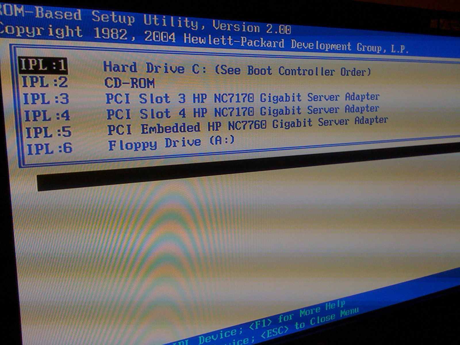

Standard boot order:
1. CD-ROM
2. HD C: (See boot controller order)
3. Floppy A:
4. PCI embedded Gigabit Server adapter
So far I understand the CF-card should boot before the SATA drive which is connected to the SATA300 TX4.
I found some threads in the internet where people are describing the exact same problem. Might be a problem between the cheap controller and the HP board.
No solution for this issue...
