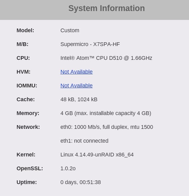

I'm on unraid 6.5.3 and the system is/was usually stable. A week ago, I upgraded from 5.0-rc8a without any problems.
But when I'm trying to preclear a drive or checking parity the system stops responding. I can't reach the webgui nor telnet into the server.
The checking-Parity related issue was also present while using 5.0-rc8a. I thought it has something to do with my RFS-formatted drives becoming full (>90%), because if I redistributed my data throughout the drives parity check worked.
I checked the Smart-Reports of all drives, nothing wrong.
Right now I've disabled the parity drive and added a 8tb drive (xfs). I created a new share exclusive for this drive and copy the data of my other drives onto it (3tb+2tb+2tb).
Any ideas what I should do instead?
server-syslog-20180901-0754.zip

I'd be interested to know how hard your processor is working during those activities when the system becomes unresponsive. With a passmark of 653 it's near the lower end of the scale but it still ought to be adequate. There may be some tweaks that can be done to makes things more responsive.
CPU-Usage is around 30%.
