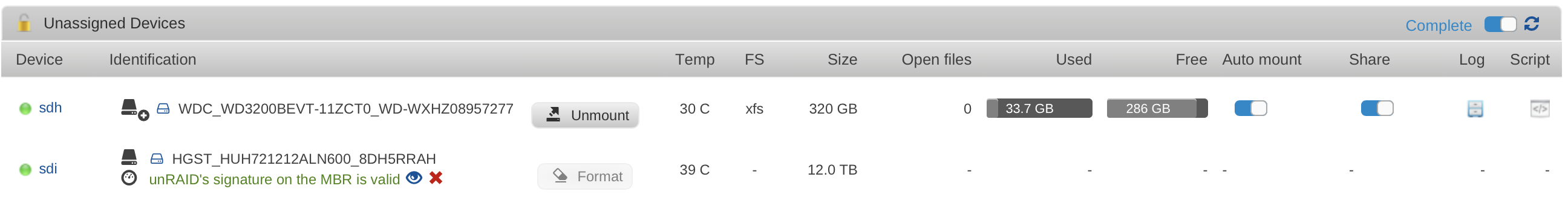

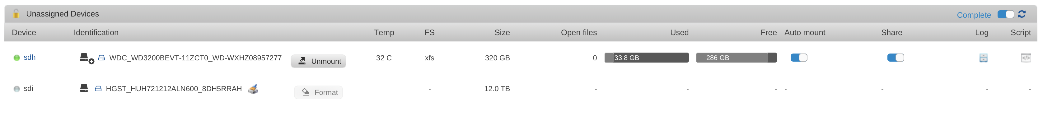

I just realized, when I connect the 12TB HDD the other unattached drive (320gb) is not recognized either.
I connected the extern Inatec USB to the server with the 12TB in it and it shows under unattached devices, but not green and the format button is grey (picture)

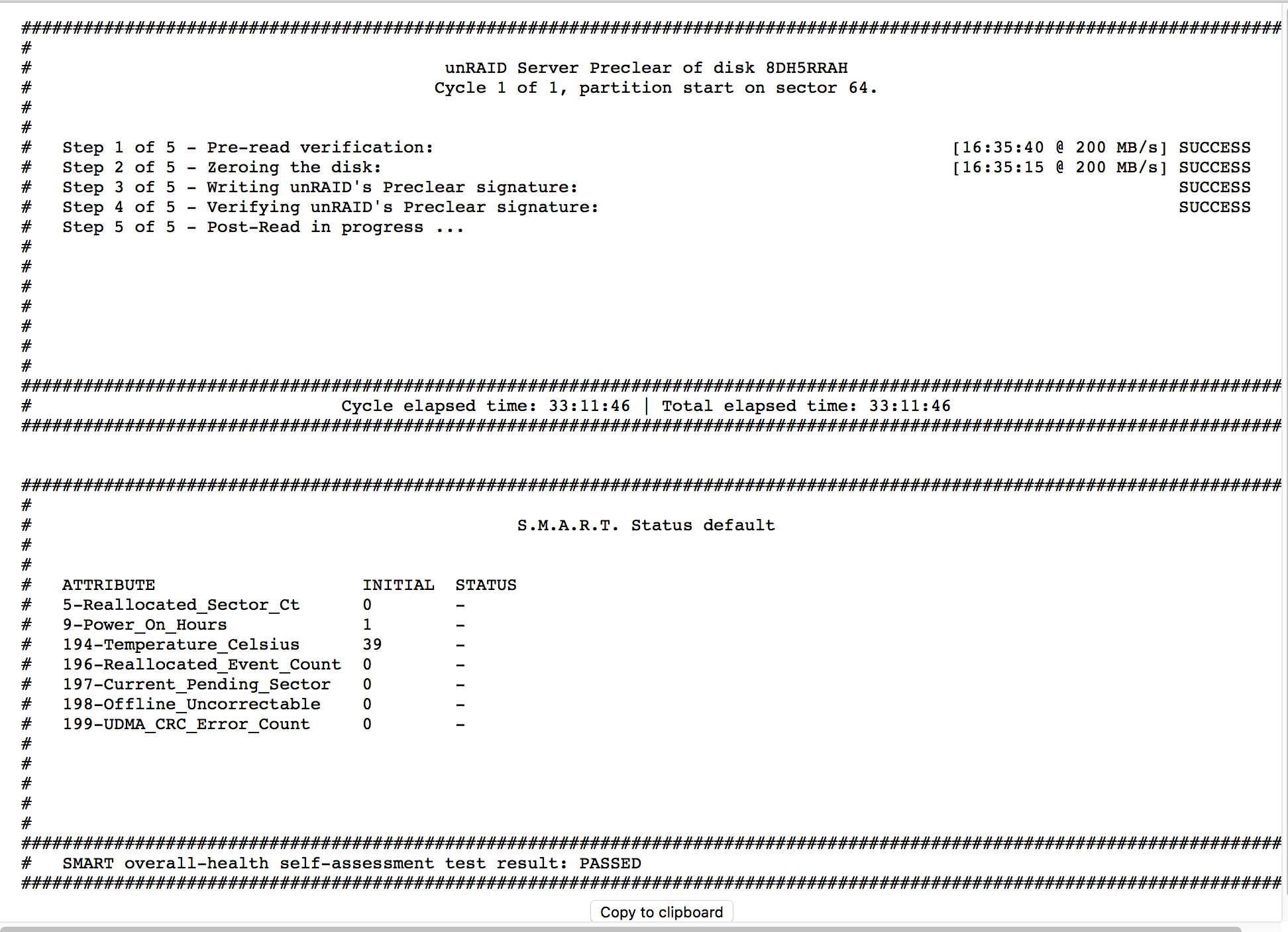

Mhhh. PreClear is almost ready, but now it is stucked. "unRAID's signature on the MBR is valid" and in preview ""Step 5 of 5 - Post-Read in progress ...".
The Elapsed time is "frozen" since about 9 hours and the disk is getting cooler. From 43 to 44°C while writing zeros to 38°C.
How can I see, if preclear is doing something or not?

Yes, it is in the Dock at the moment. LED lighting is constantly on instead of flashing. The drop of temperature also give the signal that it is done, but in preview is no success in Step 5 and it don't show that it is ready?!?
The log looked like I never startet so I decided to end this thing an start it from scratch. I was lucky. PreClear could resume the clearing and is now at 0% of Step 5. I wish I'd known that before than Preclear would be done in a few hours. So it'll take another 13 to 15 hours and I could have saved some time for researching this problem :(
Edited by Marino
PreClear is Done. I've connect the drive to the Intel-Controller and it works immediately. So I can blame the Marvell-Controller.

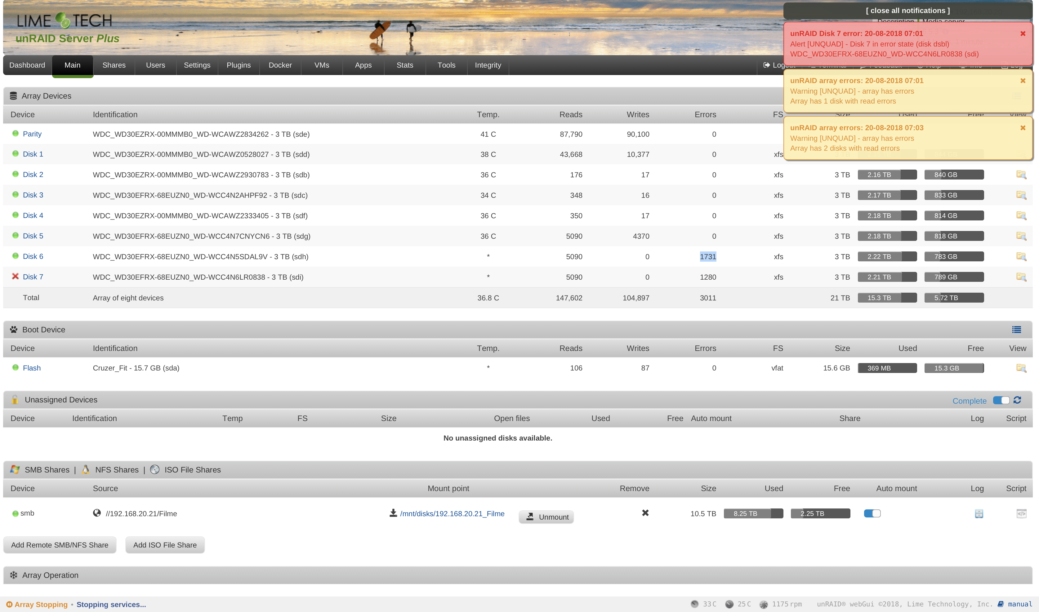

This is my other server. When I am done here, I'll get 3 4TB drives.
Disk7 has to be rebuild.
2 of the 4TB drives should be a dual parity and one is for replacing the Disk7.
Because they're 4TB I have to swap one parity before rebuilding on a 4TB drive.
350155589_Bildschirmfoto2018-08-20um19_18_20.png.8d845268b6e4b7529f04f002a3d36c5e-2.png
