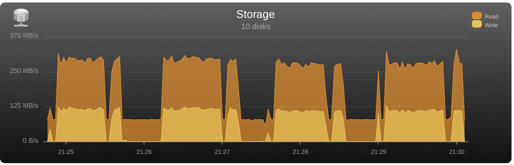

I don't know why, but the speeds are not really normal in my opinion. Copying Files which are 20 gigs and greater.

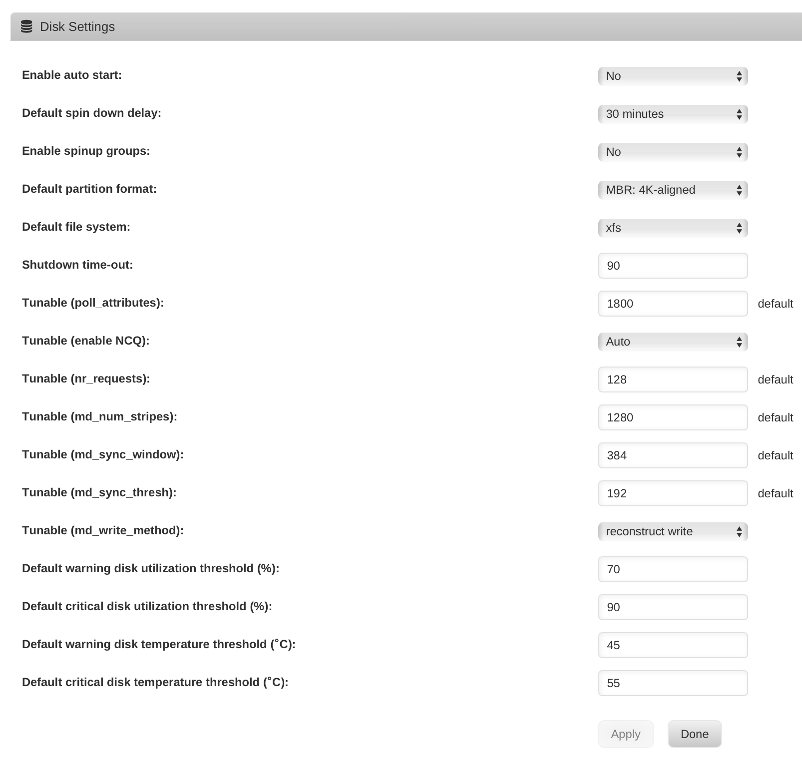

Go to "disk settings", change "Tunable (md_write_method)" to reconstruct write.
Edited by Benson
It is on reconstruct write already. I thought this would be better when transferring >9TB

I focus on why some period was read only without write.
What actual copy operation doing ? SMB transfer file to array ? Array local to local ?
If SMB transfer, what actual speed you got ?

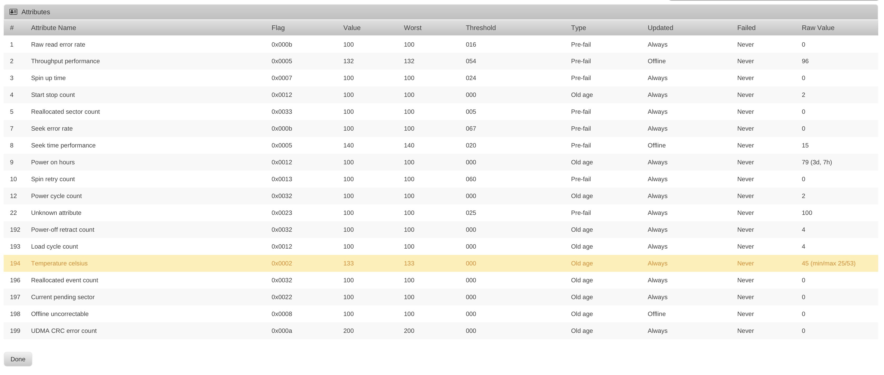

And another strange thing. The disk I not copy at the moment shows some strange thing. The temperature is shown yellow. But it is at 45°C and it is not written on in hours. Suddenly there is a value at maximum temperature of 53°C. But the disk has never reached that temperature. And it is showing up now without change on something?

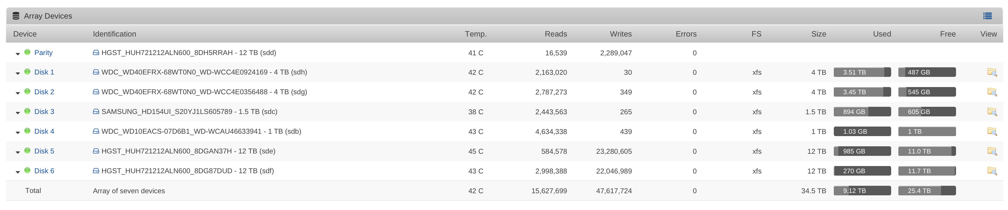

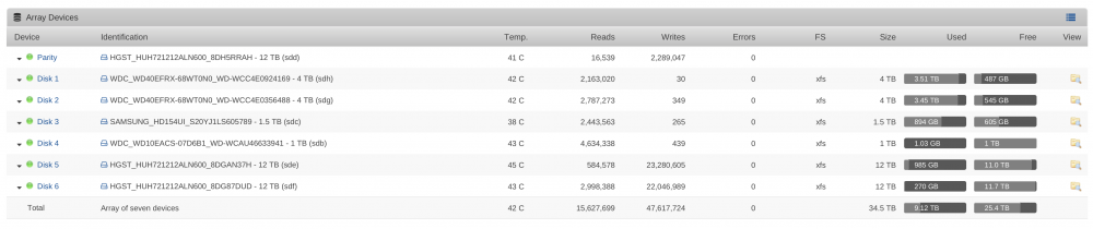

The second picture shows my actual config. I am copying from disk3 to disk6 and the temperature picture is from disk5
The disk at the time you grabbed the picture IS at 45C according to its own SMART report  (personally, this is hotter than I like).  And it HAS hit 53C.  The yellow triangle's threshold for temperature is configurable via disk settings (disk temperature threshold), or individually per disk.

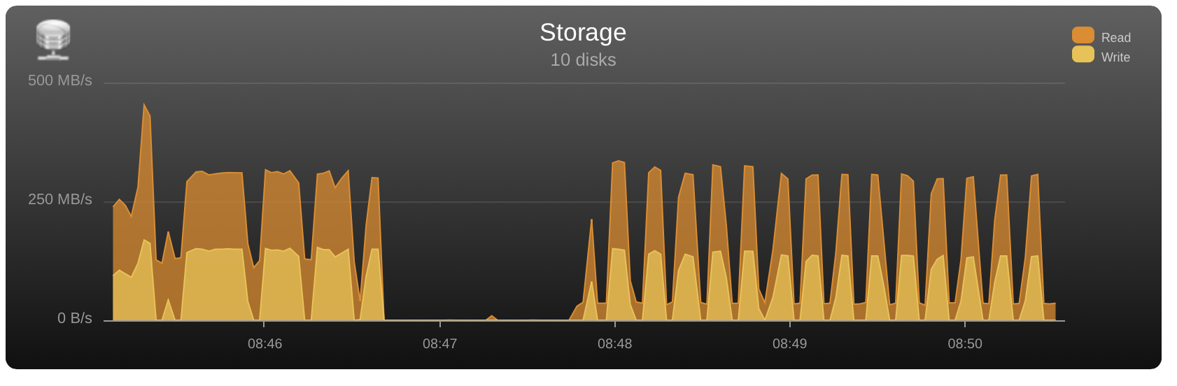

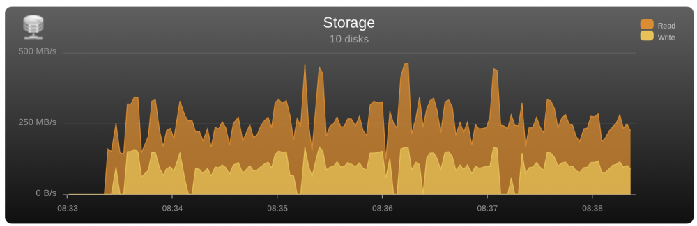

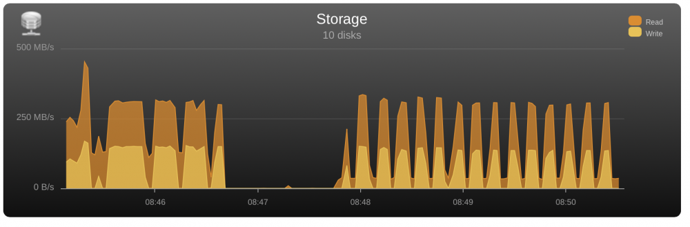

Today I could test to write data from intern disk to intern, without the usb dock.
Dhe first half is the copy of one 16gb file to the one hgst and the next half is the copy to the other hgst disk. So it is with both of them.
But, when I hear the writing head and see in this diagramm that there is much going on, the speed in krusader is about 20-25MB/s (I counted 3-4 seconds for 0,1gb). When this pause is happens (in diagram and with writing head quit) it copys 0,1gb in under a second. Thats confusing me a little.

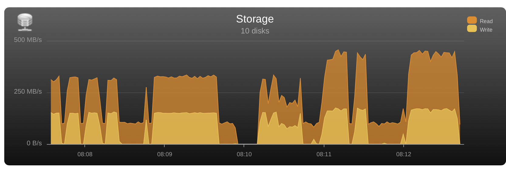

And as I wrote yersterday, I started an extended SMART test. All disks are at 90%, expect of one, which was not used since start and is only at 30%. I started the test about 9 hours ago or so. So it would take 30 hours in these disk. The other disks are needing about 10 hours, which I was expecting.

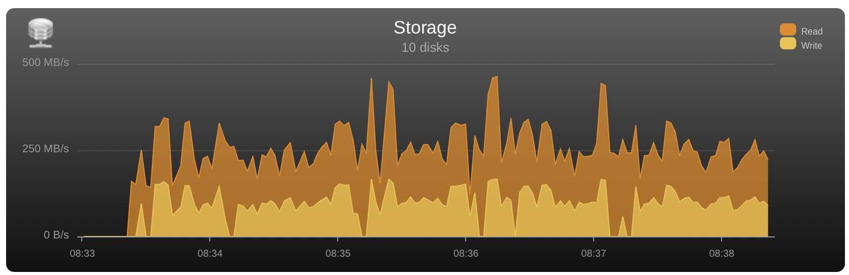

This is copying on more disks. One lagre File from disk1 to disk5 and one large file from disk2 to disk6. MC shows on one of them about 10-20MB/s and the other (first one) 40-50MB/s.
