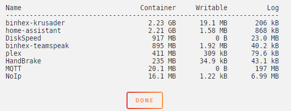

I just had the same issue. I stopped the docker, changed the docket storage size from 20GB to 40GB and restarted it.
Everything worked at that point and the error is gone.
Is there any way to find out what actually caused this problem?
Is there a way to find out what is taking up all the storage?
When check the container size now it shows that there should not have been a space problem.
I most recently installed the MQTT and Home Assistant dockers around three weeks ago.
