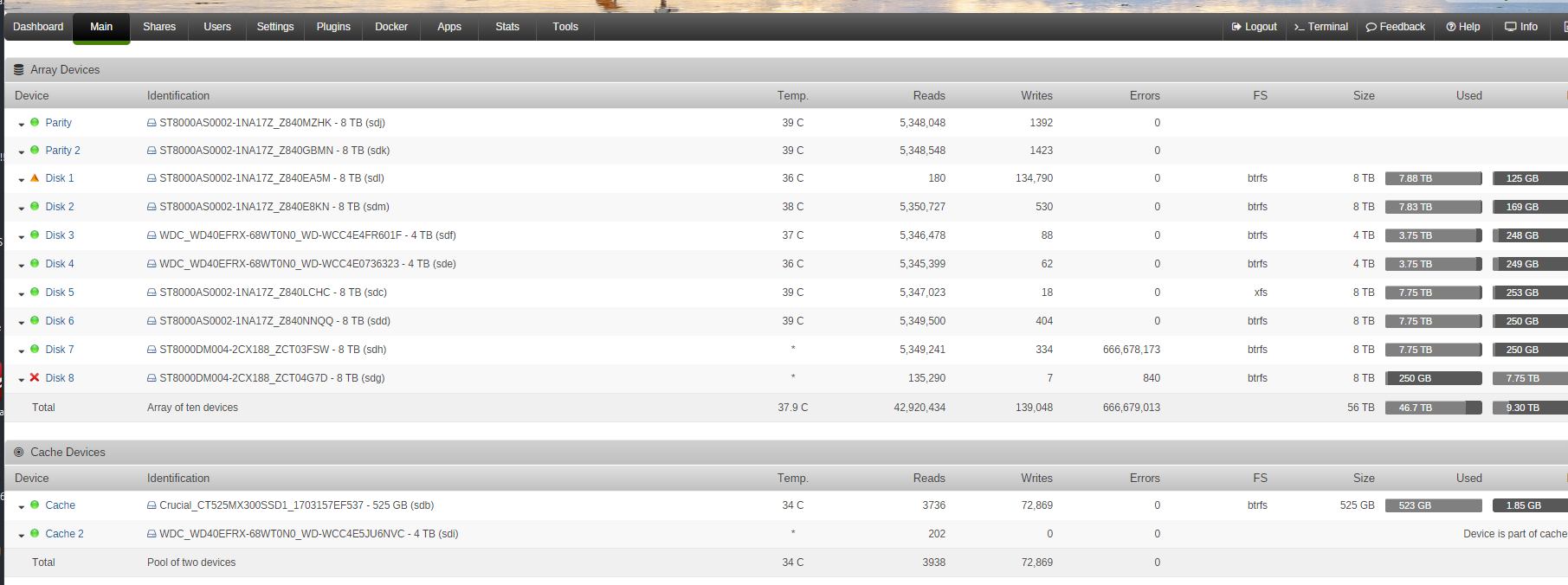

I also now see another drive is reporting problems. This has got to be cable or controller related... right? (Even if that's the case, I'm not sure what I can cancel/shut down without making anything worse.)
Edited by Karyudo
Even to my untrained eye, this does NOT look right. 600,000,000+ errors?!
Since you have dual parity you should be able to rebuild disk1 and disk8 after you get your hardware problems taken care of. Check ALL disk connections, SATA and power, both ends.

My first issue is, should I cancel the current parity operation (it seems to be stalled at 13-something hours remaining, with errors climbing)? Seems like the answer is "yes," but I've seen other threads where people have done what seemed logical, only to be told, "you should have done X before cancelling."

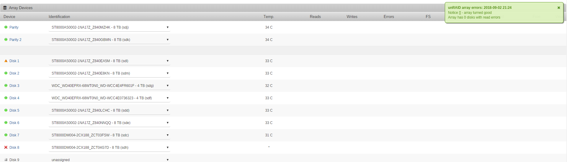

I did miss your edit; thanks for the additional post. I was already going to reseat the one PCI-E controller card I'm using, anyway, since I can feel it's running a bit hot. I'm also going to check which drives are on the card. If it's Disks 1, 7, and 8, then I think I know what the problem might be....
Reseated card; checked connections. Everything looks OK (but of course it looked OK before, too...).
BTW, Disks 7 and 8 were on the PCI-E controller card; Disk 1 was on a mobo SATA port.

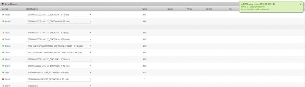

Disk1 is invalid because the rebuild wasn't completed. Disk8 is disabled because a rebuild hasn't started on it yet. SMART for both disks looks OK. Since you have dual parity, both disks contents are emulated and they can both be rebuilt. Starting the array now should begin rebuild with the current disk assignments.
If you have spare disks you could also use those for rebuild and keep the originals in reserve in case there is a problem.

Starting array will begin both rebuilds. Disk8 will go from disabled (red x) to invalid (yellow triangle like disk1) until rebuild is complete. If rebuild completes both disk will become green.

Unassign both disks then start the array so you can copy the emulated data before beginning the rebuild.

If you unassign disk1 and disk8, then you should be able to start the array and read from the emulated disks before rebuilding. Then you can copy the emulated data. Then assign the new disks and start to rebuild.
