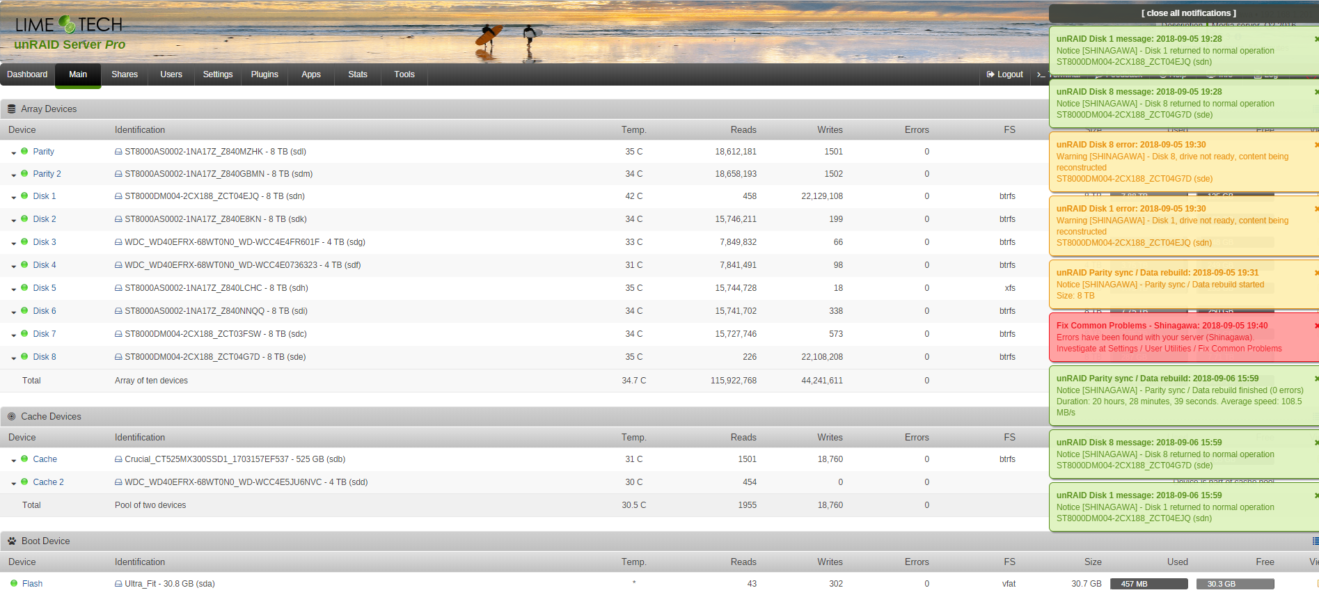

The rebuild has completed successfully. Thank you, John_M and trurl! I appreciate your patience and education.
I used SATA ports only on the mobo and ASM1061 controllers. I re-used Disk 8 as Disk 8, and a newly-shucked drive for Disk 1. The original Disk 1 is in Unassigned Devices. In the end, I didn't mess with pulling the 4TB drive out of the cache pool. Yet—that's coming up shortly.
