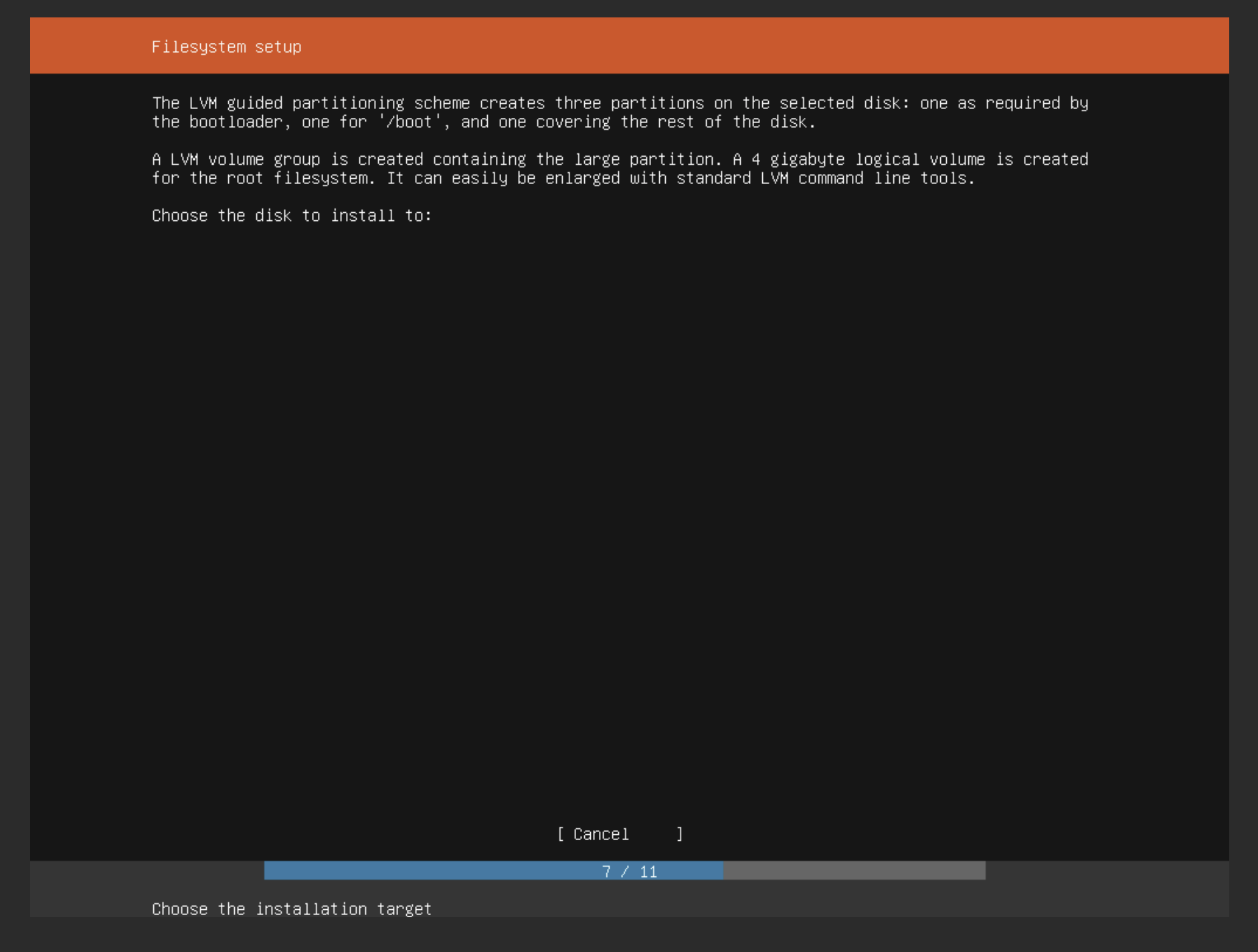

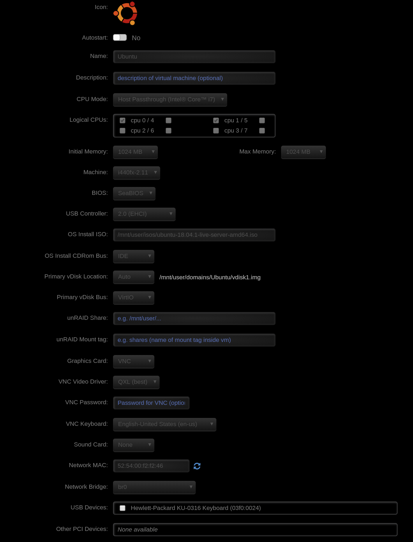

September 3, 20188 yr Hi Guys I cant seem to figure this out. Im very new to unraid and I have read through the help. I have an old machine using a Gigabyte GA-EX58-UD3R motherboard and in i7920. I am unable to turn on IOMMU When I boot ubuntu it works fine until install where it needs a drive. It cant see the drive. These are my settings for the VM below. But I have tried tons of variations. Can anyone help me here? I have virtulization on and I know this machine can run vms because I have used both hyper v and virtualbox in windows and virtualbox in Ubuntu server before moving to unraid.
September 3, 20188 yr Author I have also tried putting the VM in another location and still cant see the disk. I have also tried the qcow2 vdisk

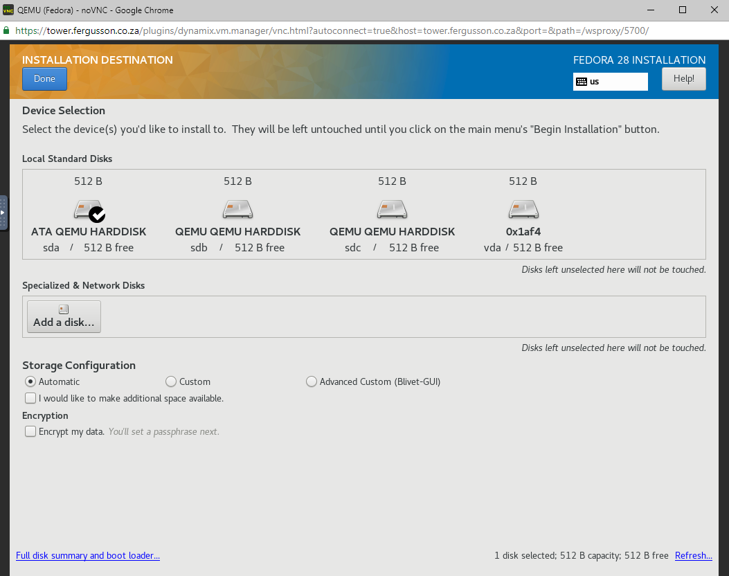

September 4, 20188 yr Author So I tried the installer with Fedora and added a bunch of different drives all with different configurations. It looks like they show up but they only have 512bytes free on them. Anyone know why and how to fix this?
September 4, 20188 yr Author Im a complete idiot. This is because I put a number but not a G for gigabyte in the disk size.
