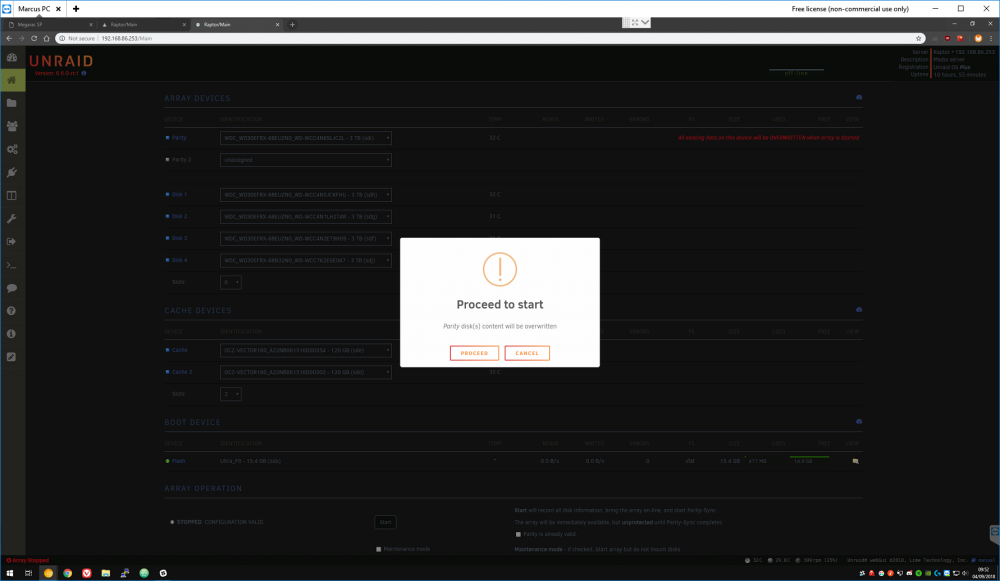

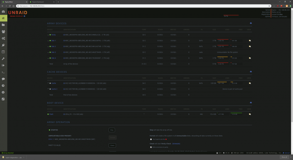

ok cool, I'll untick parity valid then?

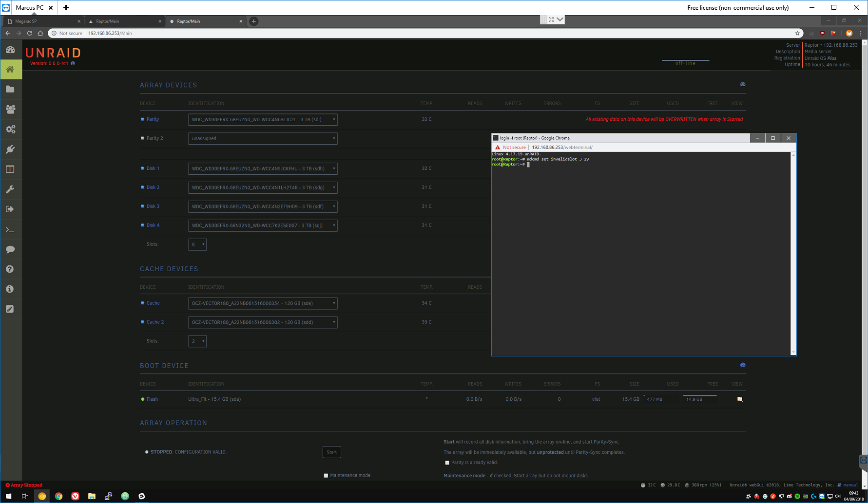

I've run the invalid slot command and not hit refresh.

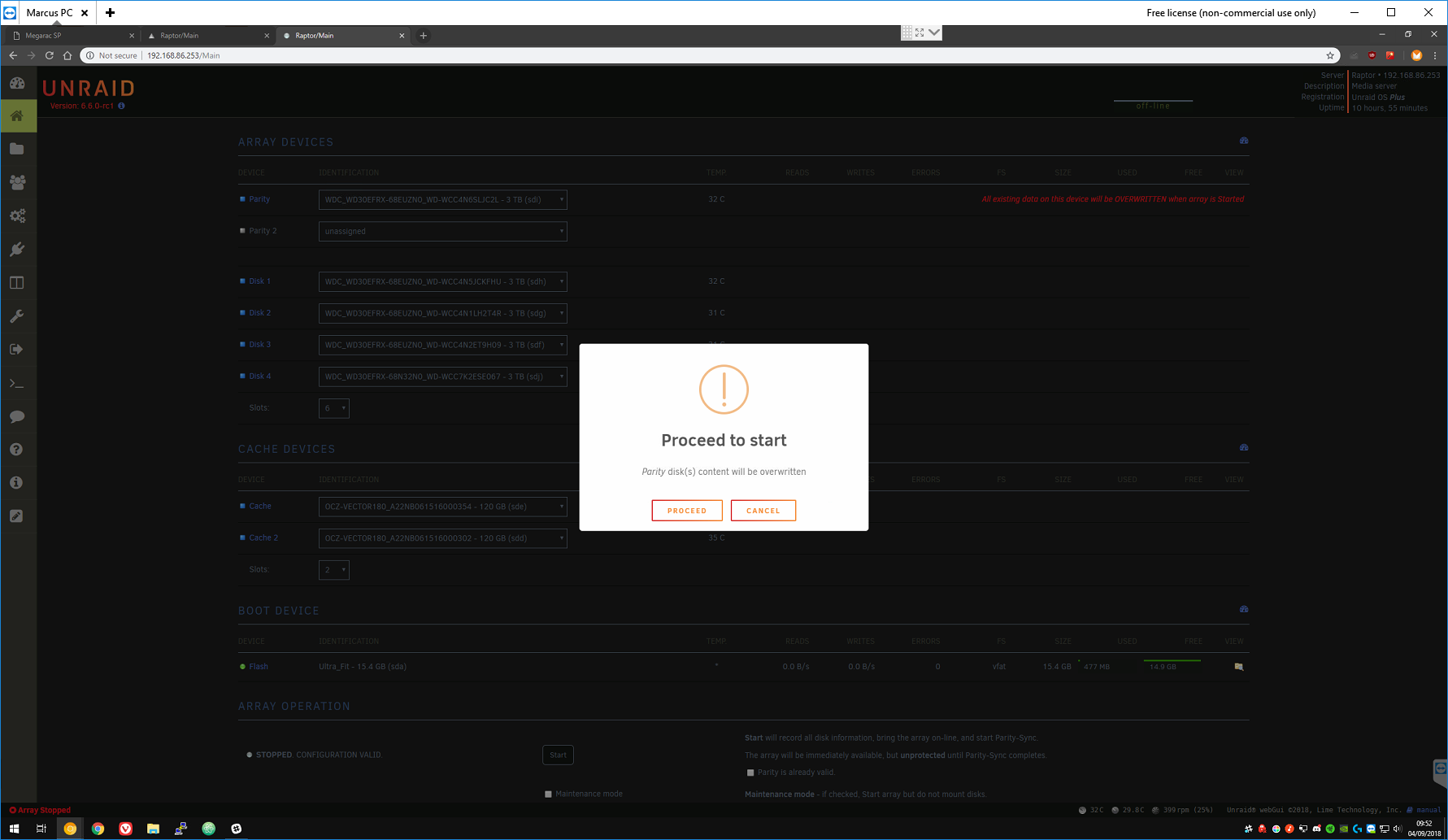

Time to start the array?
@johnnie.black
Safe to ignore the red warning and hit start then? Then just cross my fingers that it'll still begin a rebuild in 6.6 :)
Just after a final confirmation before I do anything I'm not supposed to haha - hopefully it'll all be over and done with soon and I can stop bugging everyone ;)
Yes, and it has to be done before running the invalid slot command, after running the command you can only press the start button, nothing else.
Am I safe to re-run the invalid command now that the button is unticked?
Yes

Proceed

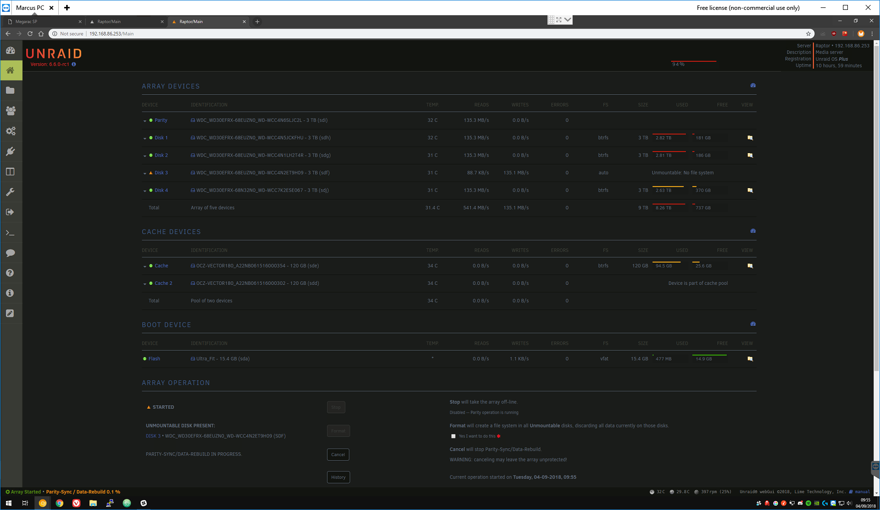

It would be better if the disk mounted, but hopefully it's fixable or at least recoverable, grab and post new diags so I can see the mount error.
There's metadata corruption on disk3, this results from you having mounted the disks before without parity, so the transactions generations don't match, after the rebuild is finished see this thread, you should be able to use btrfs restore to recover the data but the disk will likely need to be reformatted after, since that error is usually fatal with btrfs.

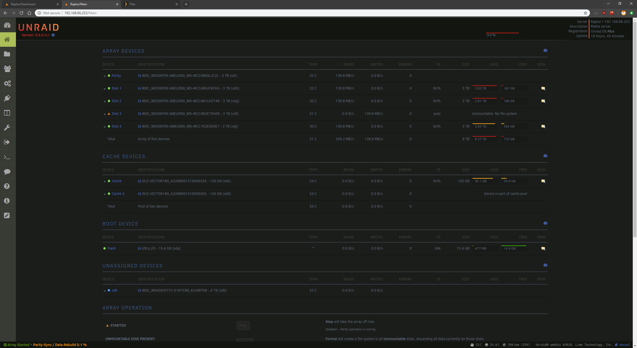

(42% restored so far, yay) :)

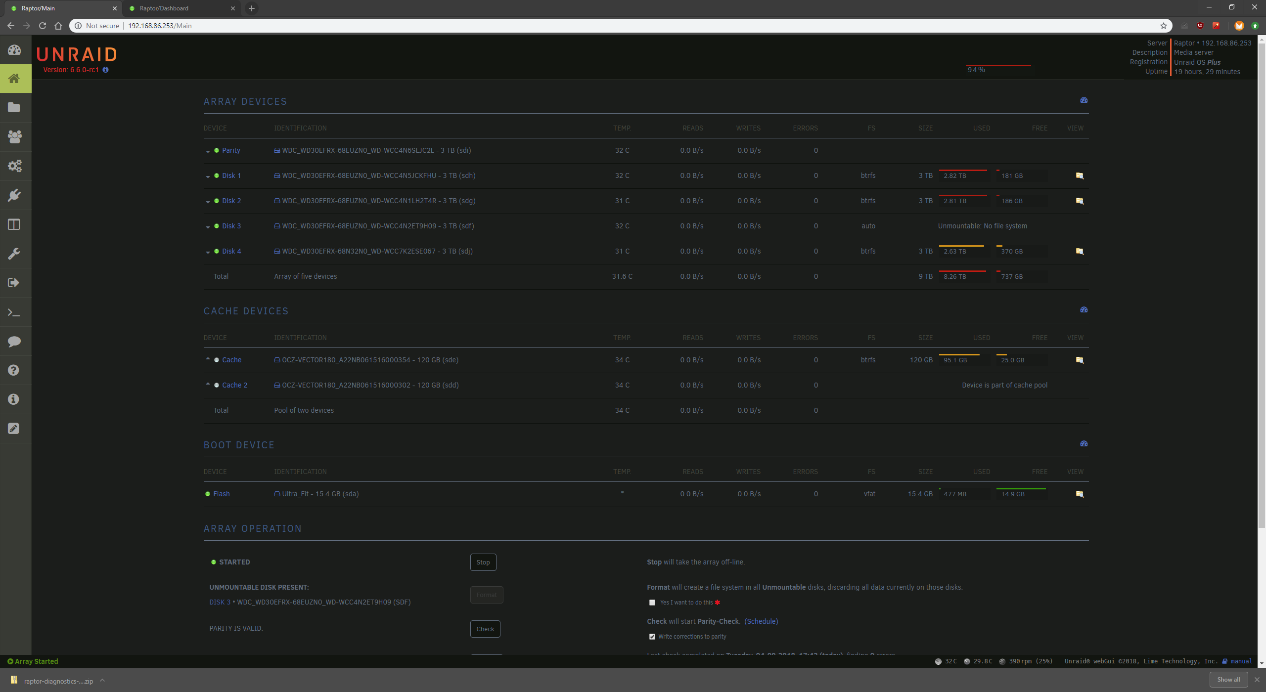

The data rebuild 'completed' ... I don't know if it has worked? Orrrr...
There's no emulated storage or anything, thought there would be? Have I misunderstood ;)
EDIT:
Sorry, I have to stop the array and unassign the disk first... My bad
