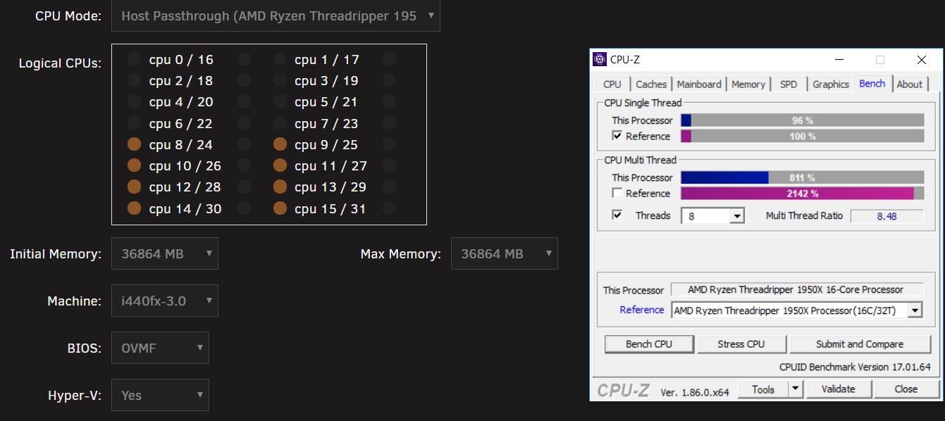

September 6, 20188 yr Now on the second configuration I saw the Single Thread Predecessor score have several values, low-end 86% high-end 94%. Listed OS is incorrect, Windows 10 build 1803. Full system specs are in the URL of my sig,

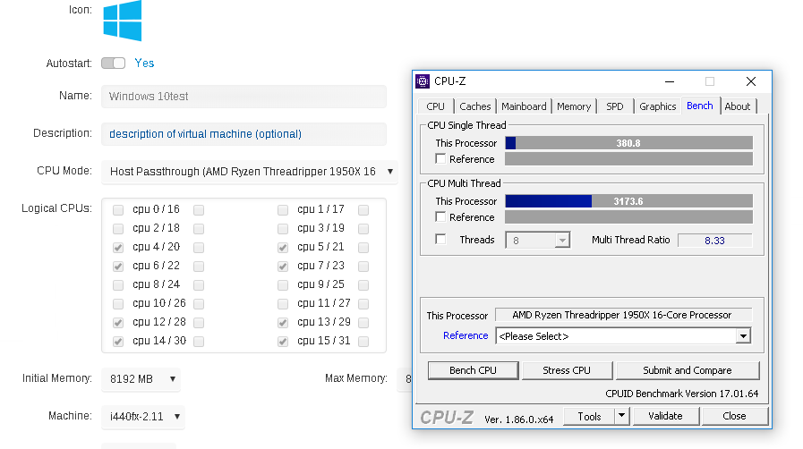

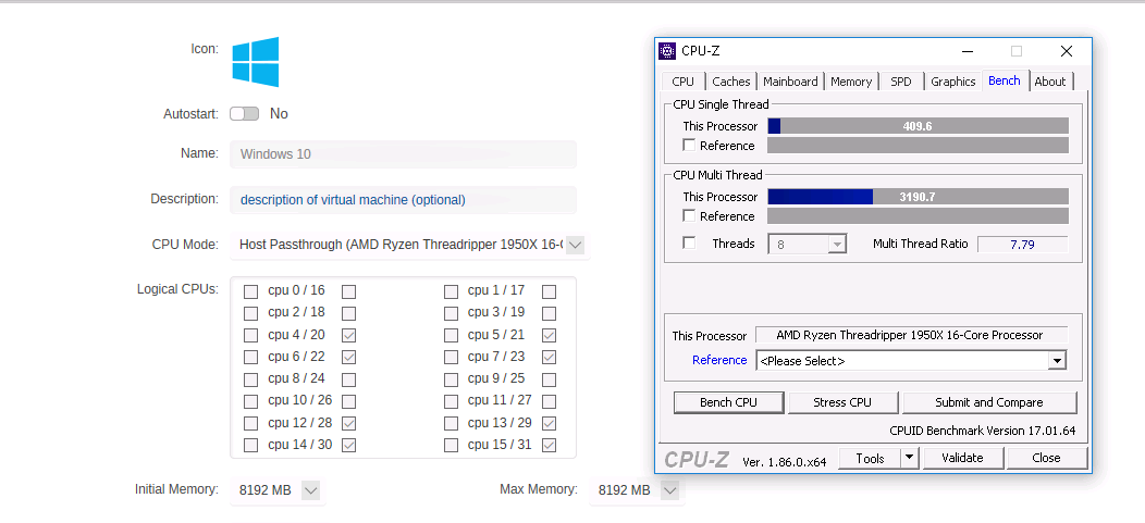

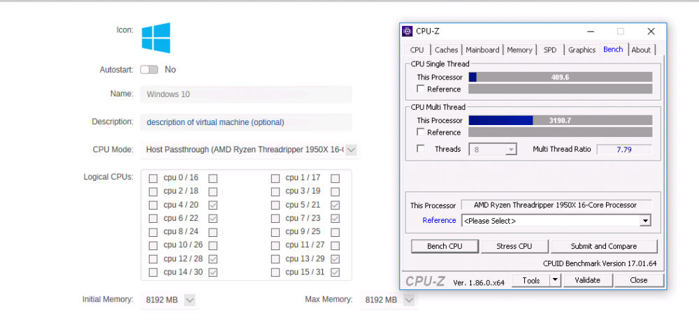

September 14, 20188 yr Author Just as a follow up, I got the 1950X, I get a few oddities with my original VM. I swap the core assignments and I get the same results (380ish on the old install and 410ish on the new install) I have a few NVME drives on the way that will hold the VM's so I will reinstall and try from there. EDIT: Changed the windows power plan settings from High Performance to Balanced and now it's up to 409-410. Change it back to High Performance and it goes back to 380... Odd. Windows 10 Install that was carried over from the E5 Fresh Windows 10 install Edited September 14, 20188 yr by TType85

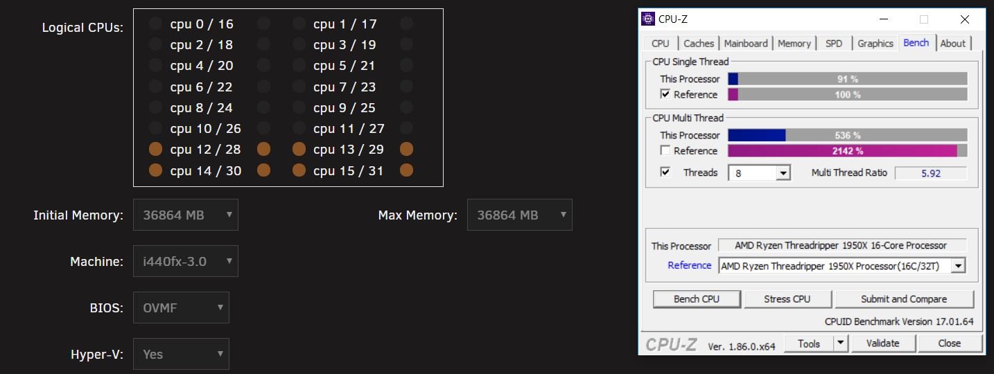

September 15, 20188 yr Based on the findings in another thread, it looks like your utilising the physical and SMT threads from opposing cores. Try allocating in "columns" instead of across and see if that helps. On 8/25/2018 at 8:58 PM, bastl said: I'm hoping to finish setting up my gaming VM this weekend, so I'll try and get you some benchmarks.
September 15, 20188 yr Author I would think 4-7, 12-15 would be on the same die and 20-23, 28-31 on the other die according to that diagram. I updated it 8-15 on one VM, 16-31 on the 2nd. The old install (16 vcpu) still gives me a bit lower performance scores than the new install (8 vcpu).

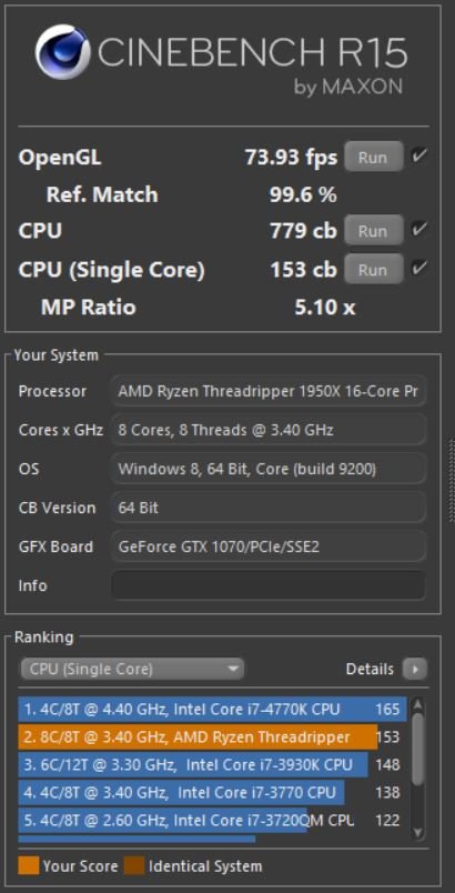

September 15, 20188 yr Hey guys, that picture from the other thread where my initial guesses what the core pairings should be shown by unraid after i did a couple benchmarks. Later in the thread i corrected myself. The cores 0-7 and 16-23 are on one die and the bottom half and the second die. In the case you're using cores from 2 dies you automatically using the memory channels from both dies and the bandwith is higher in that case. But you add a bit of latency to it. That also affected my Cinebench scores. You should also check how your memory interleaving is setup in the BIOS. That also affected my scores. Maybe you have a look into the thread where i posted all my testings. Edit: I did a quick single core bench on my current Win10 gaming VM with assigned cores 8-15 and 24-31 i never did before. I guess Cinebench should only use one core in that case, right? The load jumps from core to core during the bench. Weird Edited September 15, 20188 yr by bastl
