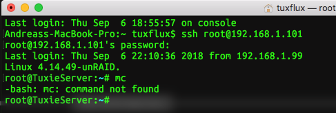

I'm currently re-arranging my shares and I've created a new share and copying files across. I'm currently just doing it via the command line, but I'd like to have some sort of gui. I know Midnight Commander well enough, and I know it's supposed to be included with Unraid 6, but when I type mc into the terminal, I get a prompt saying command not found.
What's up and how can I get it working?
mc is definitely included with unRAID.  I think you must have mistyped the command (perhaps incorrect case?)
All lower case. To make sure, I've tried all other variations as well.
No idea then - it definitely works for me!
