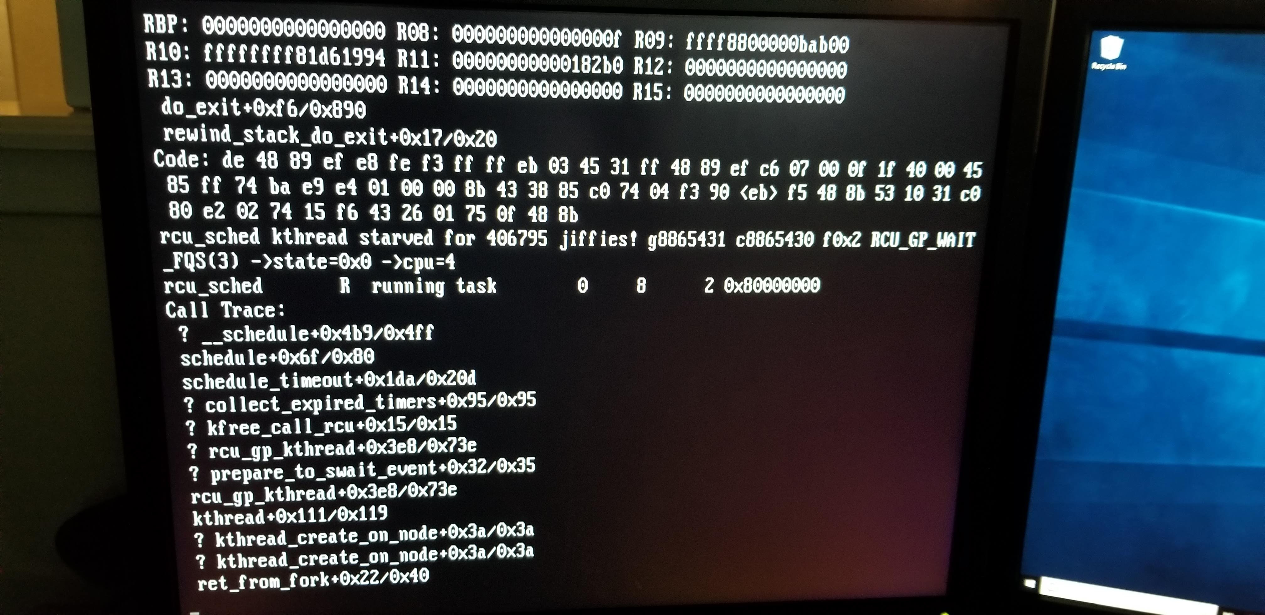

This afternoon my unRAID server became unresponsive and I had to do an unclean shutdown. Before I did I was able to get to the console and take a picture of it. After the reboot I open the gui, the array is stopped and all drives are showing up unassigned. No idea what is going on here, can somebody help me out? Error log post unclean shutdown and picture of the console of before I shut it down attached.

Can't read super.dat (your disk assignments). Probably flash corruption. Put it in your PC and let it checkdisk. Also see if you can read the file config/DISK_ASSIGNMENTS.txt
