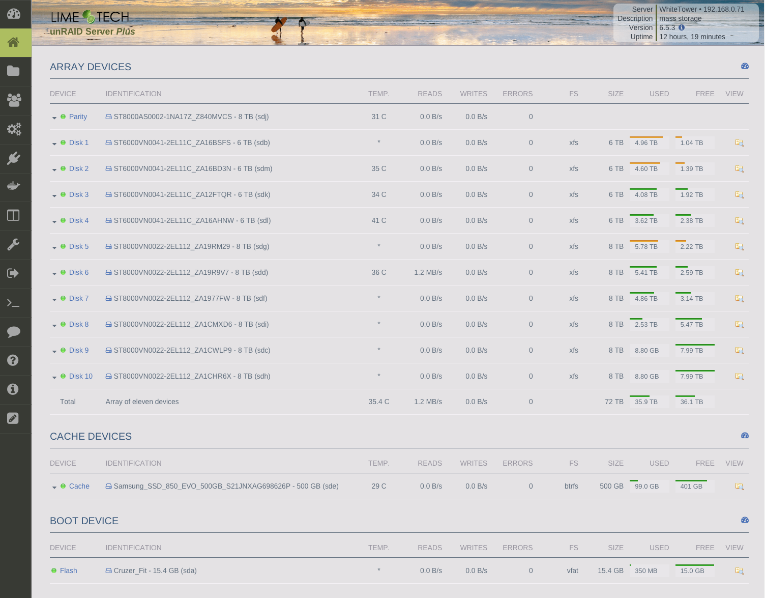

Cache has been disabled, as I will move TBs of data and the cache is only a 500GB SSD.
1857768085_ScreenShot2018-09-10at17_24_38.thumb.png.2ebfaad3a3df76fa5d152f92ef432b2e.png

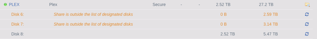

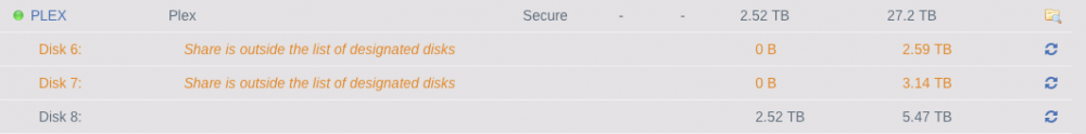

It looks like this:
108450399_ScreenShot2018-09-10at17_35_37.thumb.png.3c9acfe71fa3c27ed01c637f241909cb.png
And thank you for your fast answers, strangely I cannot get in front of the first quote. Hmm.
Edited by WhiteTowerBlackNode
Problem is that the share exists on disks 6 and 7, so they are used for the total space, delete that folder on those disks.
Exactly that is what the mesaage "Share is outside the list of designated disks" indicates. The share is present on disks which are not defined in your include or exclude rules

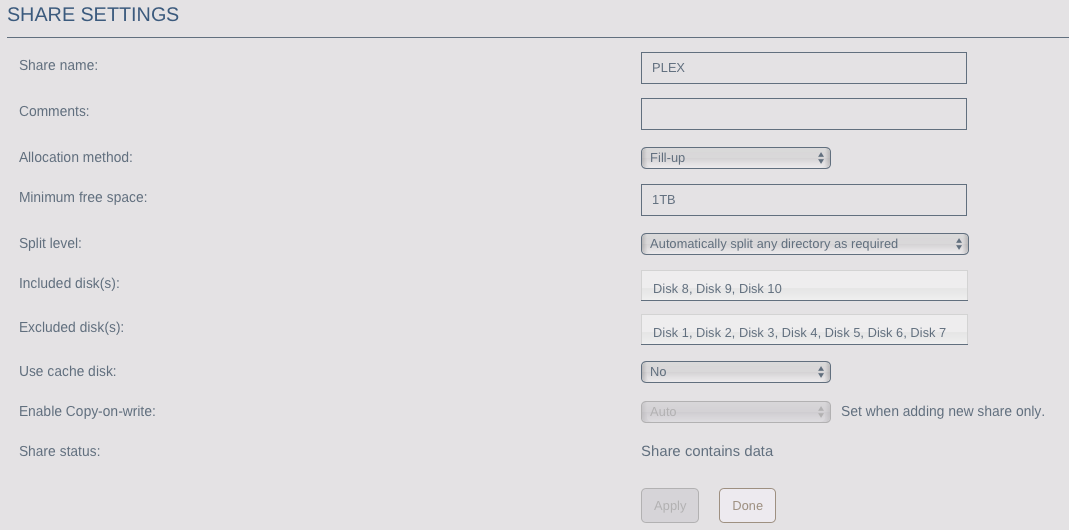

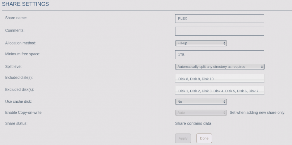

1441005569_ScreenShot2018-09-10at17_50_04.thumb.png.e9d5680edcca89659304ed0014c279c7.png
8 minutes ago, WhiteTowerBlackNode said:
I will check again, but I did exclude it according to my memory. It was just yesterday.
Those shares already existed, they will not be (re)moved when changing the exclude rules. You need to do that manually.
Btw it is better to define a single rule only, e.g "Include disk 8,9,10" implies an exclude of all other disks and doesn't need to be defined.
Edited by bonienl

The Plex share does only include disk 8,9,10 and exclude everything else (but if a single rule is better, I will change accordingly). The Entertainment share did only include disks 1 to 7 and I did exclude disks 8 to 10.
