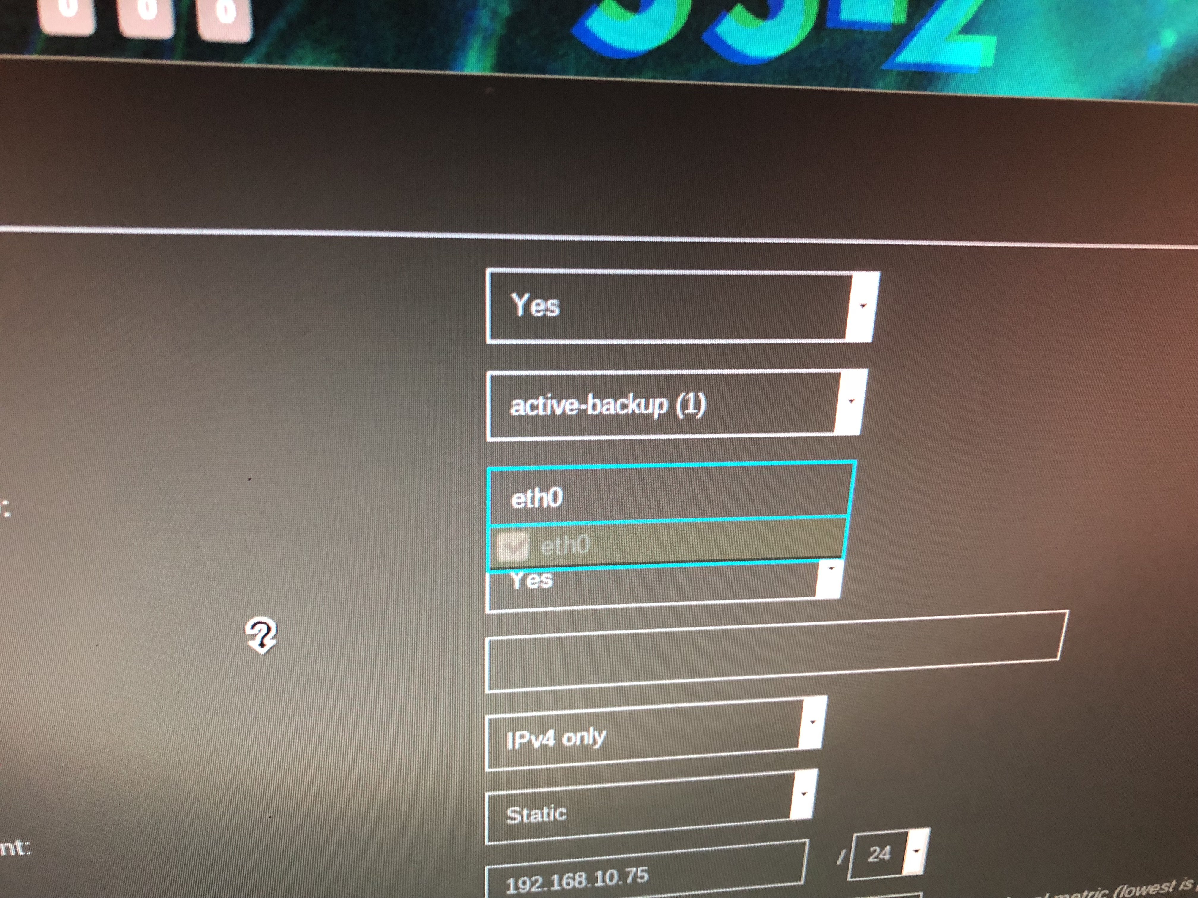

I think now we are good with RAM, how can I confirm this via the console GUI (i.e. viewing system specs)? Also, how can I pull the syslog onto a removable media from the console since I cant remote in due to the networking problem (notated during boot at "Cant find bond0"). Bond0 is what I was using for my network via eth0 and eth1. Now in "network settings" I only see eth0 and not the other 3 eth's. Again I'd love to show you the Syslog, but don't know how to pull it.

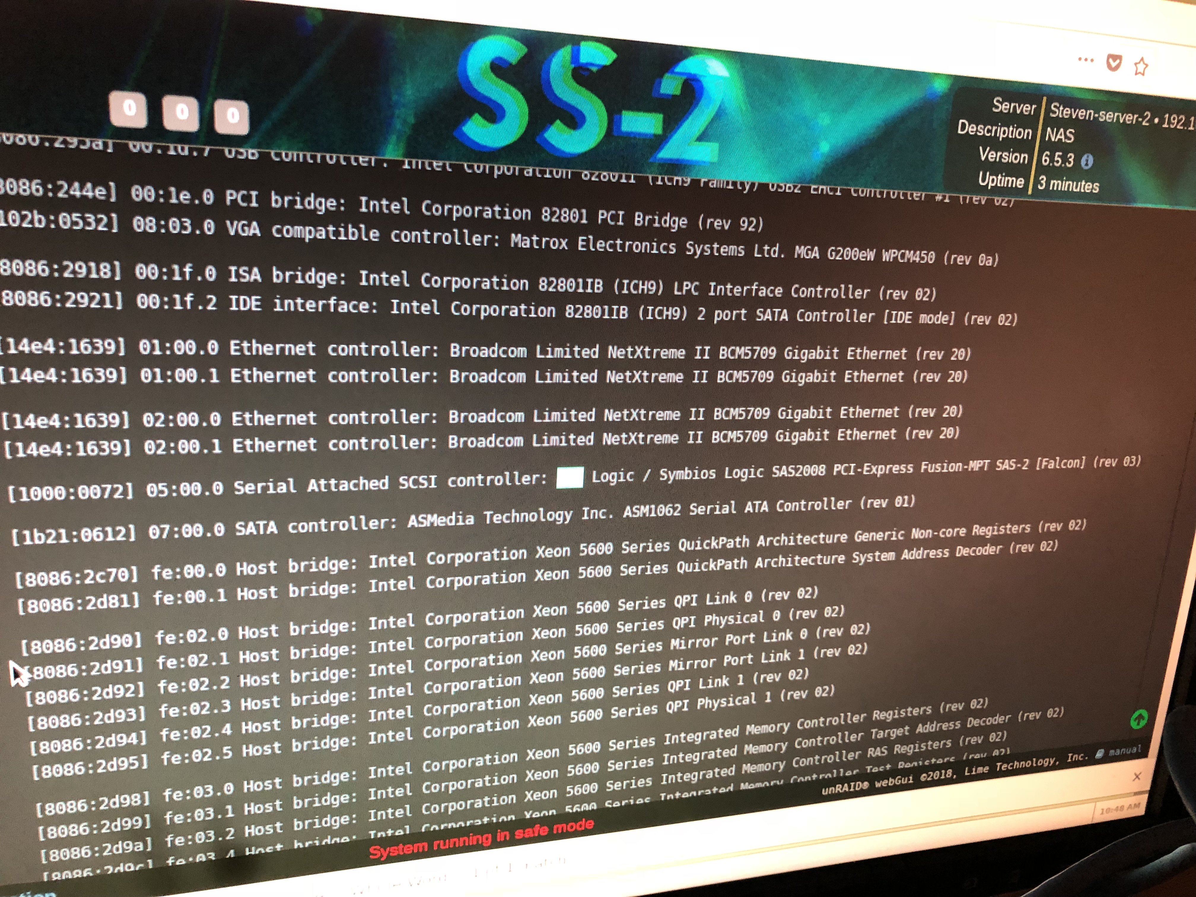

So I do have this:
[1001:0072] 05:00.0 Serial Attached SCSI controller: LSI Logic / Symbios Logic SAS2008 PCI-Express Pusion-MPT [Falcon] (rev 03)
I also see and ATA controller which is what shows on boot in relation to my HDDs
Here are some various photos in the GUI of my problem. Hope it helps.
I have 4 nics connected, the first two of which had been bond0 before. Now I only see eth0 and during bootup after bios, I see "The device bond0 cannot be found".
I believe this to be my controller, even though none of my drives show up.
