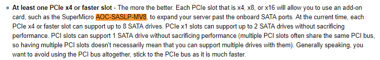

September 12, 20188 yr It appears that your server has a Marvel based hard drive controller installed within it. Some users with Marvel based controllers exhibit random drives dropping offline, recurring parity errors during checks etc. This tends to be exacberated if VT-D / IOMMU is enabled in the BIOS. Generally, LSI based controllers would be preferred over Marvel based controllers because of these issues. Note that these issues are out of Limetech's hands. Depending upon the exact combination of hardware present in your server, you may not have any problems whatsoever. If you have no problems, then this warning can be safely ignored, but future versions of unRaid (and later Kernel versions) may (or may not) present you with the previously mentioned issues. The 'Fix Common Problems' plugin picked the above up after i installed a Supermicro AOC-SASLP-MV8. I havent connected anything to it yet - hoping someone could help with this error as i bought this card for its plug and play reasons. The card was bought from eBay so its possible a firmware flashing may have occured? I've attached the syslog incase that helps at all Edited July 3, 20224 yr by kingy444

September 12, 20188 yr 6 hours ago, kingy444 said: The 'Fix Common Problems' plugin picked the above up after i installed a Supermicro AOC-SASLP-MV8. Since unRAID 6 was released, many users have reported problems with Marvell-chipset-based controllers dropping drives from the array, especially if Vt-d or AMD-V/IOMMU (for virtualization/VMs) are enabled in the BIOS. The chances of that card working without issue are increased if you don't enable virtualization, but, even so, it is best to not have to worry about it. Before unRAID 6, the AOC-SASLP-MV8 was a very popular and recommended HBA. Now the recommendation is to go with an LSI HBA or clones such as the Dell H310 or IBM M1015 cross-flashed to IT mode. The Wiki definitely needs to be updated. There is a lot of old information in many of the unRAID Wikis. Edited September 12, 20188 yr by Hoopster
