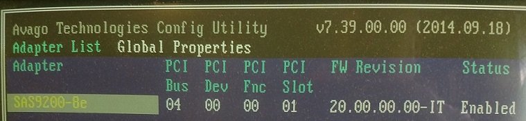

Have a check on what the firmware version is on the LSI card.  I seem to remember seeing it as my server was booting up.  It was only up for a few seconds so you might have to use a camera to actually capture it. It could be that a firmware update might fix the problem.

That's a good point, I forget to check, you're using a firmware with known issues (p20.00.00), though doubt it you cause so many errors, still update to latest (p20.00.07) and see if it makes any difference.

It's on FW 20.  Forgot to mention that.  I did some some posts that said that 20 was an issue for some and to revert back to 19...
20.00.00 and 20.00.04 have issues, the one to use is the latest, 20.00.07
It's on 20.00.00.00-IT.. Also, I had bought a 9211-8i and in the BIOS for the card it's listing it as a SAS9200-8e...  I'm thinking I'm just going to replace it and be done with it.  I don't have a computer here with UEFI BIOS in it in order to reflash it anyway.

I decided to reflash it following a guide I found on youtube.  I'm an IT guy by trade, and have flashed many things over the years, and usually it's not a big deal, but for some reason I had seen on this card that UEFI bios was required and looked like A LOT of work to get it flashed.  Had I had known that it was just a simple flash utility I would have done it sooner lol.

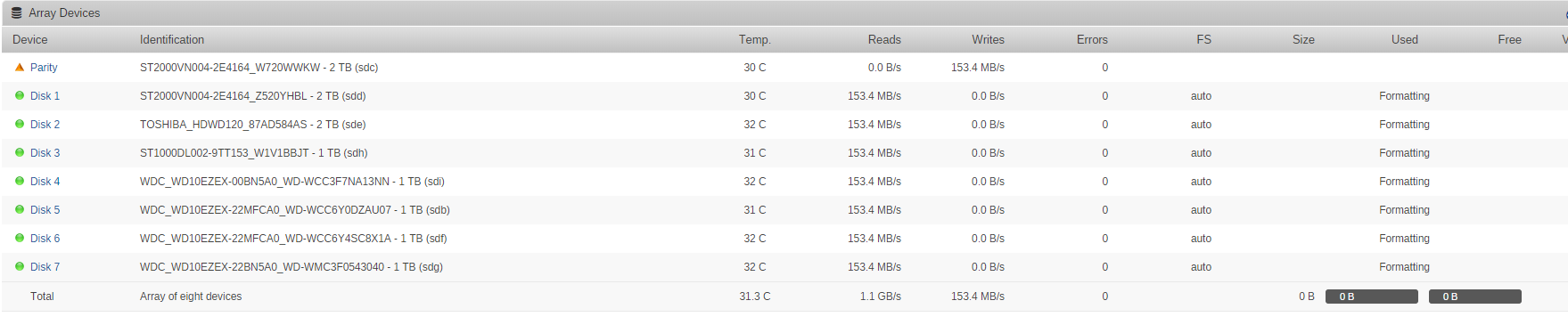

Anyway, upgraded using the 9200-8e FW for the card and it was the 20.00.07 like you suggested.  While flashing, the utility said "Mfg Page 2 Mismatch Detected" and it fixed it on it's own.  After verifying the flash, shut the system down and hooked the cables back up again.  I'm now getting NO ERROR'S!!  And, I'm seeing speeds that I've never seen before.  Guessing that card was messed up all this time.
